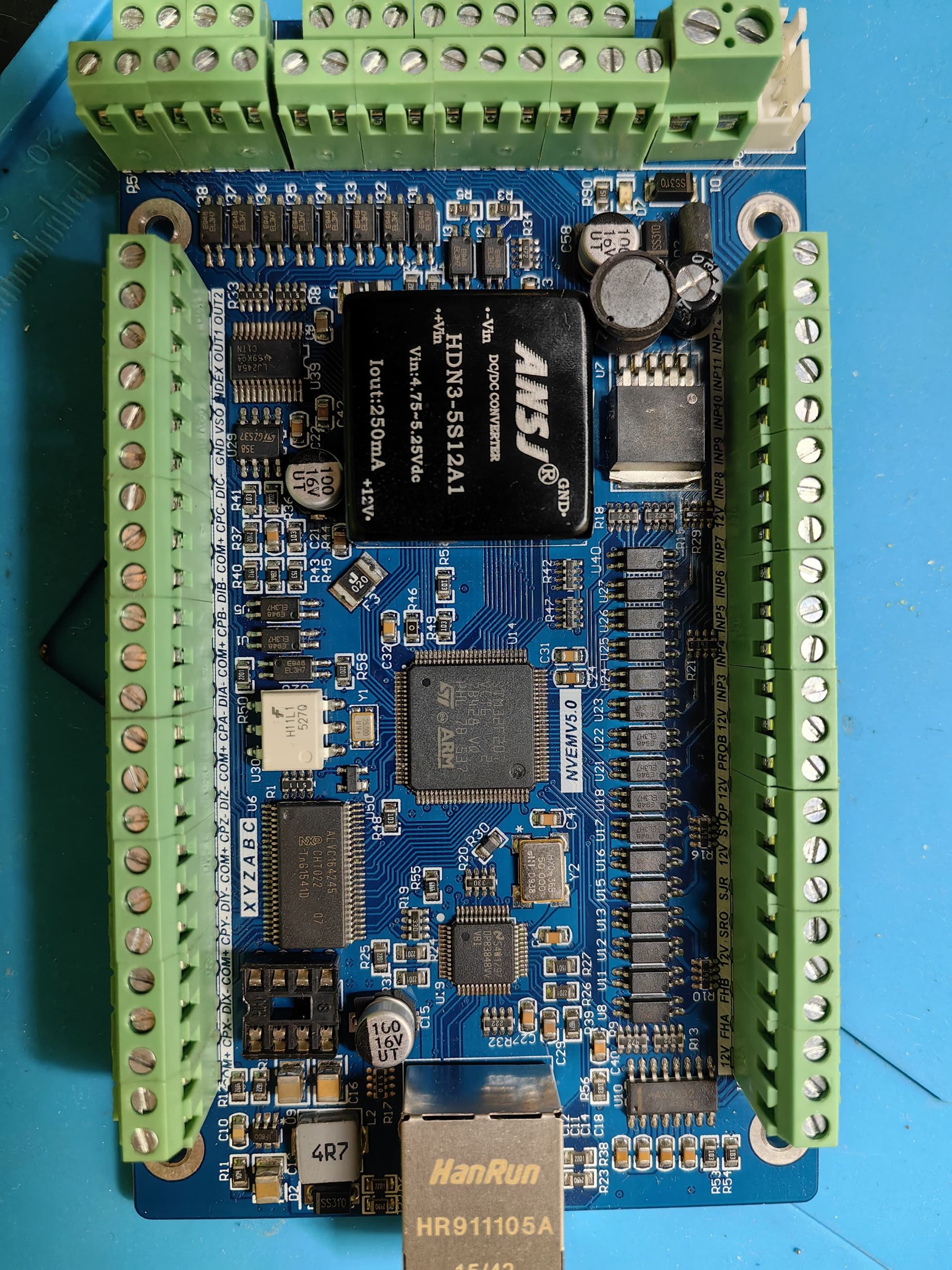

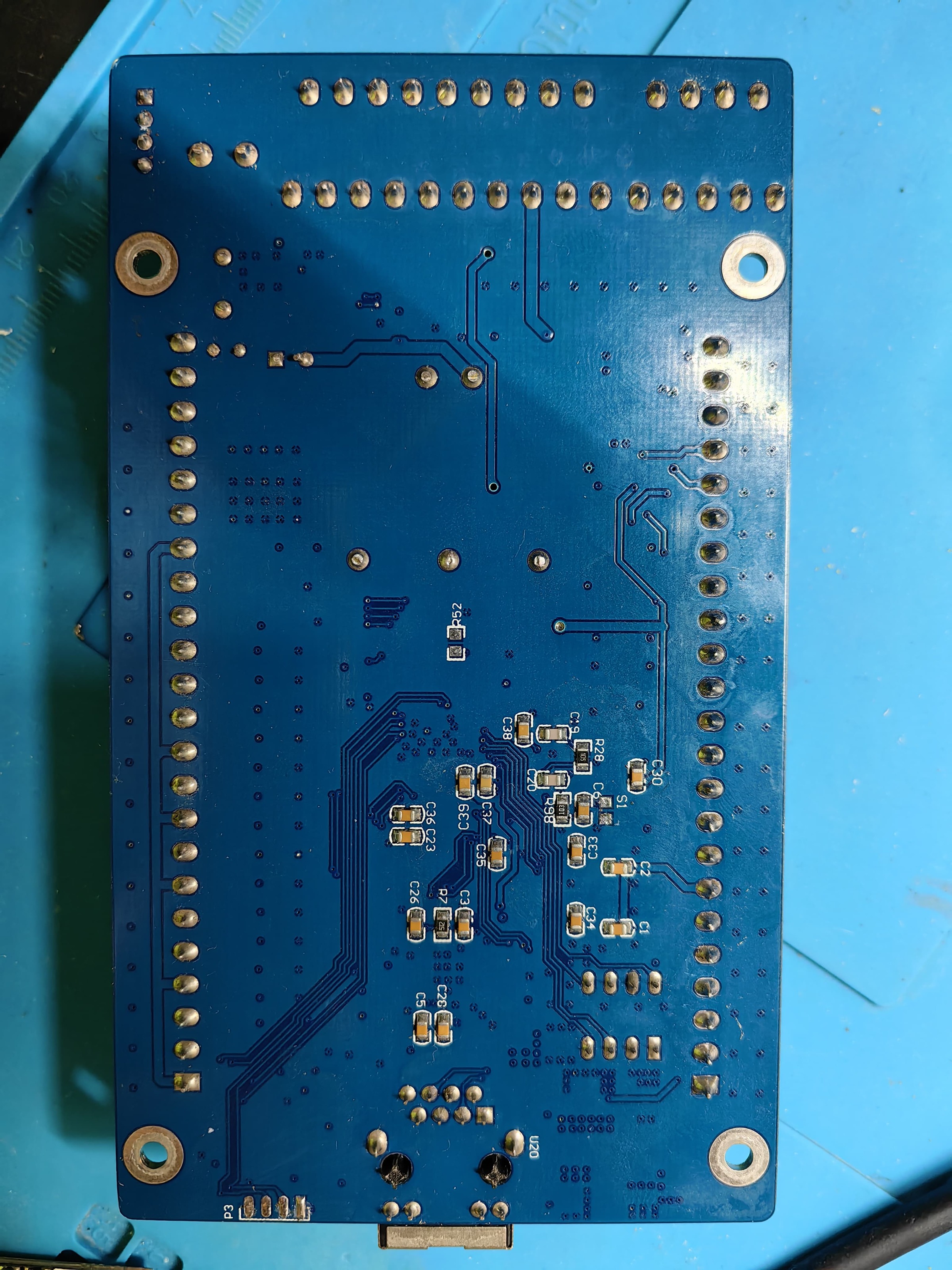

- Lisov_R
- Posts: 13
- Thank you received: 5
12 Dec 2024 19:55 #316543
by Lisov_R
Replied by Lisov_R on topic Remora - ethernet NVEM / EC300 / EC500 cnc board
If it is not clear in my question, then I will say again that I have tried it. Not one of the programs is connected to the STM32, not via SWD, not via UART, not via ST-Link, not via RS232. The board itself is working and works with Mach3. Perhaps all ports are closed in the firmware. Perhaps someone has come across such a thing?
