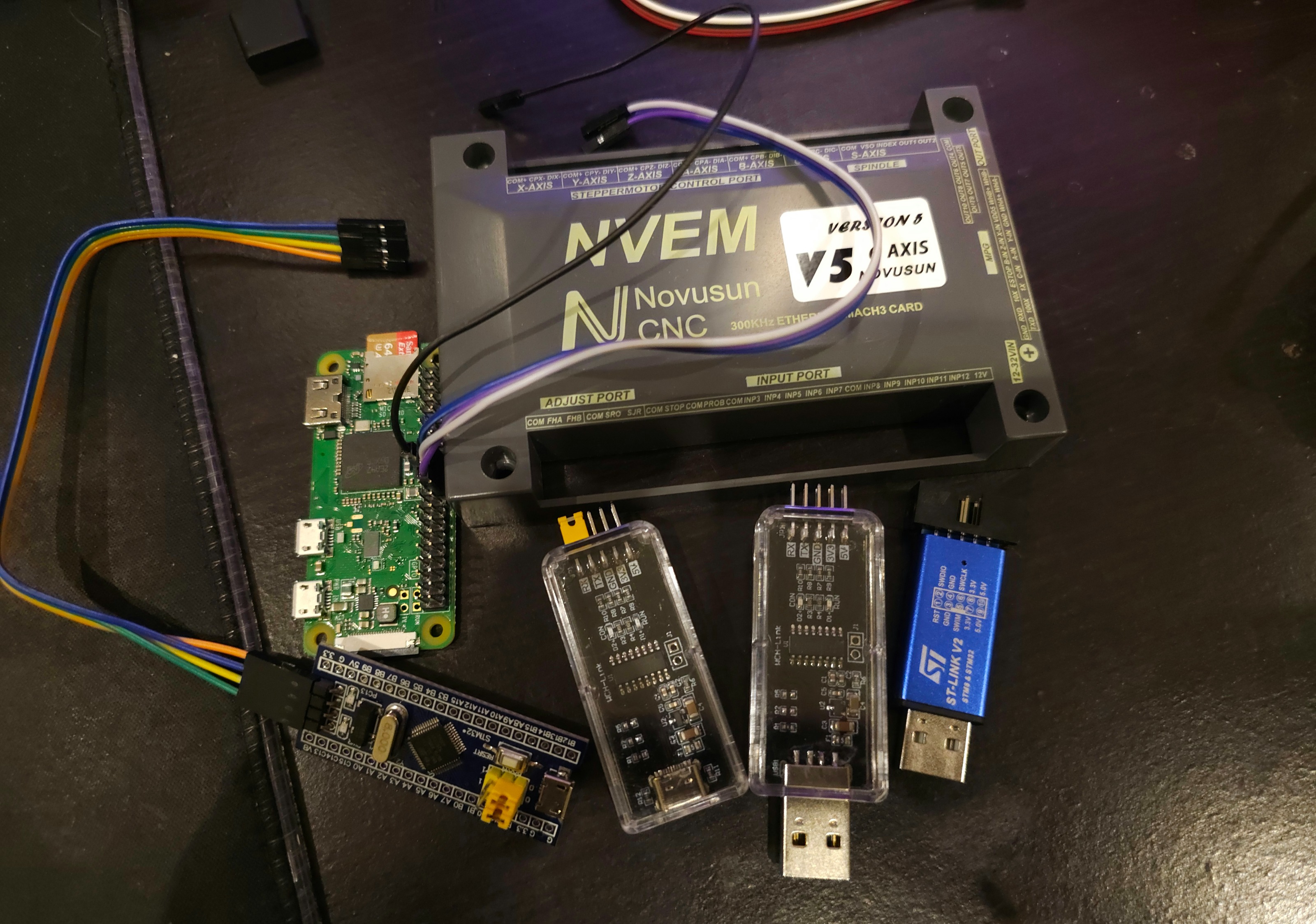

Hi Scott,First, I want to thank you for your incredible work on the Remora firmware!Two weeks ago, I received my NVEM V5 board and started working on flashing it. Unfortunately, I couldn't find my STLink dongle (seems like I lost it), and I couldn't wait for a replacement. So, I decided to get creative and used what I had available. I flashed an STM32F103C8T6 using a Raspberry Pi Zero W with the "CMSIS-DAP" firmware you mentioned in one of your YouTube videos, using OpenOCD.As you described in the video, I then uploaded the "stm32f103xb_mimxrt1060_qspi_if.bin" to the mass storage device of the STM32F103C8T6, and it seemed to program itself as expected. I then connected it to my NVEM V5 board and dropped the firmware file onto it, but unfortunately, it didn't work.I spent the next three days troubleshooting but eventually gave up and purchased an STM32-Link, along with two CMSIS-DAP Probes (USB-A and USB-C). I received both of these items recently and tried again, but I’m still having issues.The CMSIS-DAP probes aren’t detected at all, neither by MCUxpresso IDE nor PyOCD. The STM32-Link is recognized by PyOCD, but I still can't get it to work as intended.Do you have any suggestions on where I should focus my efforts next? Any guidance would be greatly appreciated.Thanks again for all your help!

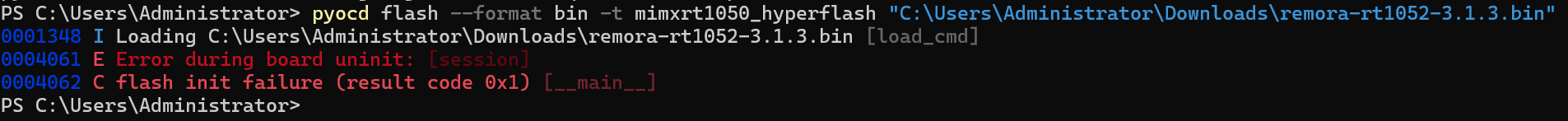

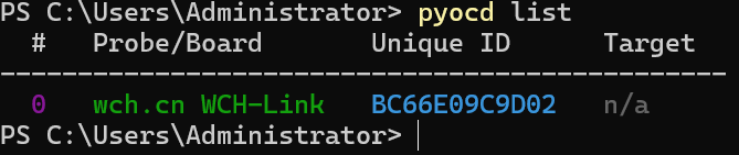

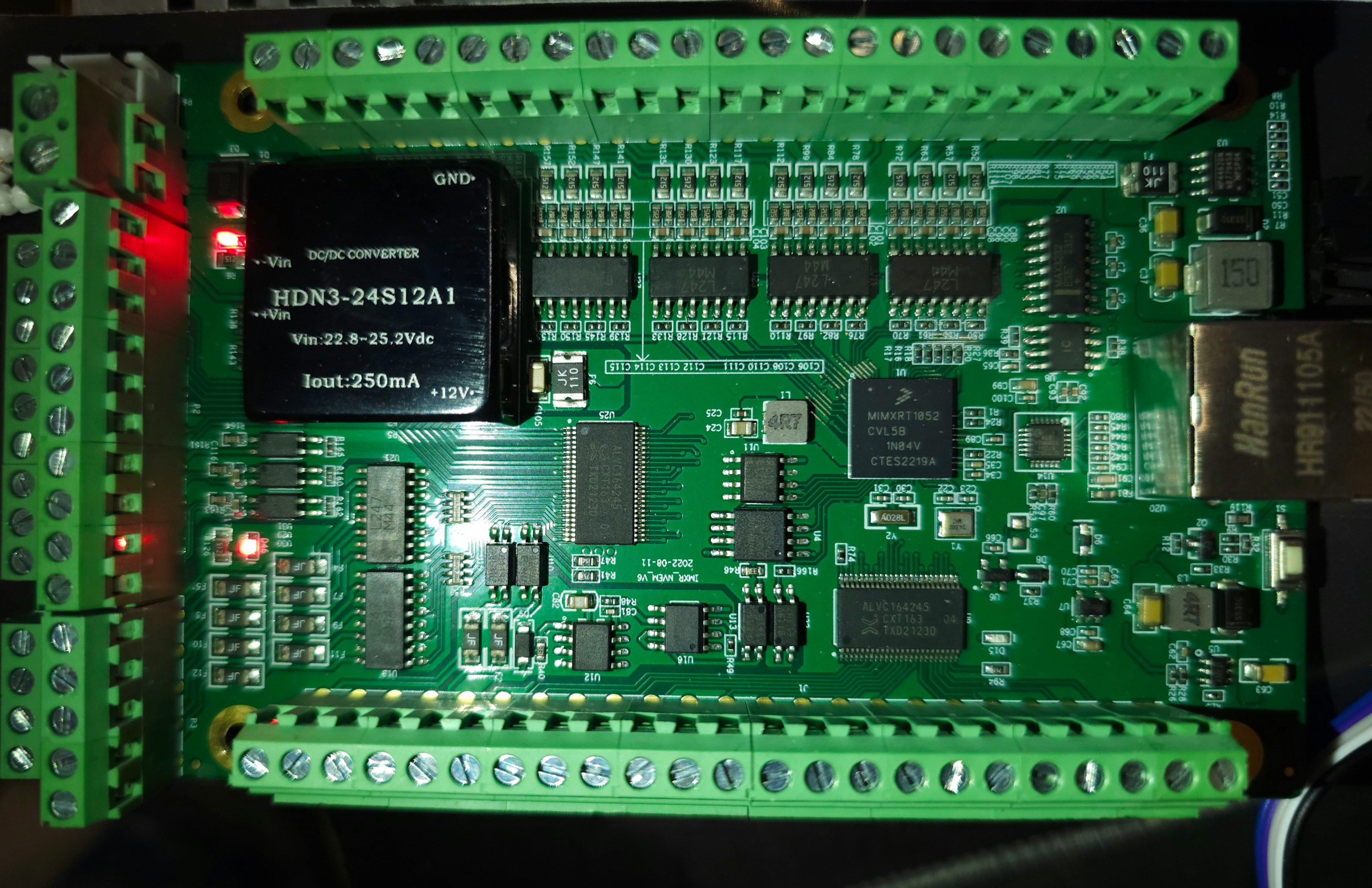

Yay, I managed to get the CMSIS-DAP probes to work with PyOCD! However, when I tried to flash the firmware, I encountered an error: E Error during board uninit: [session]
I've attached some pictures with more details of the issue. Any guidance on how to resolve this would be greatly appreciated!
Thanks again for your support!
Edit: For anyone facing the same issue where the CMSIS-DAP (WCH-Link) doesn't work as a DAP Probe, I was able to fix it using the "WCH-LinkUtility."

- MrDe
- Posts: 11
21 Dec 2024 16:00 #317091
by MrDe
Replied by MrDe on topic Remora - ethernet NVEM / EC300 / EC500 cnc board
Hey Scott,
Sorry to bug you again, but just wanted to let you know I finally managed to flash the firmware and ping 10.10.10.10! Next up is diving into the LinuxCNC side of things.
