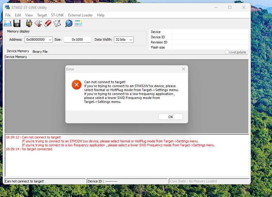

hello
i have an nvem card based on rt1052 but i can't flash it with st link, the card is not detected, i tried with a card with a stm32f401 and it is detected?

23 Dec 2024 20:58 #317228
by scotta
Hi, you cannot use ST-Link utility to flash the RT1052. You will need to use pyOCD with an ST-link (probably need to flash the CMSIS-DAP firmware).

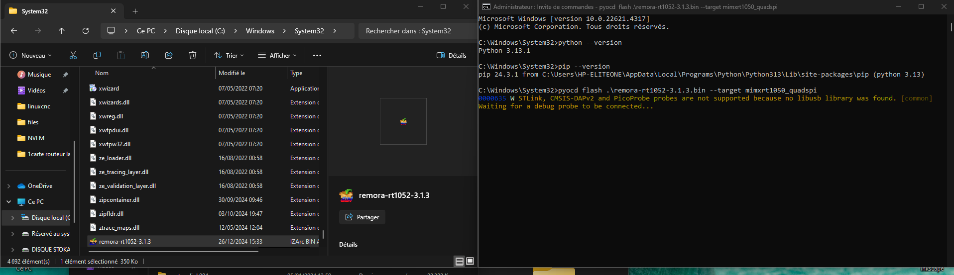

sorry it's really not clear, on the video no pyOCD and utility st LINK, I installed pyton 3.13.1 then pip 24.3.1 then pyOCD and aftersHi, you cannot use ST-Link utility to flash the RT1052. You will need to use pyOCD with an ST-link (probably need to flash the CMSIS-DAP firmware).
//github.com/scottalford75/Remora-RT1052/tree/main/CMSIS-DAP
Last edit: 24 Dec 2024 22:55 by beauxnez.

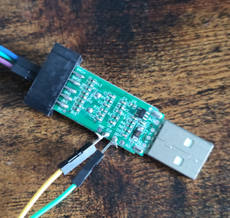

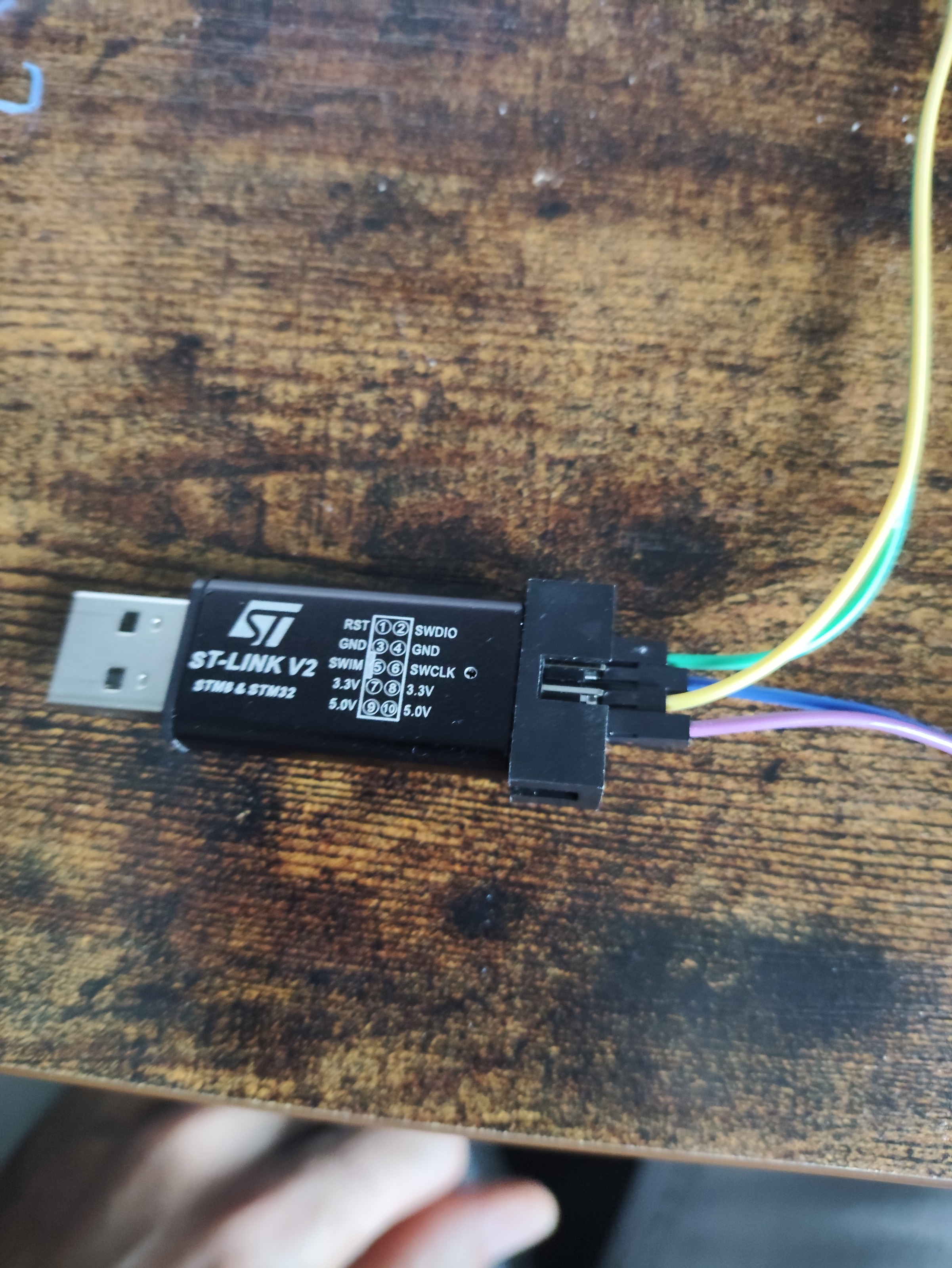

1. Convert an ST-Link to a CMSIS-DAP probe by using a a second ST-Link and the ST-Link utility to flash the CMSIS-DAP firmware.
mvdlande.wordpress.com/2015/10/05/cmsis-...ink-v2-mini-adapter/
2. Use pyOCD with the newly flashed CMSIS-DAP probe to flash the firmware to the controller board
python -m pip install -U pyocd
pyocd flash .\remora-rt1052-3.1.3.bin --target mimxrt1050_quadspi
github.com/scottalford75/Remora-RT1052-c...ora-rt1052-3.1.3.bin

25 Dec 2024 22:09 - 25 Dec 2024 22:14 #317377
by MrDe
First and foremost, you should be able to see the ST-Link as a probe using PyOCD. I would suggest enabling the Windows default Administrator account and trying it from there. In my case, I couldn't get PyOCD to detect either the ST-Link or CMSIS-DAP even when running the terminal as an Administrator!
So, I'd recommend giving the Administrator account a shot. If the "pyocd list" successfully recognizes the ST-Link probe, let me know and we can proceed from there.
Good luck!
