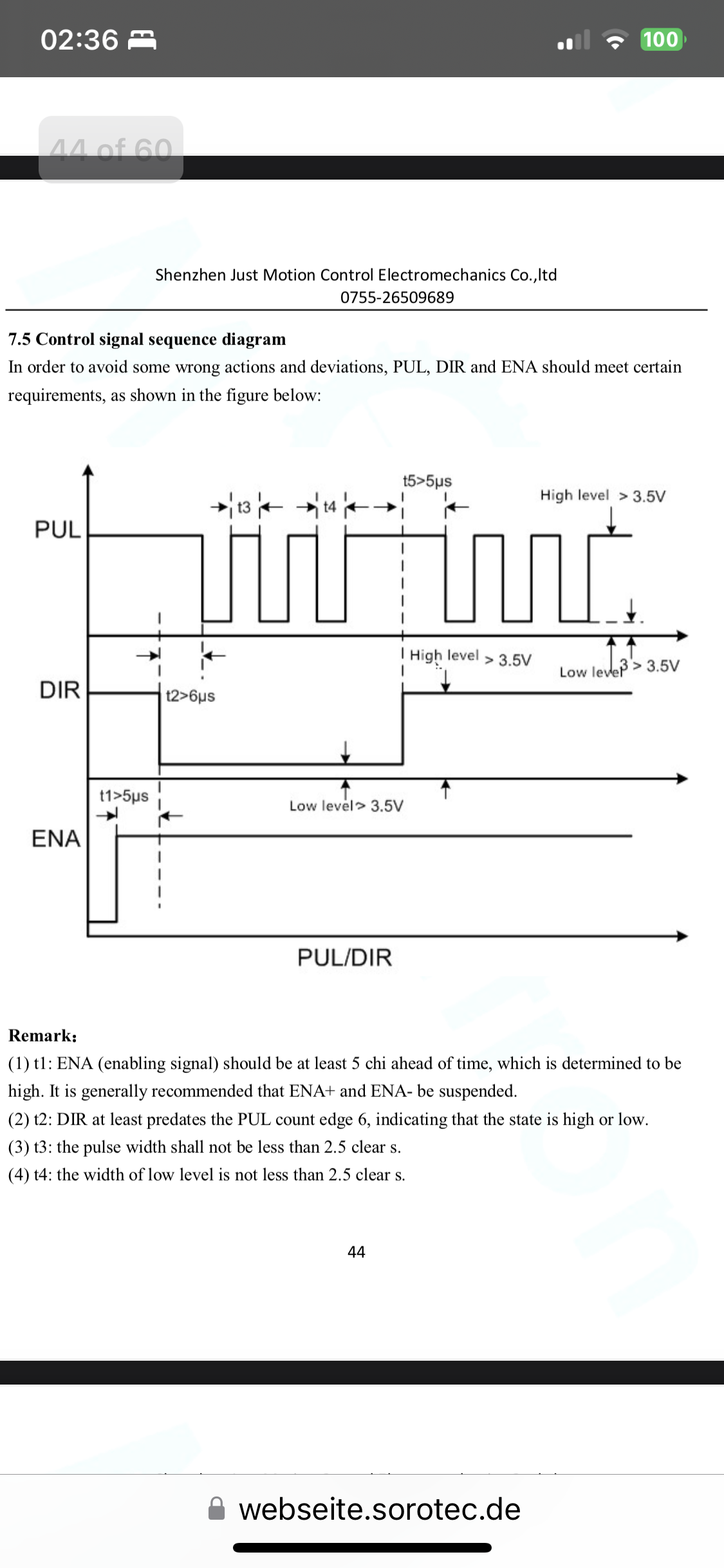

13 Apr 2023 00:38 - 13 Apr 2023 00:39 #268951
by zmrdko
Replied by zmrdko on topic Remora - ethernet NVEM / EC300 / EC500 cnc board
Thanks Scott for patiently replying to all my queries.
i know this formula for correcting travel, but I was expecting the exact numbers to work. If the motor needs 800 pulses to make one turn, I would expect 160 scale times 5mm to work.
I have read that it might be caused by too short pulses. This is diagram I found in motor manual:
is there a way to set up these values?
Last edit: 13 Apr 2023 00:39 by zmrdko.

13 Apr 2023 02:02 #268952
by scotta
Currently there is no step parameter settings configuration. Something in the pipeline though.
Your drive needs a 2.5 microsecond step pulse, the step pulse output form the Remora firmware is 25 microseconds in length. So should be ok. I'd do a step/mm calibration and run it though some test moves to check repeatability.
Nice motors BTW!
Nice motors BTW!

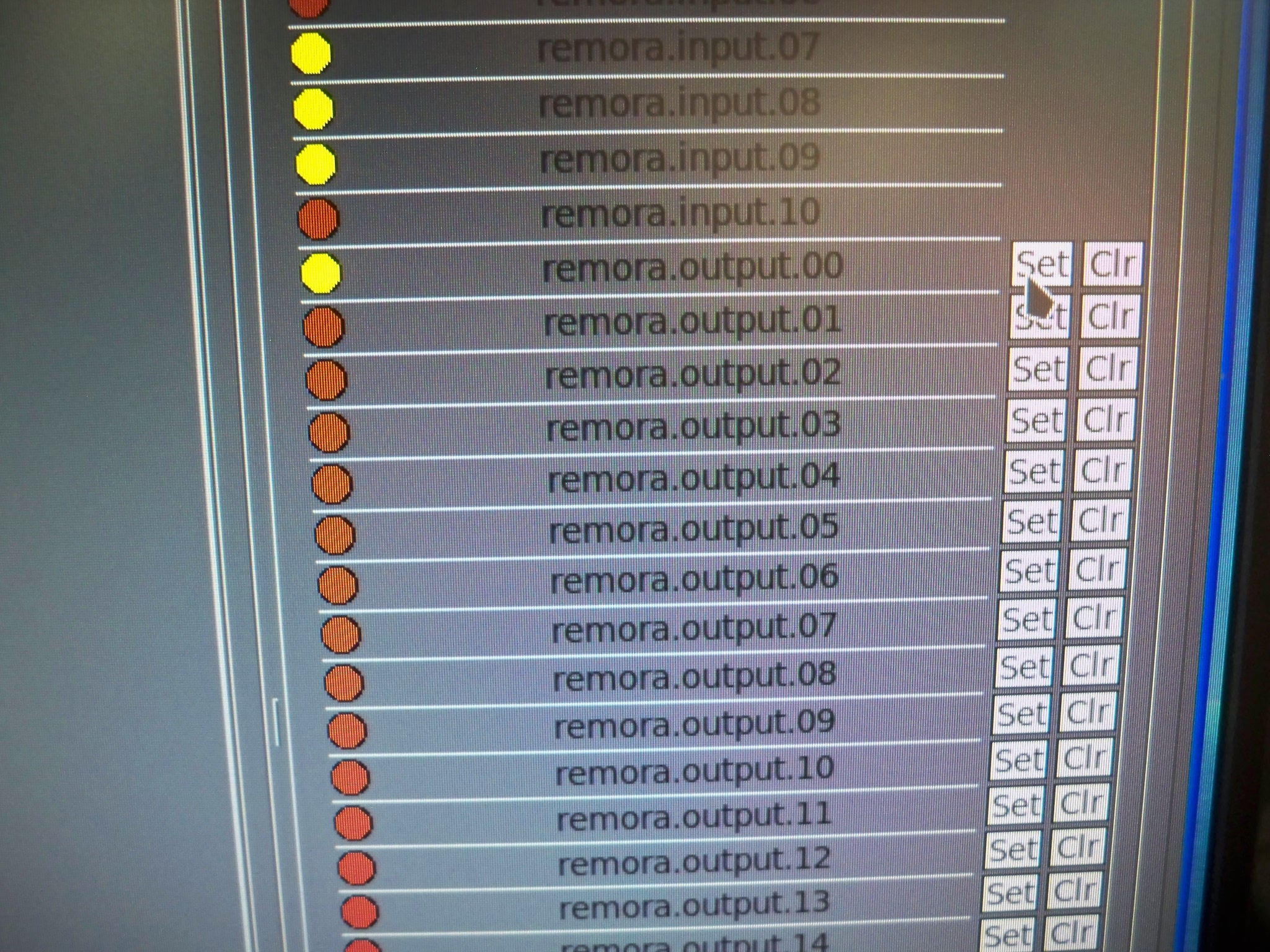

16 Apr 2023 05:08 #269192
by frayja2002
Replied by frayja2002 on topic Remora - ethernet NVEM / EC300 / EC500 cnc board
Hi Scott
Could I get you to check this
I am running an NVEM RT-1052, when I activate remora.output.00 OUT-2 comes on.
And vice versa. remora.output.01 turns OUT-1.
This seems to be backwards. Is this whats intended?
Alex
Alex

16 Apr 2023 06:20 #269194
by scotta
No, nots what intended. I'll check it out but I'm thinking there may be a very subtle difference between the EC300 and NVEM. I developed on the EC300 as it has LEDs on the output. Everything else align numbering wise?
Hi Alex,Hi Scott
Alex

16 Apr 2023 12:13 #269208
by frayja2002
I have now checked them.
All the other outputs seem to be in their natural order.
Alex.
