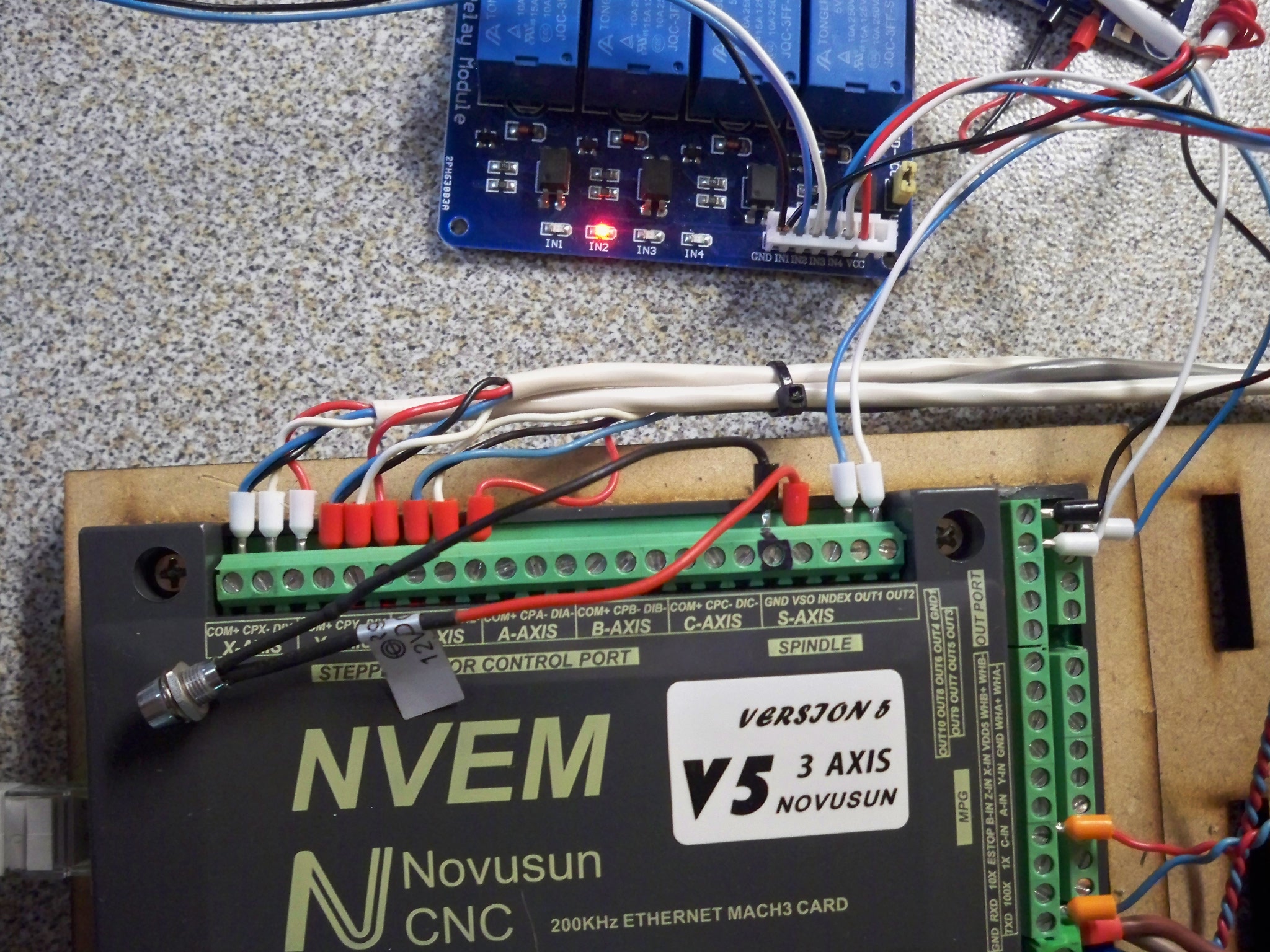

17 Apr 2023 22:34 #269337 by scotta
Hi Scott
Could I get you to check this
I am running an NVEM RT-1052, when I activate remora.output.00 OUT-2 comes on.
And vice versa. remora.output.01 turns OUT-1.
This seems to be backwards. Is this whats intended?
Alex
Hi Alex, I confirmed the IO on the EC300 and it is correct. So there is a slight difference between the NVEM and EC300. I have updated the source and created individual firmware versions for the NVEM and EC300. Can you please test the NVEM version?

Hi Scott
I have tested the new firmware & the lights now match the software.
Alex

18 Apr 2023 13:12 #269370 by frayja2002
Replied by frayja2002 on topic Remora - ethernet NVEM / EC300 / EC500 cnc board
Hi Scott
I have done some further testing of the new firmware (remora-rt1052-NVEM-0.0.2.bin ) & have found that the various input pins in the MPG area are now not working (that used to work before)
Attached is a list of input pins that were working but are now not working. (written in no particular order)
I have flashed remora-rt1052-0.0.1.bin back into the box & can confirm this.
I was using one of these inputs as an Estop (as per the pic.
Alex
