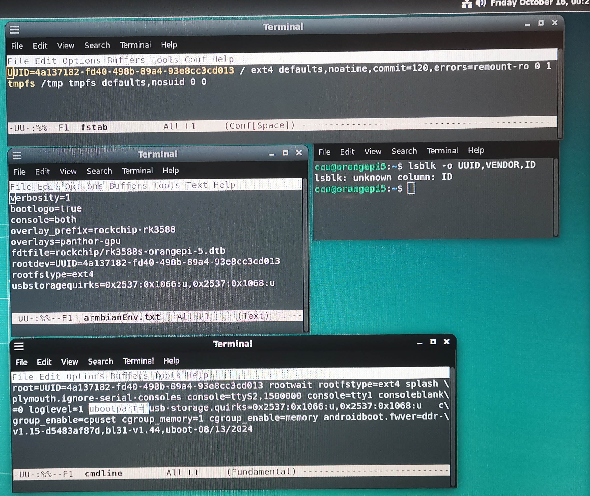

Replied by ccc774 on topic Can the OPI5 be Configured to Run LCNC?
I installed 6.1.75-rt23 on SD card and it works ok on Orange-Pi-5. I tried to put it on nvme and it didn't work. It freezes when booting. Please can you put a version that also works on nvme.

Try thisThen try open FSTAB if possible and edit it by replacing the UUID of your drive from the resulting list
lsblk -o UUID,VENDOR,IDsudo nano /etc/fstab

Like tommylight said and I want to add that you should also check /boot/armbiEnv.txt for the same UUID. When you see a /boot mount in fstab you could remove that line too.
Here it didn't recognize the ID option by the way, in that case just leave that away, alternatively you could issue the blkid command to see the UUID.

first of all, thank you for your prompt answers.I can boot with kernel 6.1.75-vendor-rk35xx, with the 6.1.75-rt23 .debs installed, but without making the link (sudo ln -sf vmlinuz-6.1.75-rt23 Image). If I reboot and then make the link, it doesn't boot anymore. In /proc/cmdline I don't see any value for ubootpart=.

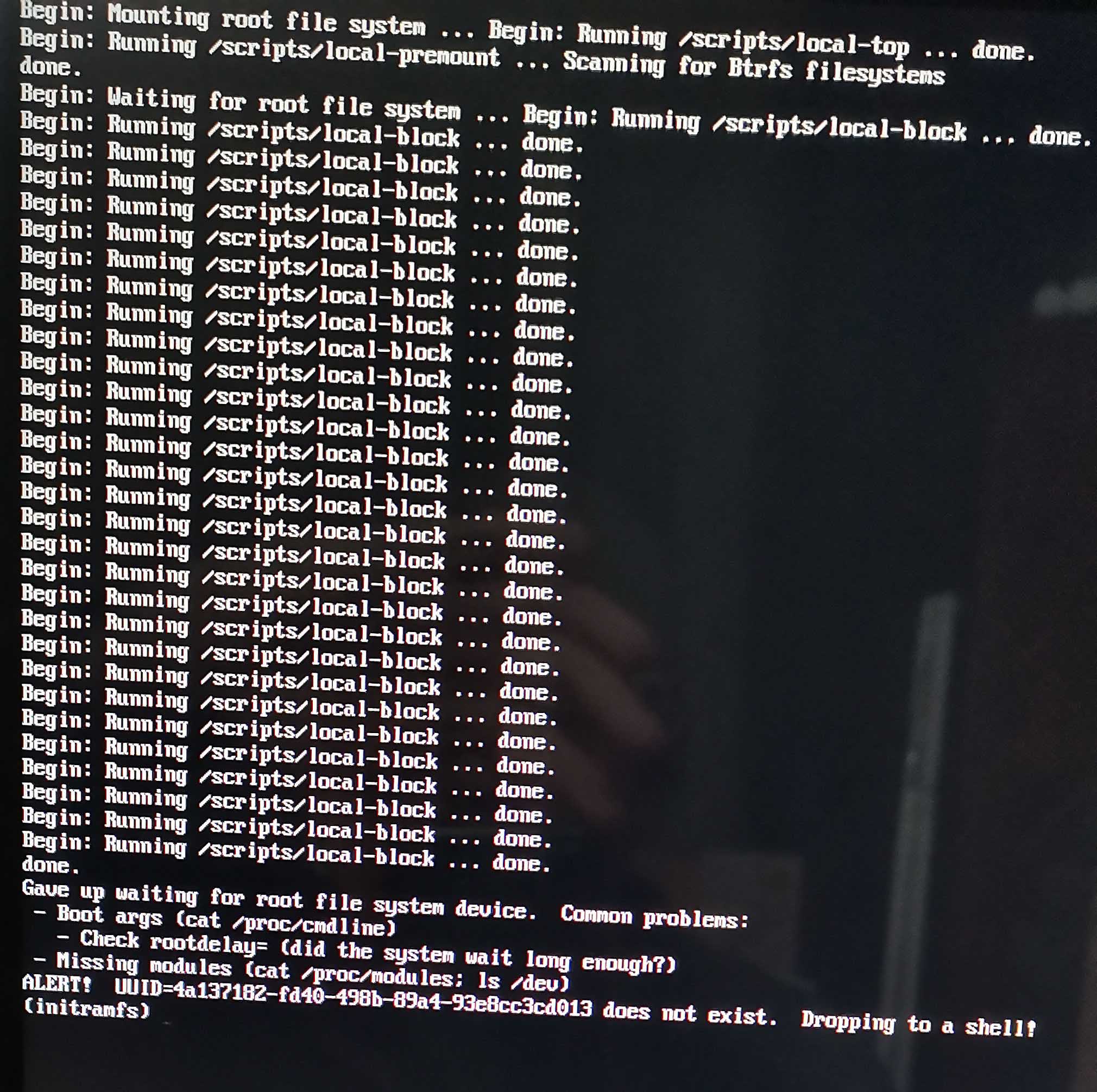

I can read all the IDs in /drv/disks...., but I don't know how to enter it to recognize it.

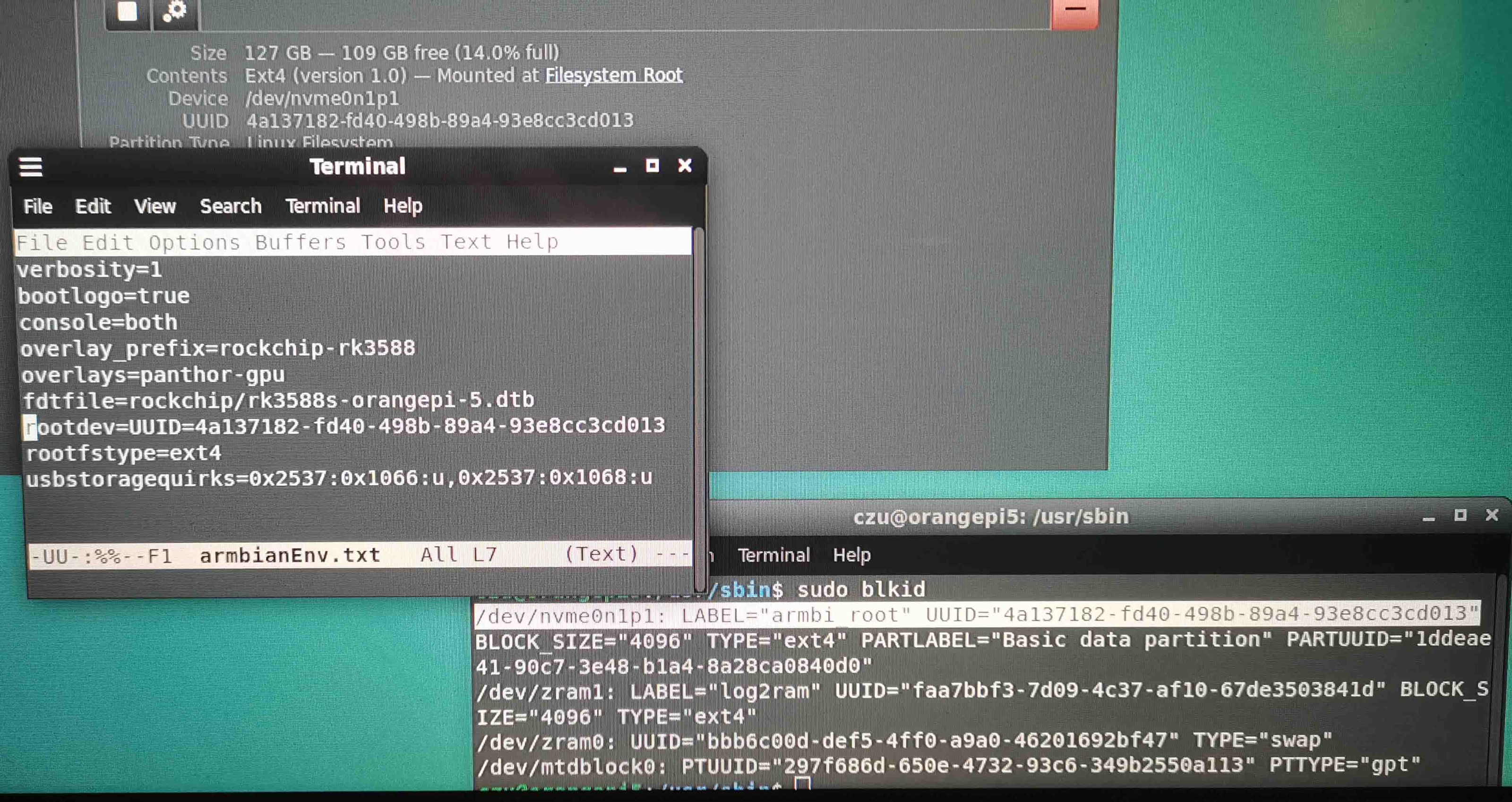

rootdev=UUID= lotsofnumbershere
those lots of numbers have to be replaced by the ID of your drive

The ID returned by blkid is the same that I have in armbianEnv and it is the same ID that it says it does not recognize when booting.
