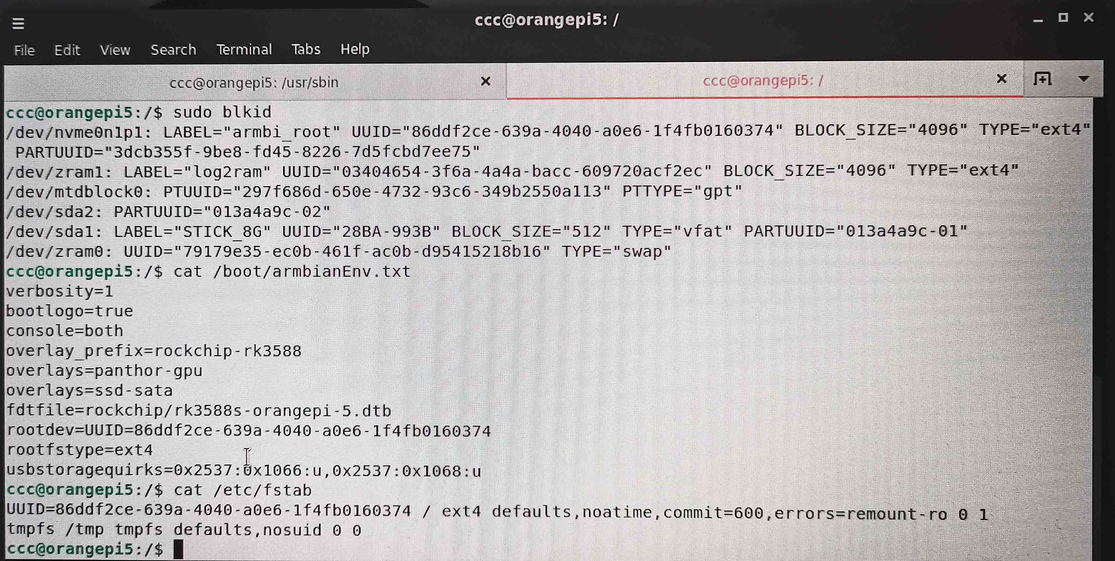

- royka
- Posts: 383
- Thank you received: 135
18 Oct 2024 15:16 - 18 Oct 2024 15:51 #312523
by royka
Replied by royka on topic Can the OPI5 be Configured to Run LCNC?
Uhmm I forgot that I have a m.2 sata drive in the opi5, after enabling the sata overlay it's actually recognized. So no idea what is going wrong at this moment.
Can you show the full output of:
/usr/sbin/blkid
cat /etc/fstab
cat /boot/armbiEnv.txt
/usr/sbin/blkid
cat /etc/fstab

- ccc774
- Posts: 24
18 Oct 2024 16:17 - 21 Oct 2024 22:12 #312533
by ccc774
Replied by ccc774 on topic Can the OPI5 be Configured to Run LCNC?
Last edit: 21 Oct 2024 22:12 by ccc774.
- royka
- Posts: 383
18 Oct 2024 16:45 - 18 Oct 2024 17:12 #312535
by royka
I guess you need to remove the line with overlays=ssd-sata from armbiEnv.txt
But it looks like you didn't have that line before...
When you boot the rt kernel from the sd-card it recognizes your nvme?
With the non rt kernel it does boot from the nvme?
Found some other drivers, will add them and compile a new one in about 30min
Last edit: 18 Oct 2024 17:12 by royka.
