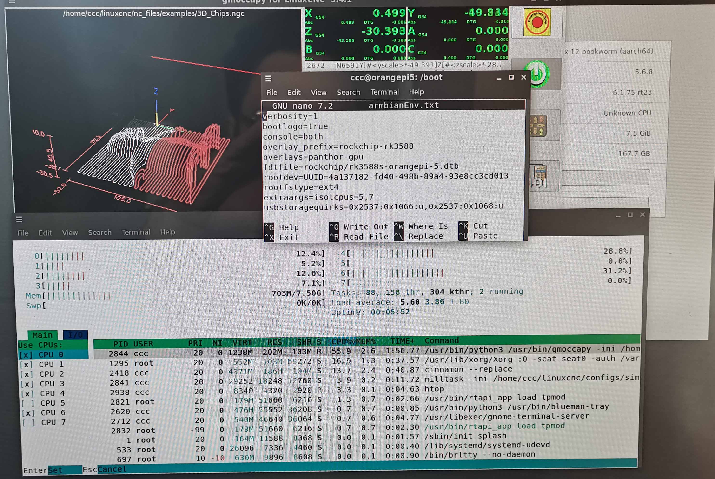

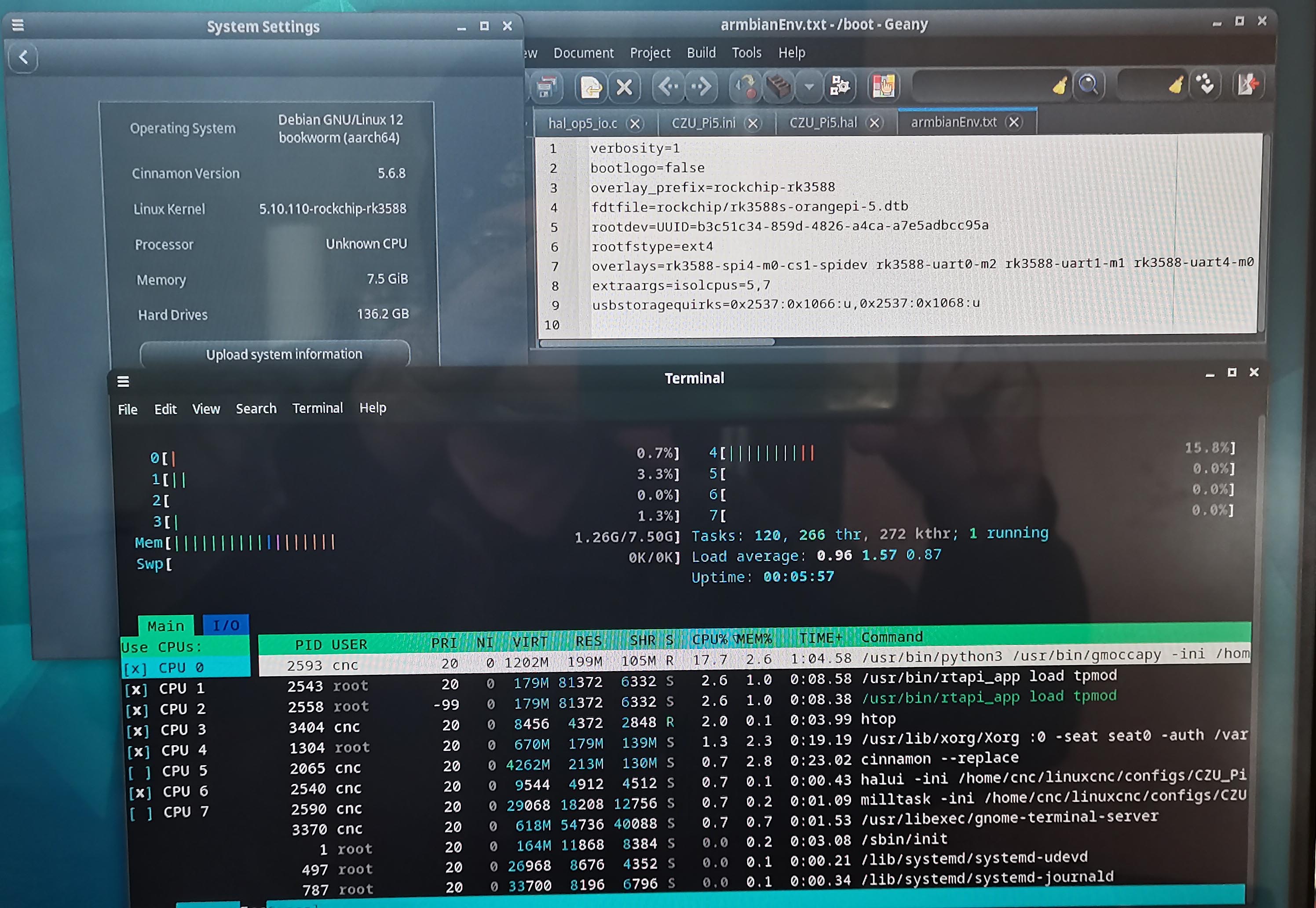

20 Oct 2024 11:54 - 21 Oct 2024 22:10 #312662 by ccc774
Replied by ccc774 on topic Can the OPI5 be Configured to Run LCNC?
When I boot the rt kernel from the sd-card it recognizes my nvme.With non rt kernel is booting from the nvme. I put the image with Kernel 6.1.75 non rt on nvme and after that I ran from it. Then I installed version 6.1.75-rt23 running from nvme and made the link. I restarted and it didn't boot anymore.I wrote several boot images from your links and it does the same thing.I have put all the previous versions on nvme so far and I have never experienced this.Please look at the following images and let me know how your system show when you do this:1. run linuxcnc2. open Htop and select linuxcnc process. Press "a" to show related cores affinities to linuxcnc.As you can see in my pics 5,7 cores show 0.00% usage.  They are not used. What it show yours?

Mine shows the same cpu usage by the way, even while running latency-histogram. You'll see that rtapi (the realtime component) with priority -99 runs on the last cpu, so it works how it should.

20 Oct 2024 20:26 #312711 by ccc774
I tried the bootloader you gave me and it doesn't work.
The 5 and 7 cores are isolated and linucnc works with highest priority on 0,1,2,3,4,6 cores (Htop shows this).
So nobody uses 5, 7 cores. Why isolate them if you don't put linuxcnc on them?
I noticed that my linuxcnc works better with all cores enabled. I actually watch StarTrek when the cnc is running.

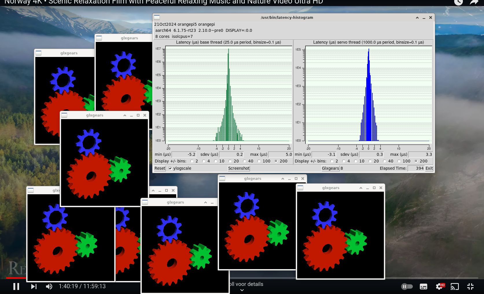

20 Oct 2024 22:41 - 21 Oct 2024 10:41 #312714 by royka
Replied by royka on topic Can the OPI5 be Configured to Run LCNC?
Alright, now took my last attempt of building another kernel, if this one still doesn't work it should be something else. The kernel is in the Test folder.
drive.google.com/drive/folders/1r76sUsfG...6fGcz?usp=drive_link
The realtime component is on core 7 by the way, in htop you should select the one with -99 priority before you press "a'. The gui isn't realtime so no need to put that one on a isolated core. But without isolating cores the results are still good enough indeed, so if that experience is better it might be the better choice.
Just tested without isolating a core and the latency on the servo thread went up to 40us, while when I only isolate core 7 until 3.3us. The kernel in the Test folder is with cpu governors, so I put these via armbian-config at performance and lowest frequency at the highest.
With only core 7 isolated it has no frame drops at 1440p@30fps, unfortunately there is no full (ffmpeg) hw acceleration in chrome anymore, where the cpu usage stayed below 10% @4k.
