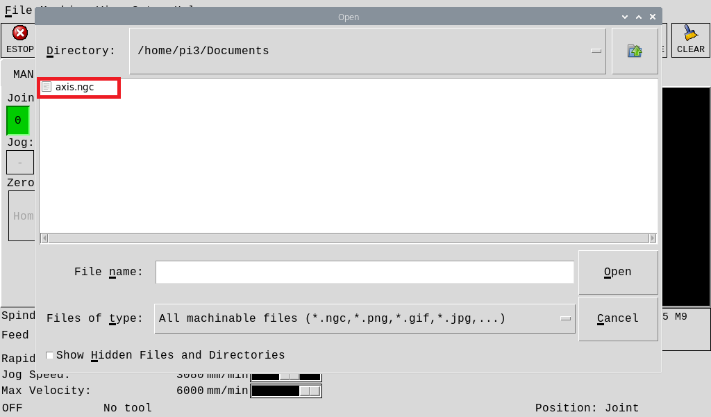

13 Jan 2025 22:21 - 13 Jan 2025 22:29 #318923
by nawaf
Replied by nawaf on topic Axis Modifications
Thank you, Phill, that was very helpful.How can I make the file list display with larger sizes? I want to increase the size of the text and icons.

14 Jan 2025 20:47 - 14 Jan 2025 20:51 #318994
by cakeslob
Replied by cakeslob on topic Axis Modifications
holy shit I am not sure why they made this so hard. they are using a different font class
for changing the font size in the file menu -
for posteriority heres how I got there. fbox takes the files and makes them into an Iconlist, which then uses the font family TkIconFont to configure this megawidget "Iconlist"
I thought it was odd that some of the widgets configured to our textsize and font but some did not. Its the same case for the entry widget that loads the file name. The colours dont change for most widgets unless you change the colour after you open, and even then only some widgets configure. The options in the listbox configure colour but none of the other text changes colour.
nawaf are you using regularmac800? that will make this easier. you can just add those 2 lines, or get the update from the github.
unfortunately this doesnt make it a better file browser. there are some alternative ones i want to try out when i figure out how

14 Jan 2025 21:44 #318998
by phillc54
Replied by phillc54 on topic Axis Modifications
Yeah, these are mostly themed widgets so some options require setting via styles. It can be a PITA.holy shit I am not sure why they made this so hard
It seems to need an update for the first run, the below bigfileopen.tcl touches every widget in the dialog and includes the update.I want to increase the size of the text and icons

- nawaf
- Posts: 5
15 Jan 2025 21:47 #319084
by nawaf
I am using a 10-inch touchscreen with a resolution of 1024x600 and I want to use the Axis GUI with buttons that are large enough, and I saw your mod and tried it. It's great because the buttons are big enough.
But for the open file dialog, the buttons are not big enough for my fingers, making it a bit difficult to touch them on my screen
Yeah, thanks, cakeslob, for the GUI mod.nawaf are you using regularmac800?

Do sudo apt-get install zenity,
Follow BigJohnT's instructions regarding bigfileopen.tcl
Then use the attached as your bigfileopen.tcl (copy it in to your config folder and change the extension)
This calls the zenity app on using file Open within Axis. It should default to the Desktop the first time, then to the last folder used. Hope it's some use.
Andy

I've also found the included file browsing/file open ap within Axis to be very limiting to use. The work around we often used was to use the file browser of your choice on your Linux desktop to find the g-code file you want to run, then with a right mouse click use the "axis-remote" command to open to open the g-code file in Axis directly from the file browser. This was especially helpful when wanting to run files saved in network directories that you could not easily find or access using file open in Linuxcnc.
I don't know if this works using other Linuxcnc GUIs or if any of the other GUIs offer an equivalent command to axis-remote that can be used to open a g-code file from another file browser.
