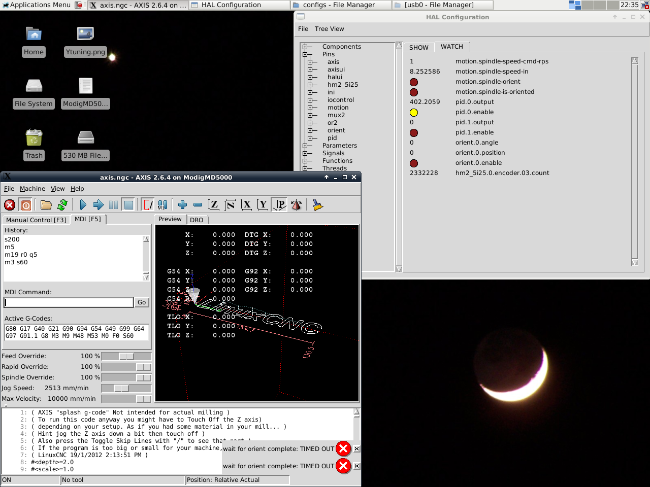

07 Jun 2015 00:21 #59537 by thewho
Replied by thewho on topic VMC related HAL questions.
Yes, it rotates until it times out
Tried those commands and it rotates the correct way.
I installed the component, edited the "spindle.hal" file and got no errors on startup.

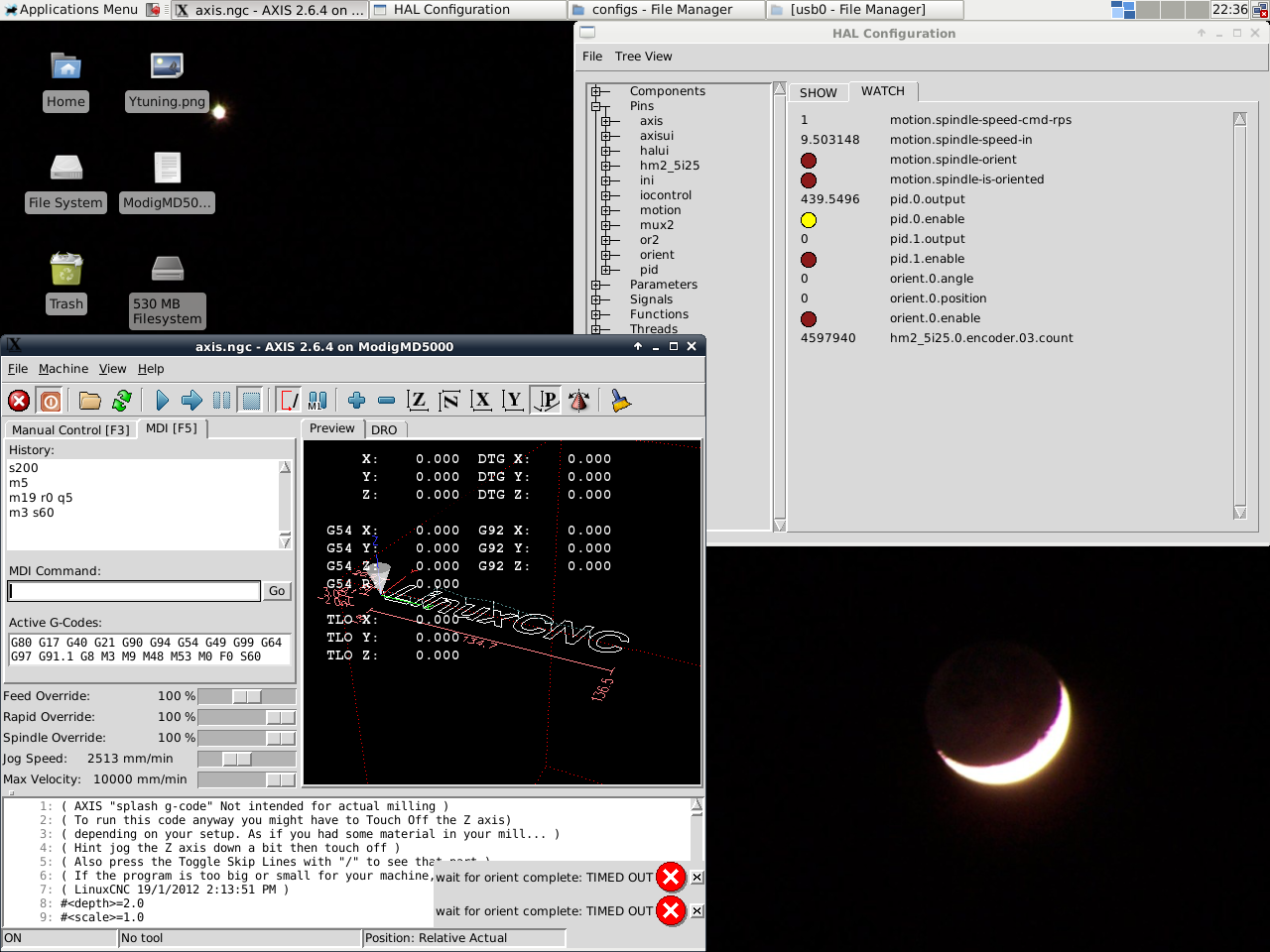

Added two screenshots, about 1min between them.
I'll also attach spindle.hal if I might have screwed something up in there. Commented all lines containing "near"

07 Jun 2015 01:23 - 07 Jun 2015 01:27 #59545 by thewho
Tried I = 0 & ff0 = 0 and then the pid value stays the same as do the rpm's
Don't know if you saw in the screenshots that the spindle turns about 6times the requested speed. S60 = 380rpm
EDIT: Also, "orient.0.angle" & orient.0.position" is always 0. I would thing one of them should be actual angle of the spindle?

07 Jun 2015 02:03 #59547 by andypugh
Replied by andypugh on topic VMC related HAL questions.
While testing you might have to M5 to get motion.spindle-orient to go to zero so that the orient comp can calculate a new angle.
Spindle too fast seems to mean that your [SPINDLE]OUTPUT_SCALE is wrong. That should be the spindle speed at 10V command signal.
You said that spindle pos increases by 1 for forwards. Does it decrease backwards?
I have absolutely no idea what is going on any more. Do the PID command and feedback numbers make any sense?
The problem is probably these two lines
net spindle-vel 		pid.0.feedback # & encoder.3.velocity for a real machine
net spindle-vel-fb            <=  hm2_5i25.0.encoder.03.velocity
You need to be consistent in the signal naming. If you want to use spindle-vel-fb then use it everywhere.
Also, the position pid has no feedback either, so that is why that isn't working:
#net spindle-pos 		pid.1.feedback orient.0.position near.0.in1 # & encoder.5.position for a real machine
#net spindle-pos-cmd 	orient.0.command pid.1.command near.0.in2
You have commented out the command _and_ the feedback to the position PID. Just delete the "near" stuff, don't comment out the rest of the net, that is needed.
Elsewhere in the code you are using "spindle-revs" for the spindle position, so be consistent with that again here.
