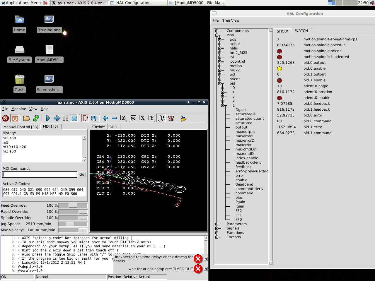

07 Jun 2015 20:18 #59600 by thewho
Replied by thewho on topic VMC related HAL questions.
When M19 is active there is no speed command, it just enables the spindle so the rotation is just the drive drifting slowly.
So how do I specify orient tolerance?
setp orient.0.tolerance (number)
Added a screenshot of hal config. M3 s60 is active.
07 Jun 2015 20:21 #59601 by andypugh
Replied by andypugh on topic VMC related HAL questions.
The speed command should come from the position PID.
Do you see any output from the PID (if not, have you tuned it?, are the gains being read in from the INI correctly?)
When you say there is no speed command, where are you looking?
Yes, just like that. In degrees.
