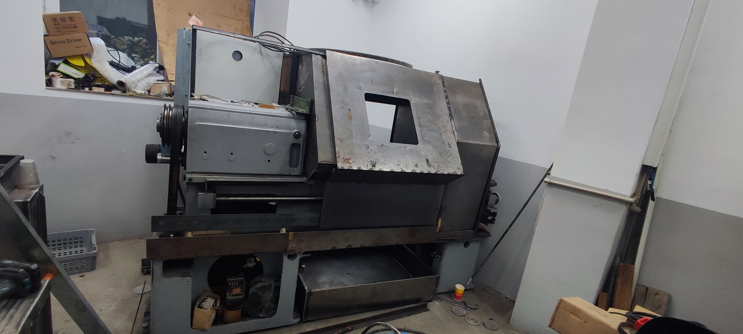

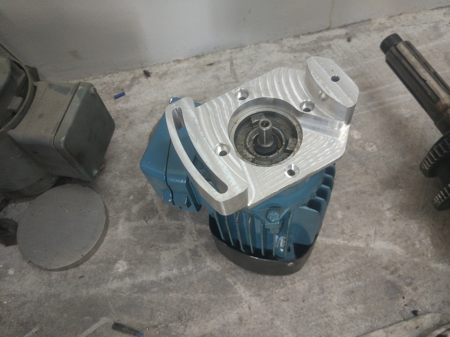

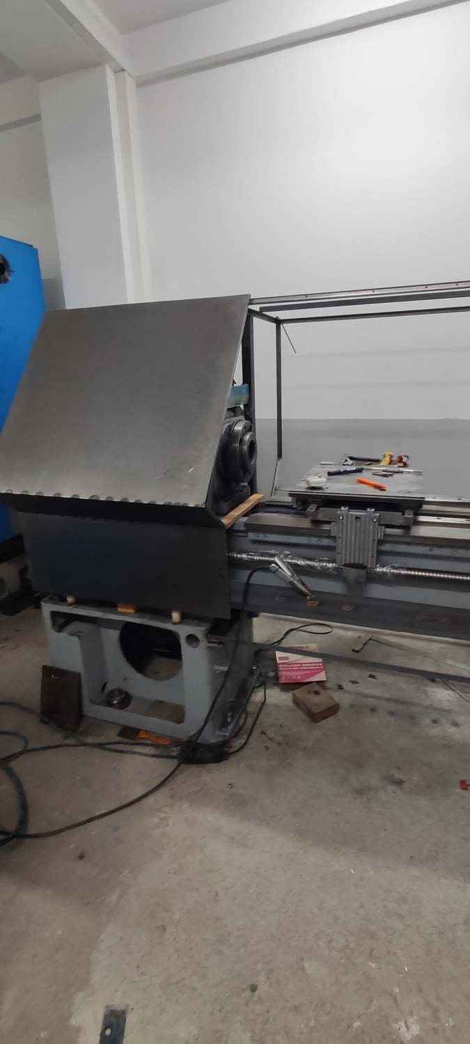

It's one of those stupid/crazy CNC lathe projects. If I could turn back time, this project would not exist.I will try to upload more pictures but not everything is documented ..

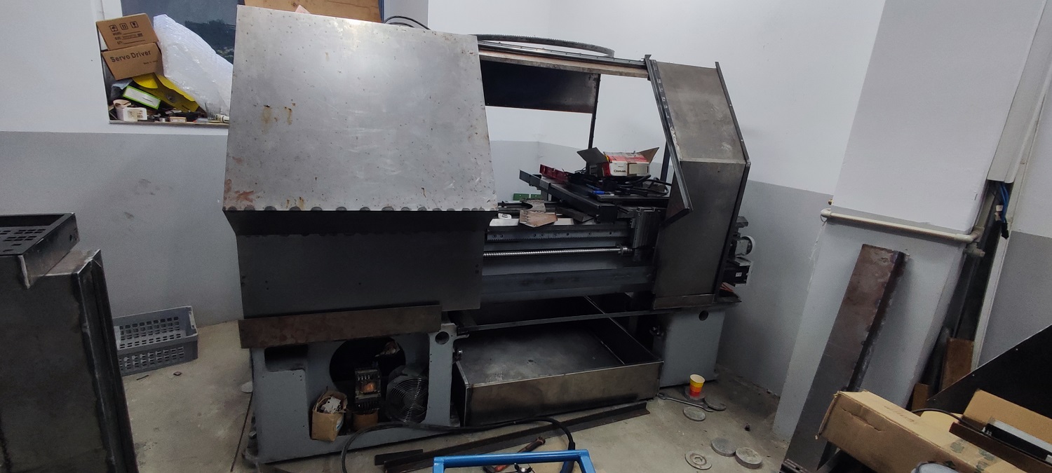

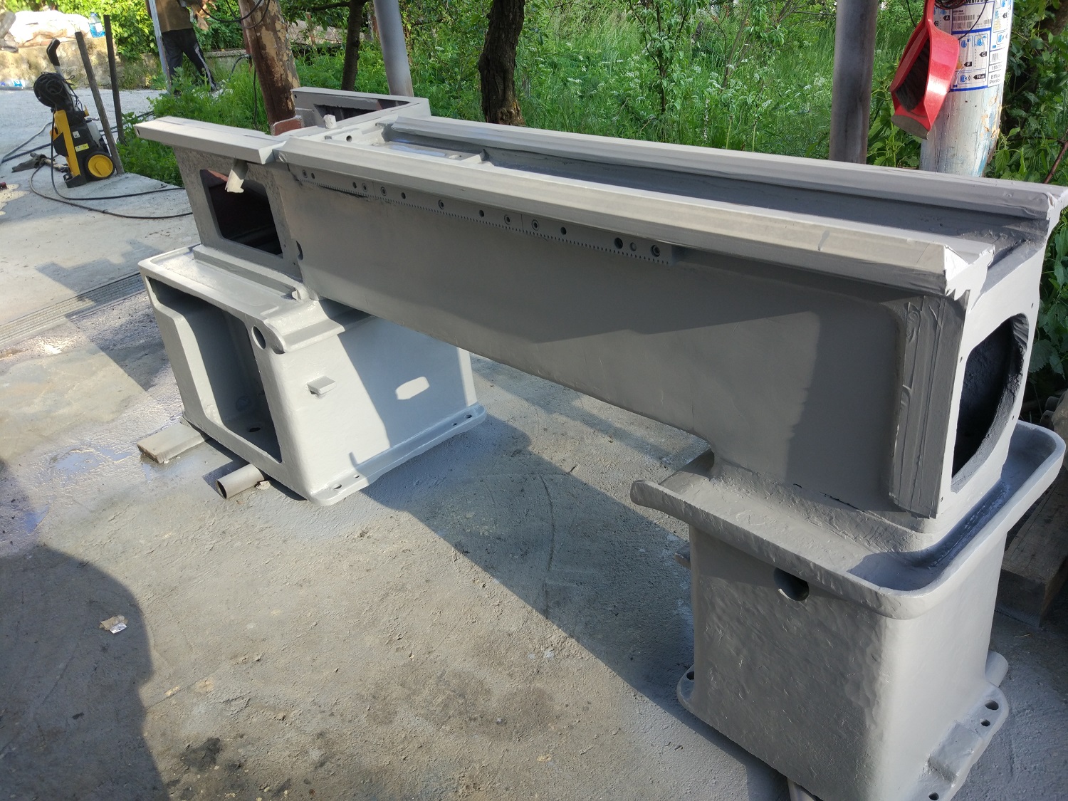

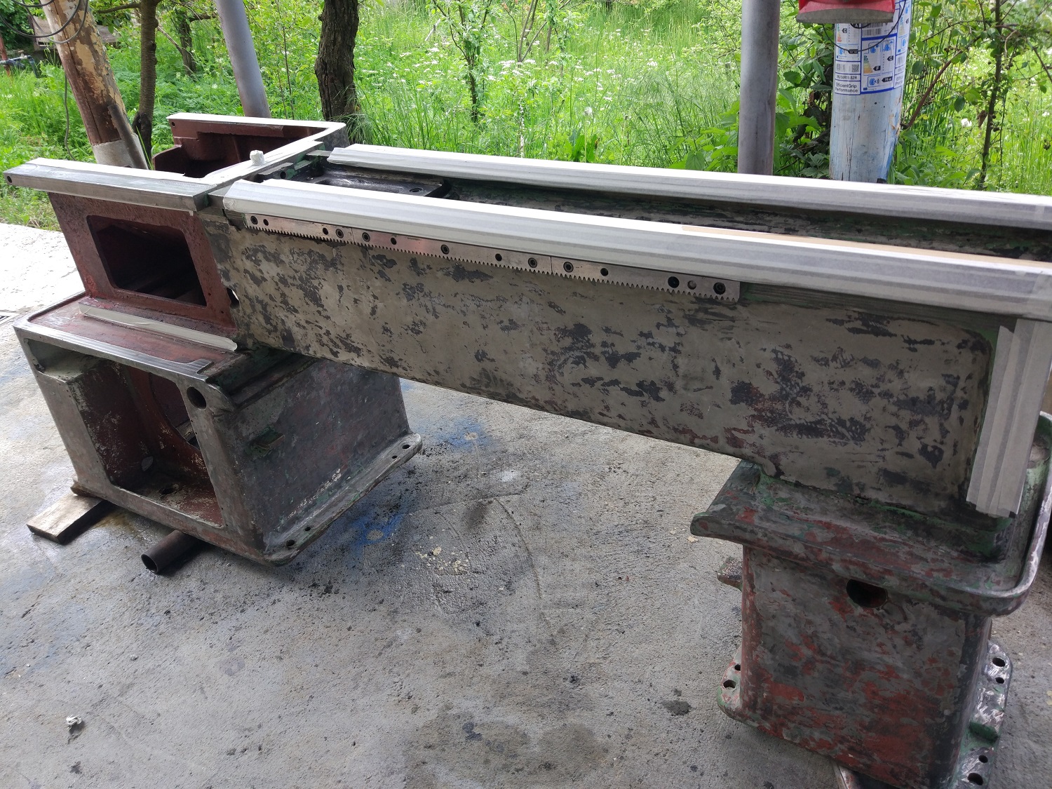

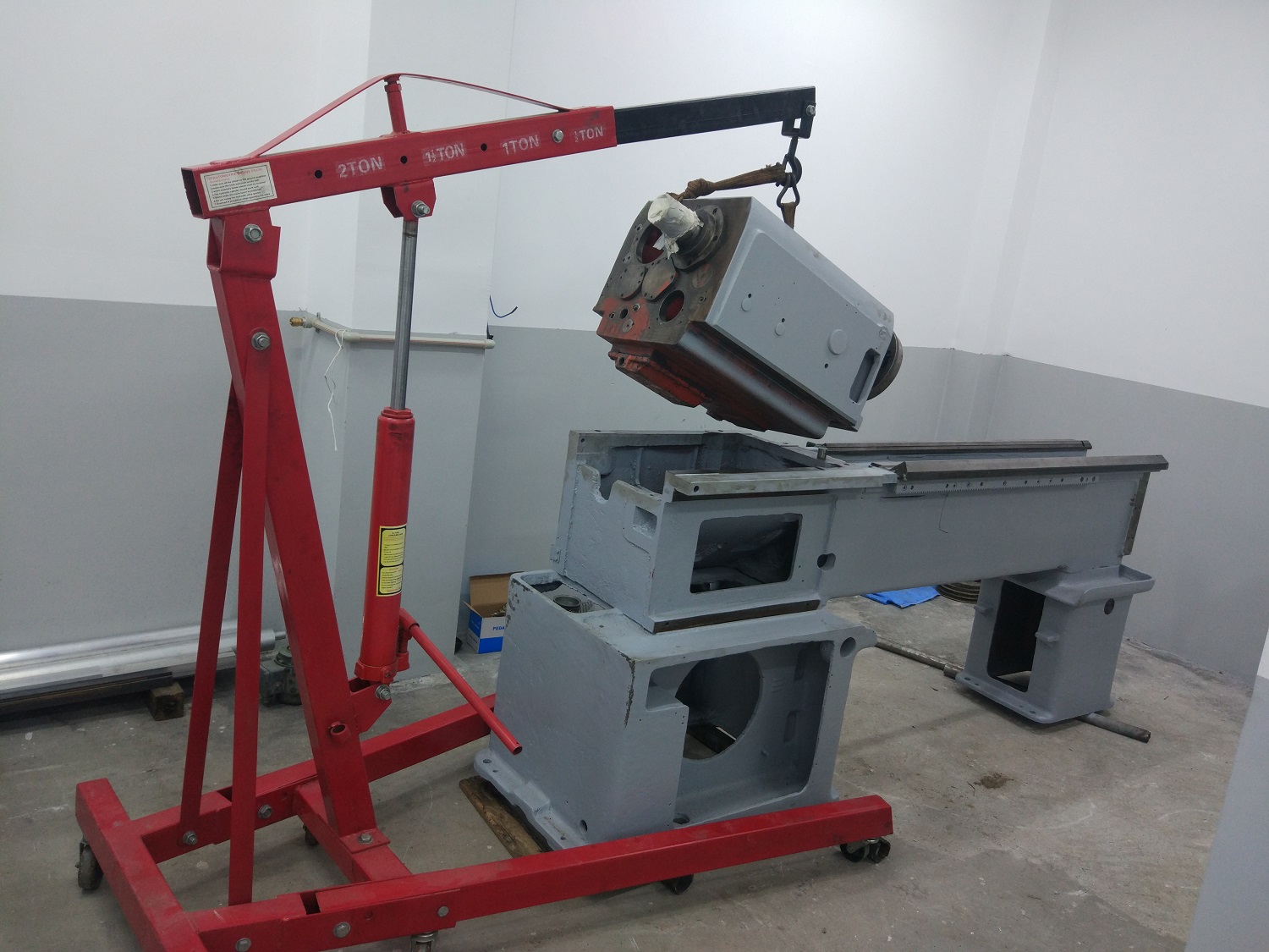

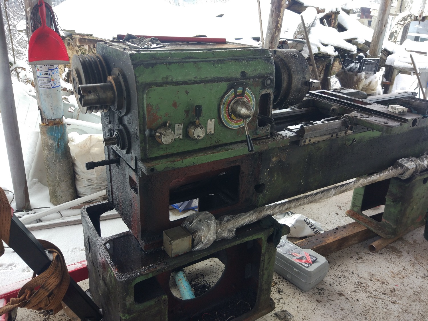

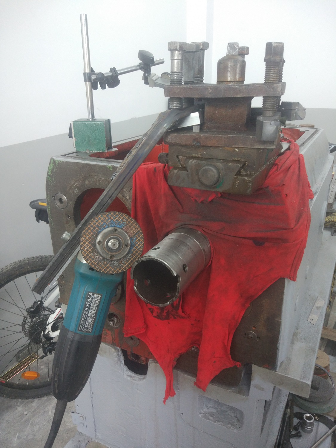

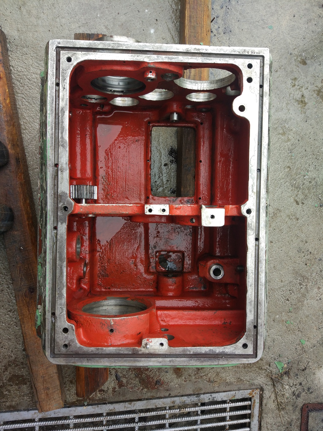

We bought an old machine probably 2 tons of iron and immediately begins disassembly, washing and painting

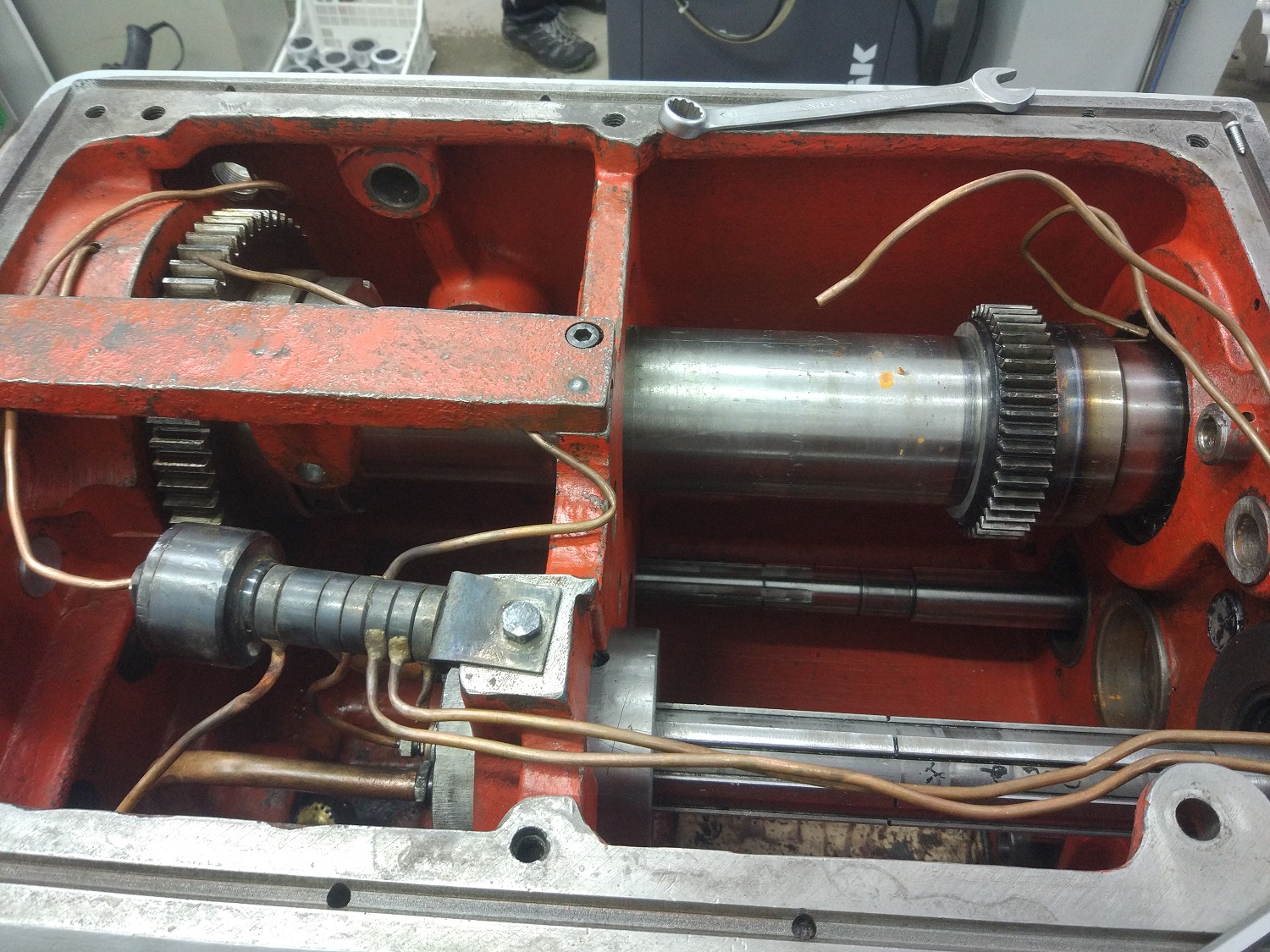

I threw out a lot of parts from the gearbox

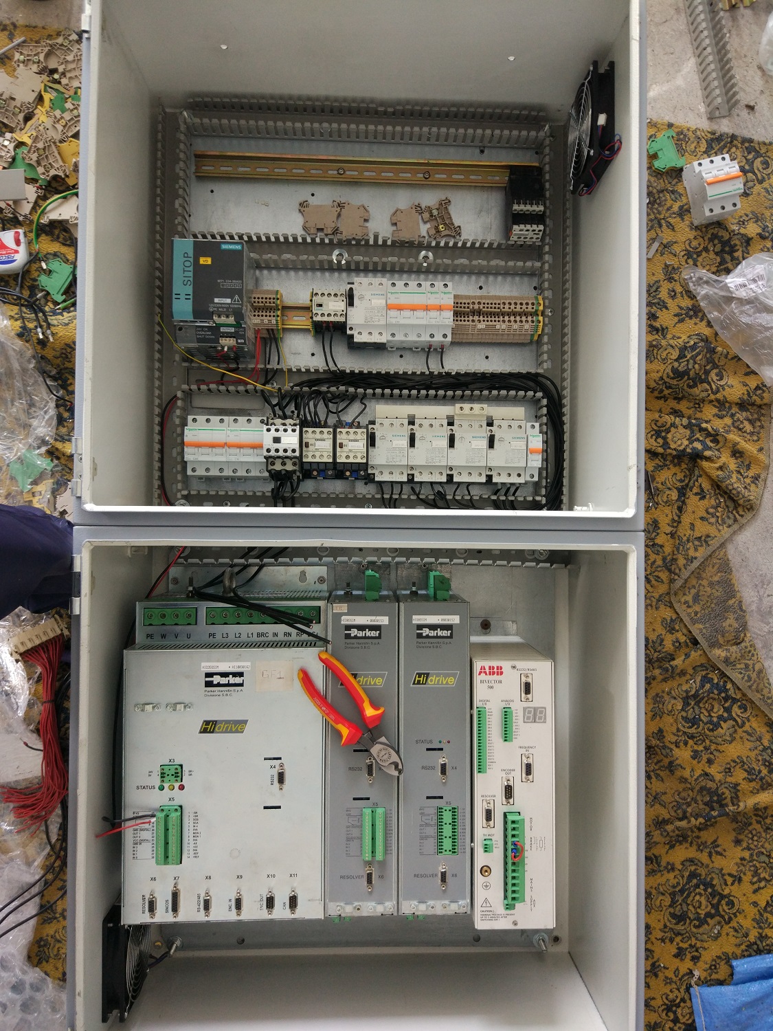

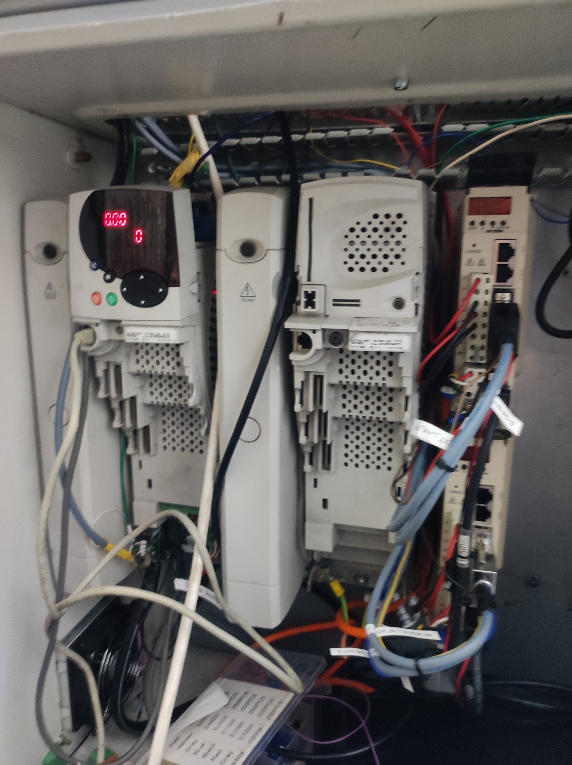

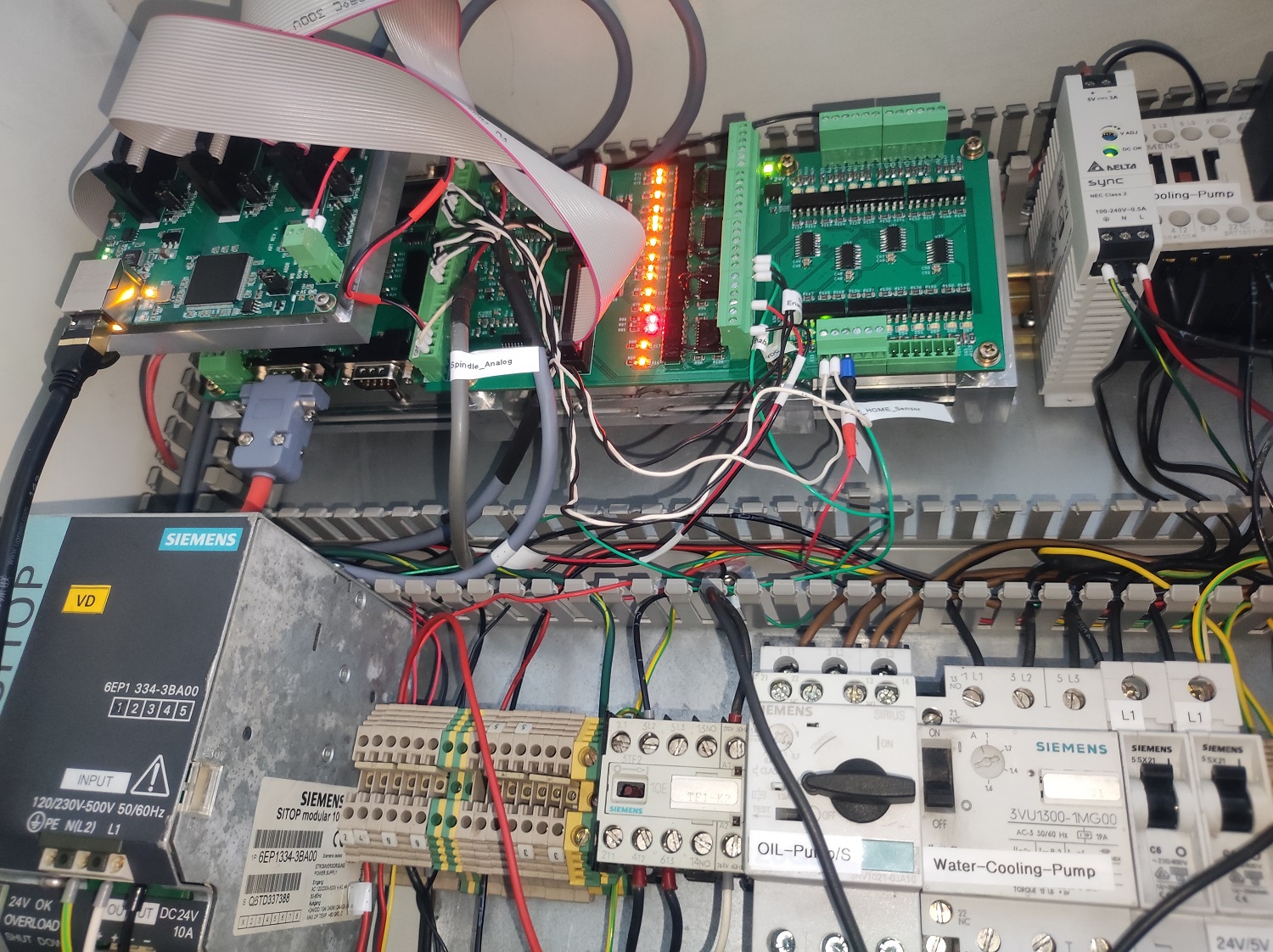

This is the first layout of the electrical cabinet

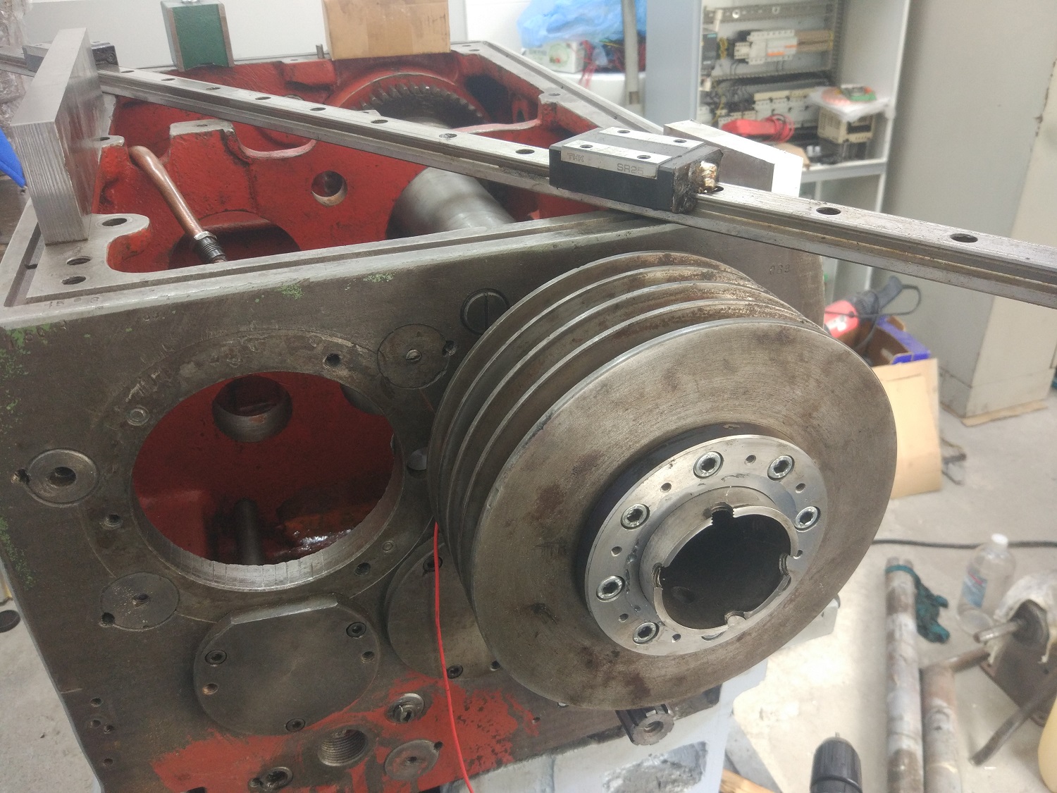

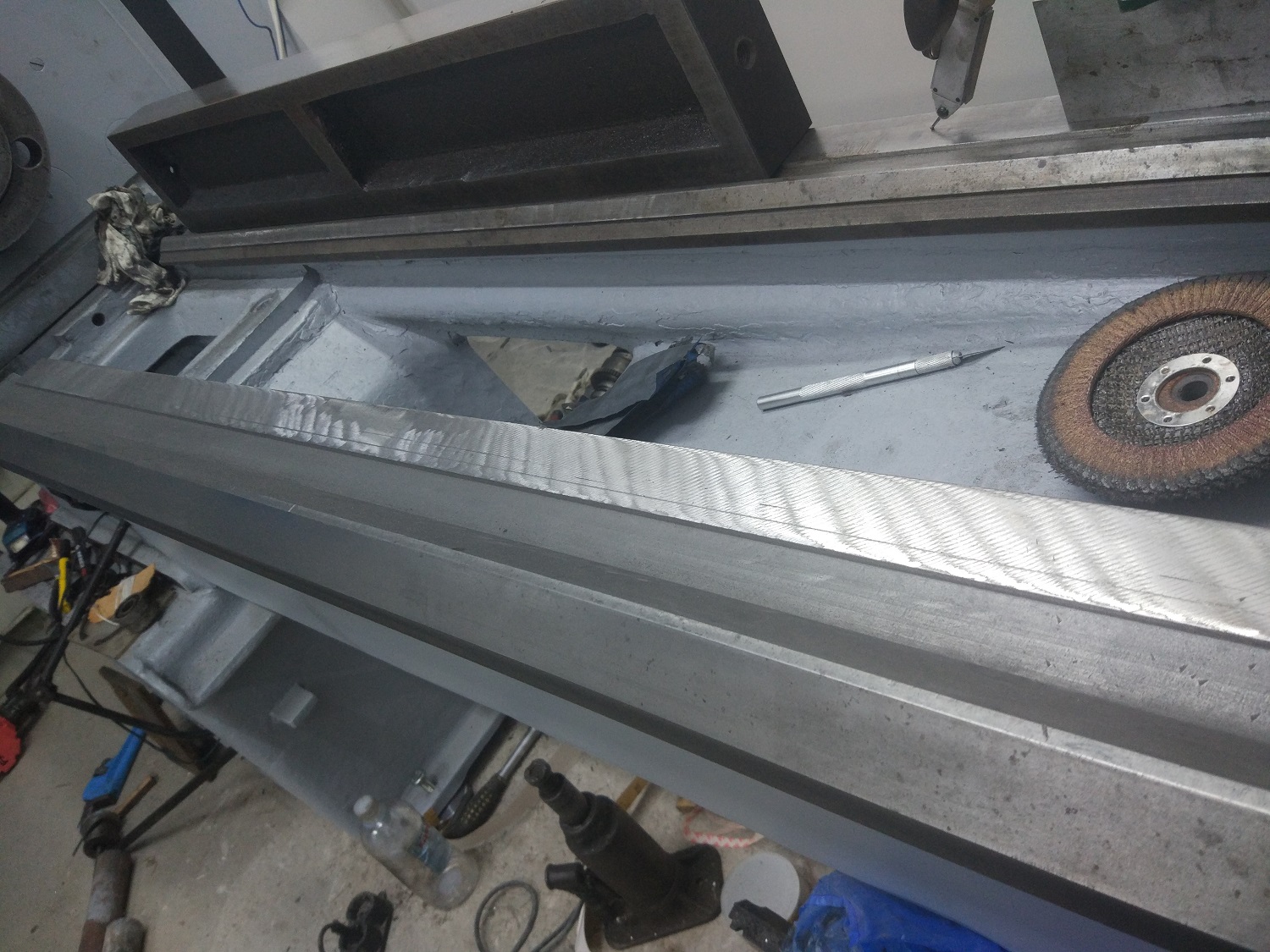

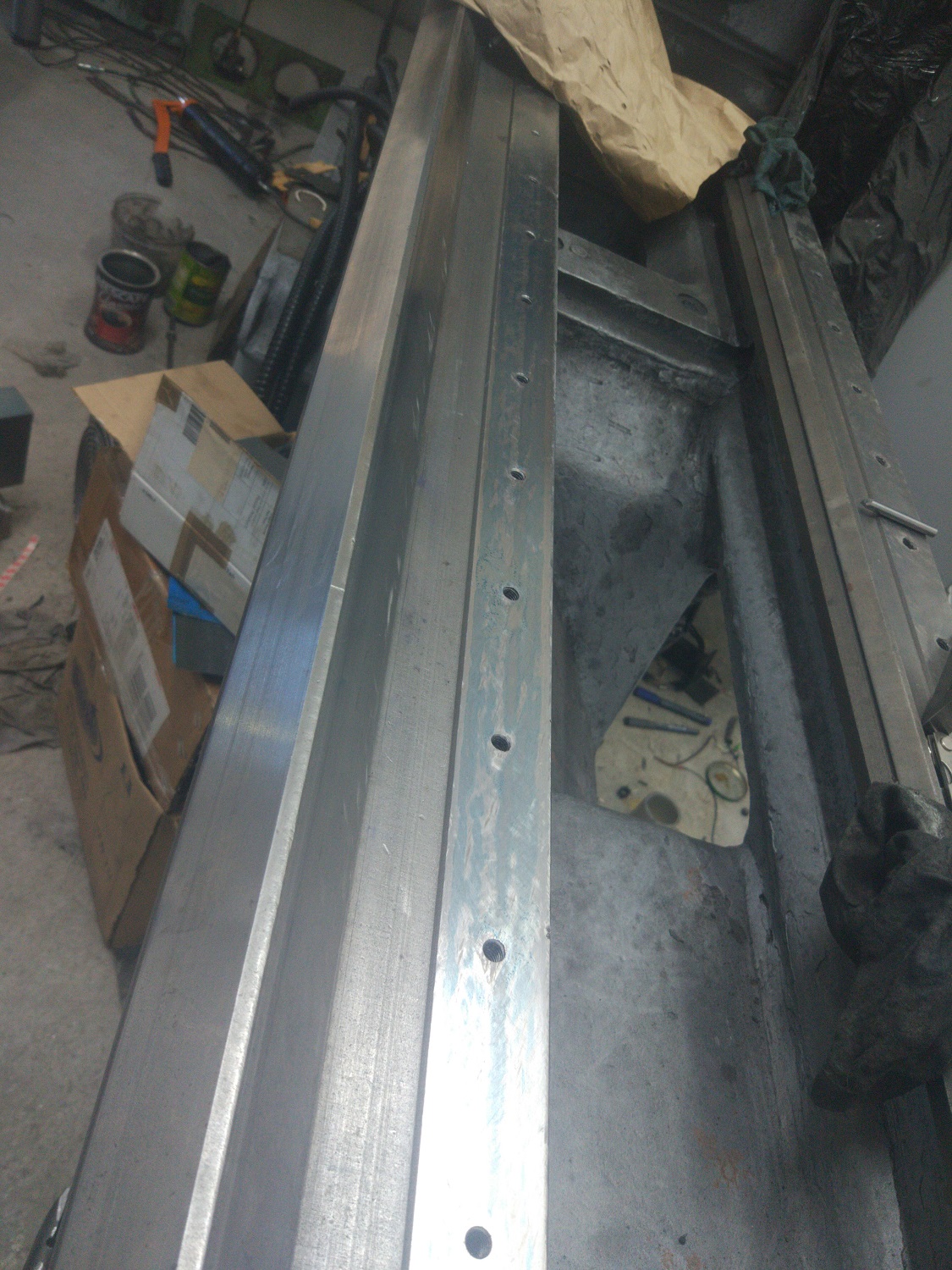

Here I am sanding the back end of the spindle.

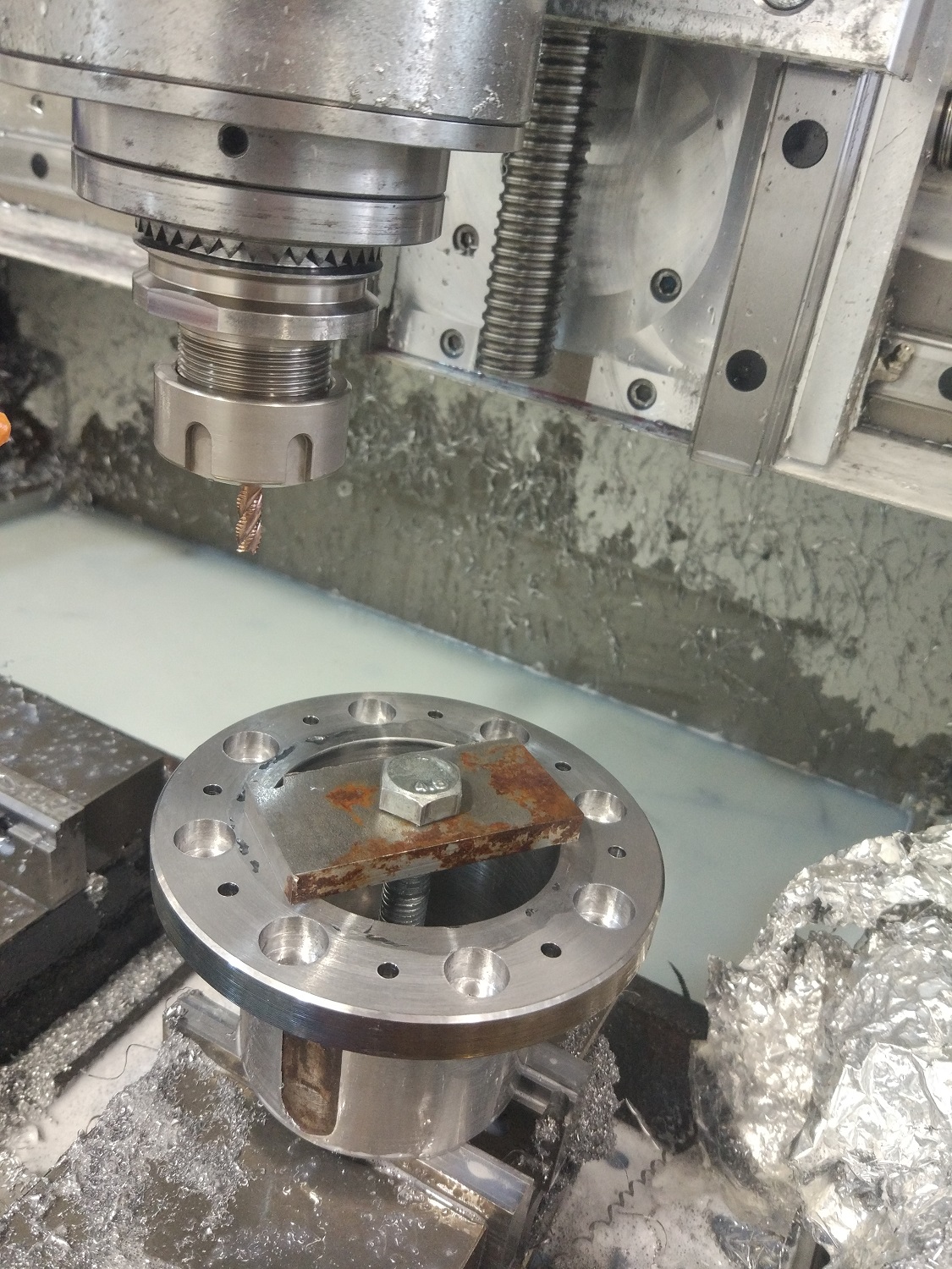

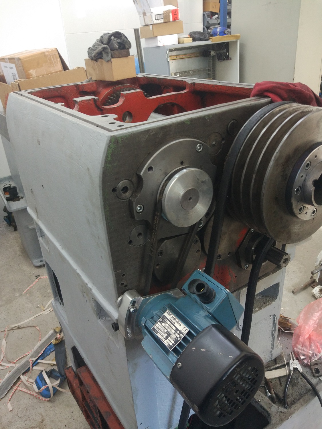

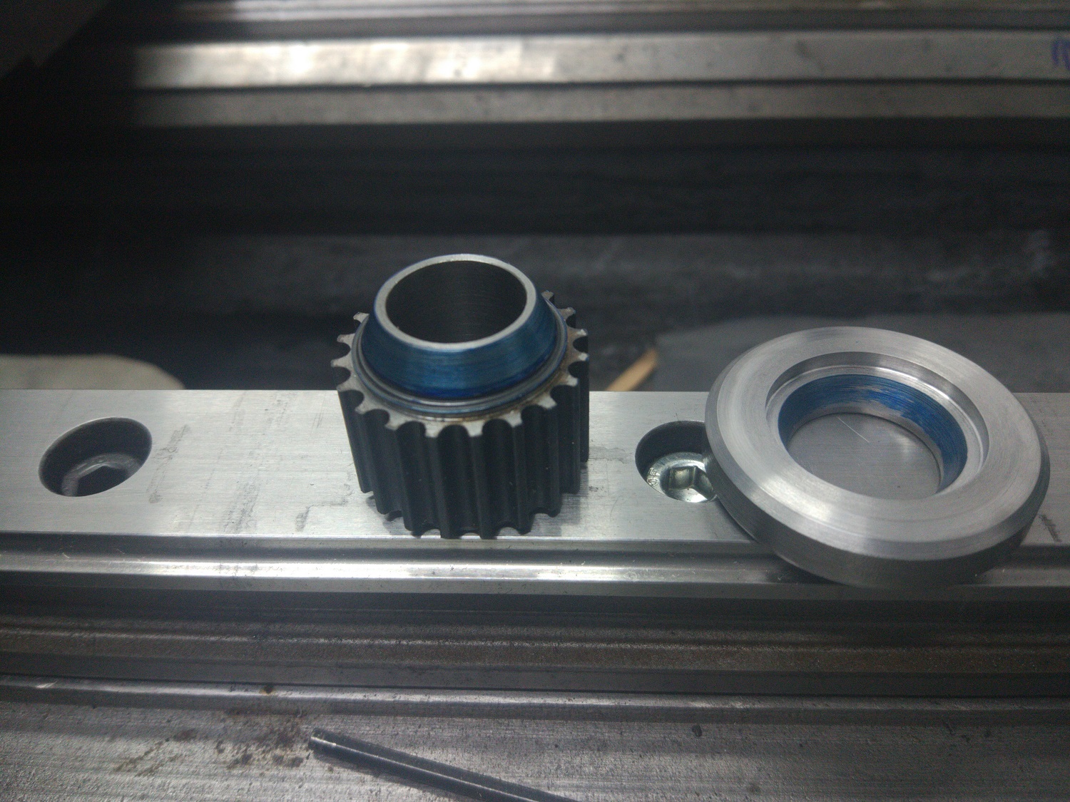

I made two parts that grip the spindle Pulley V-groove .This part has a cone from the outer part, the second part (not in the pictures) presses the first part to the axis of the spindle.

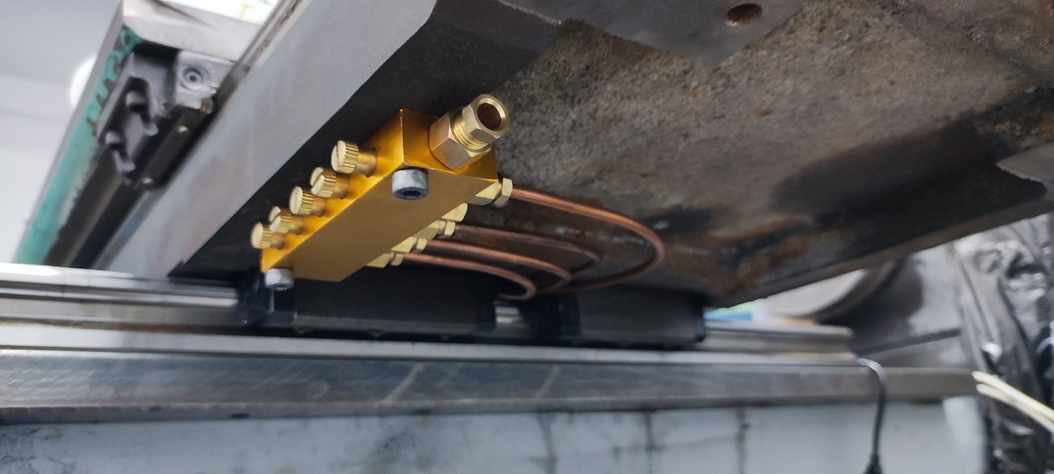

I keep the original oil pump. It was necessary to make several parts.

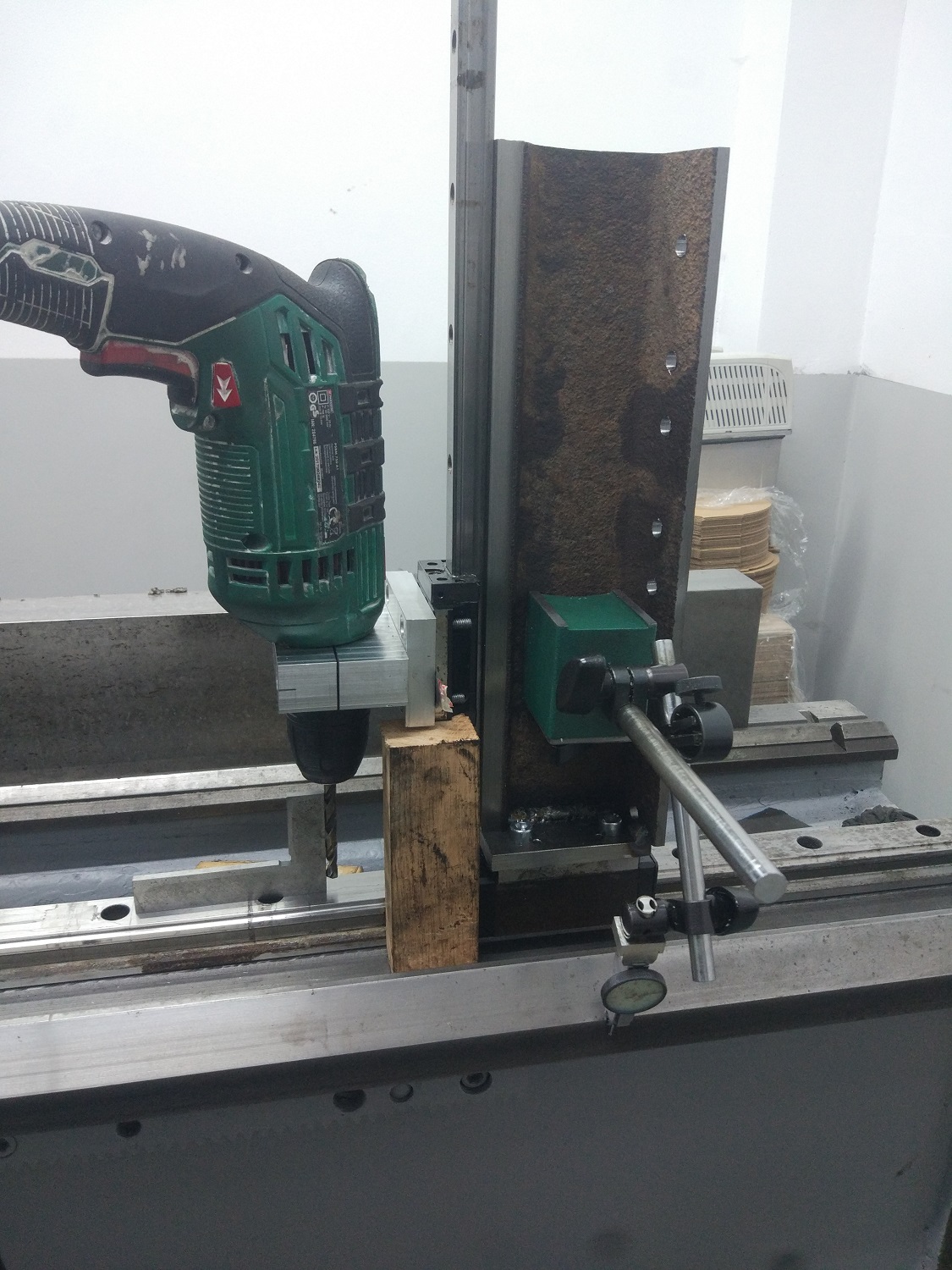

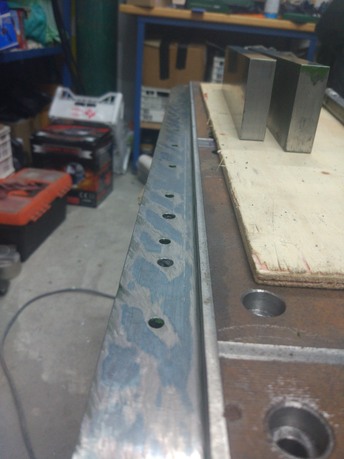

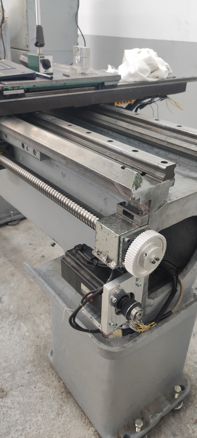

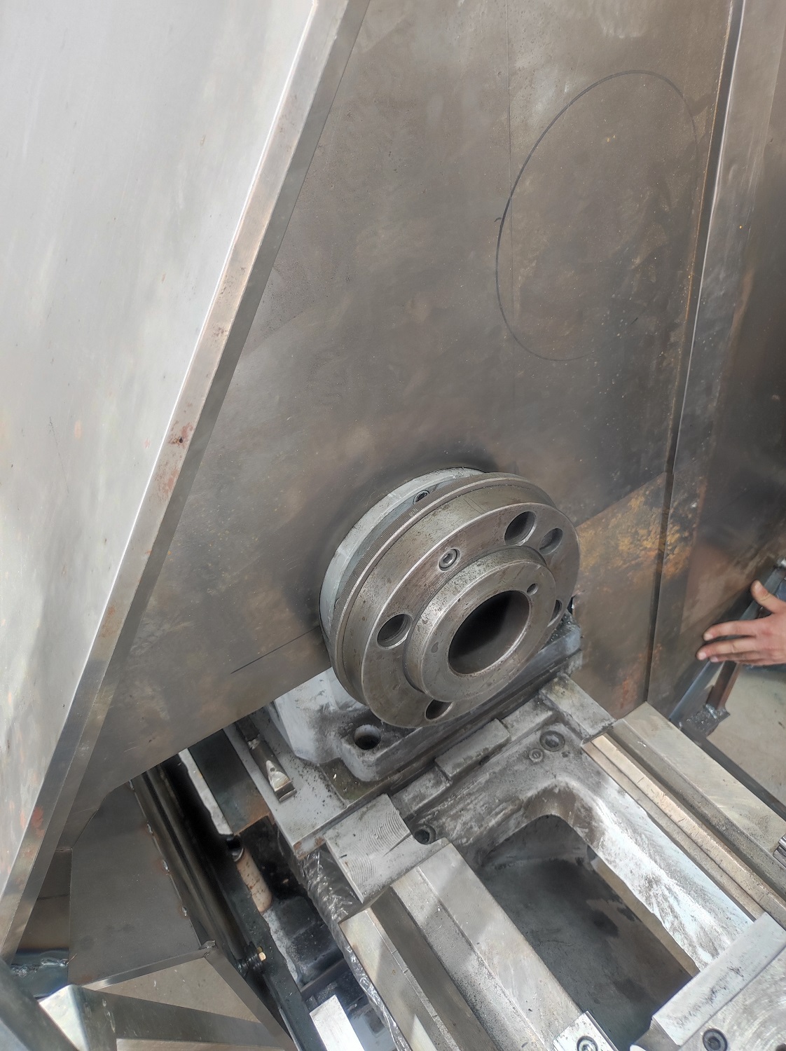

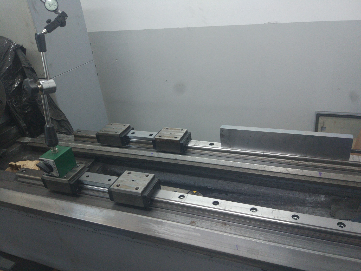

We put linear guides. They had to be level and make holes for threads.

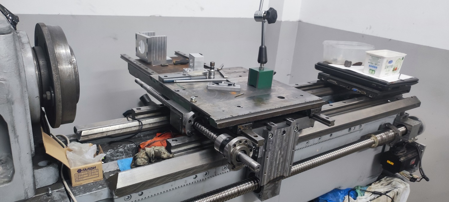

14 May 2024 19:49 #300596
by besriworld
Replied by besriworld on topic OLD Lathe conversion to a CNC
- besriworld
- Posts: 327
- Thank you received: 92
14 May 2024 20:00 #300597
by besriworld

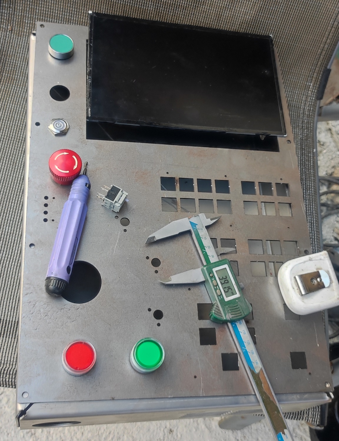

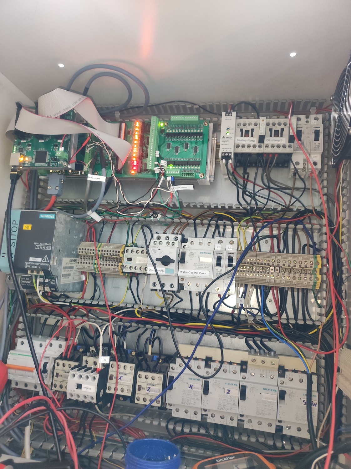

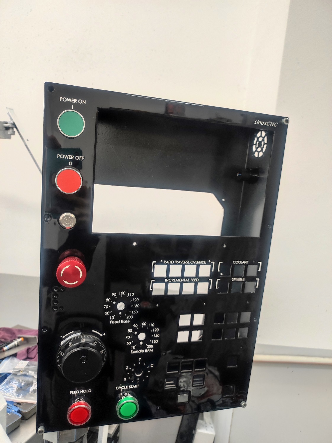

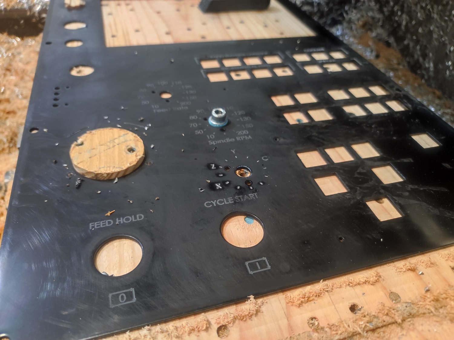

A few more pictures of the control panel.
It's not perfect but I like it
First there is a primer, then a paint base and clear varnish. Then I engraved it on the router. I used a white paint base for filling. But it would be better with a white body filler
Yes, we all seem to have a professional distortions

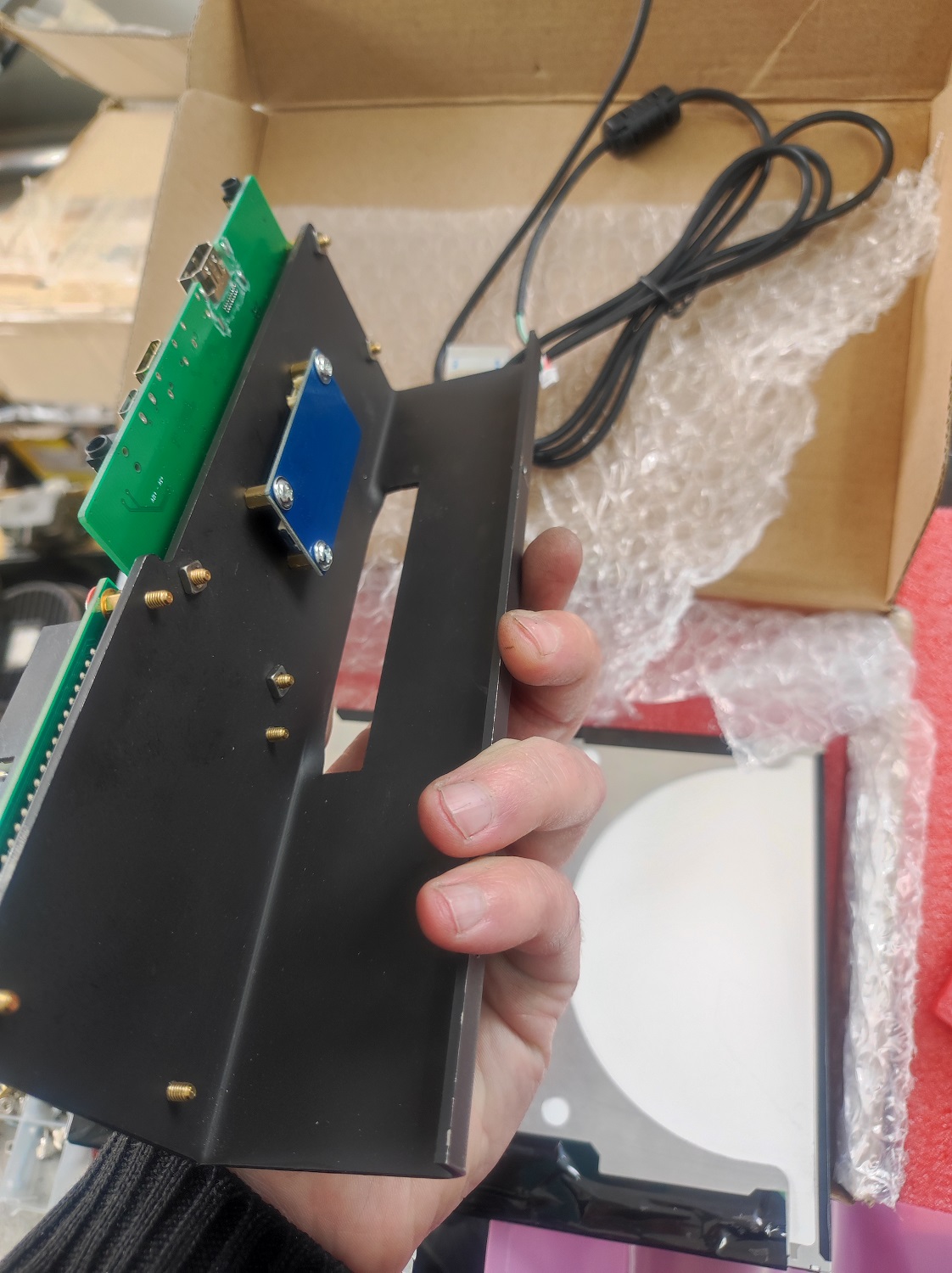

Great project, and nice workmanship! The control panel looks great in the photo!

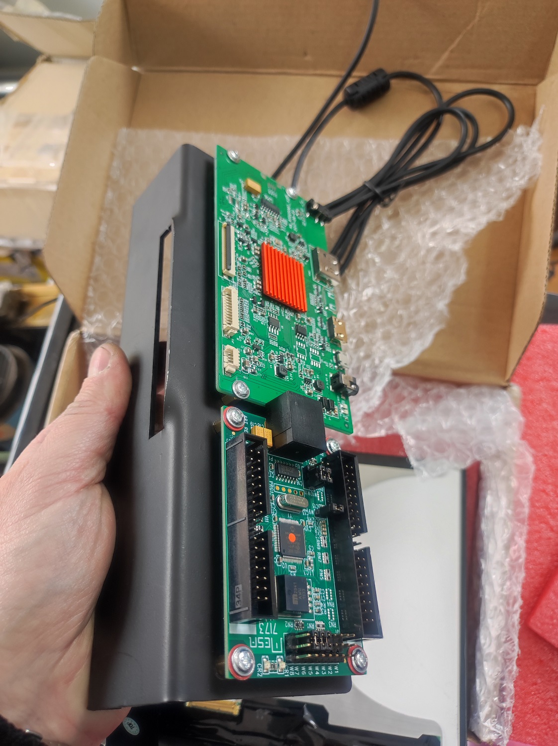

Is the board with the orange heat sink an HDMI to LVDS board for the display?
- besriworld
- Posts: 327
20 May 2024 18:39 #301021
by besriworld
Yes, this is the display board. By modern standards the display is very small 10.1"
with 2k resolution .
