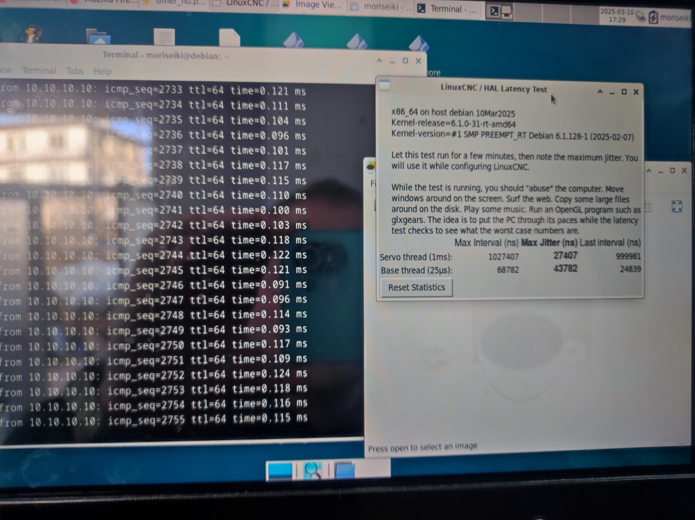

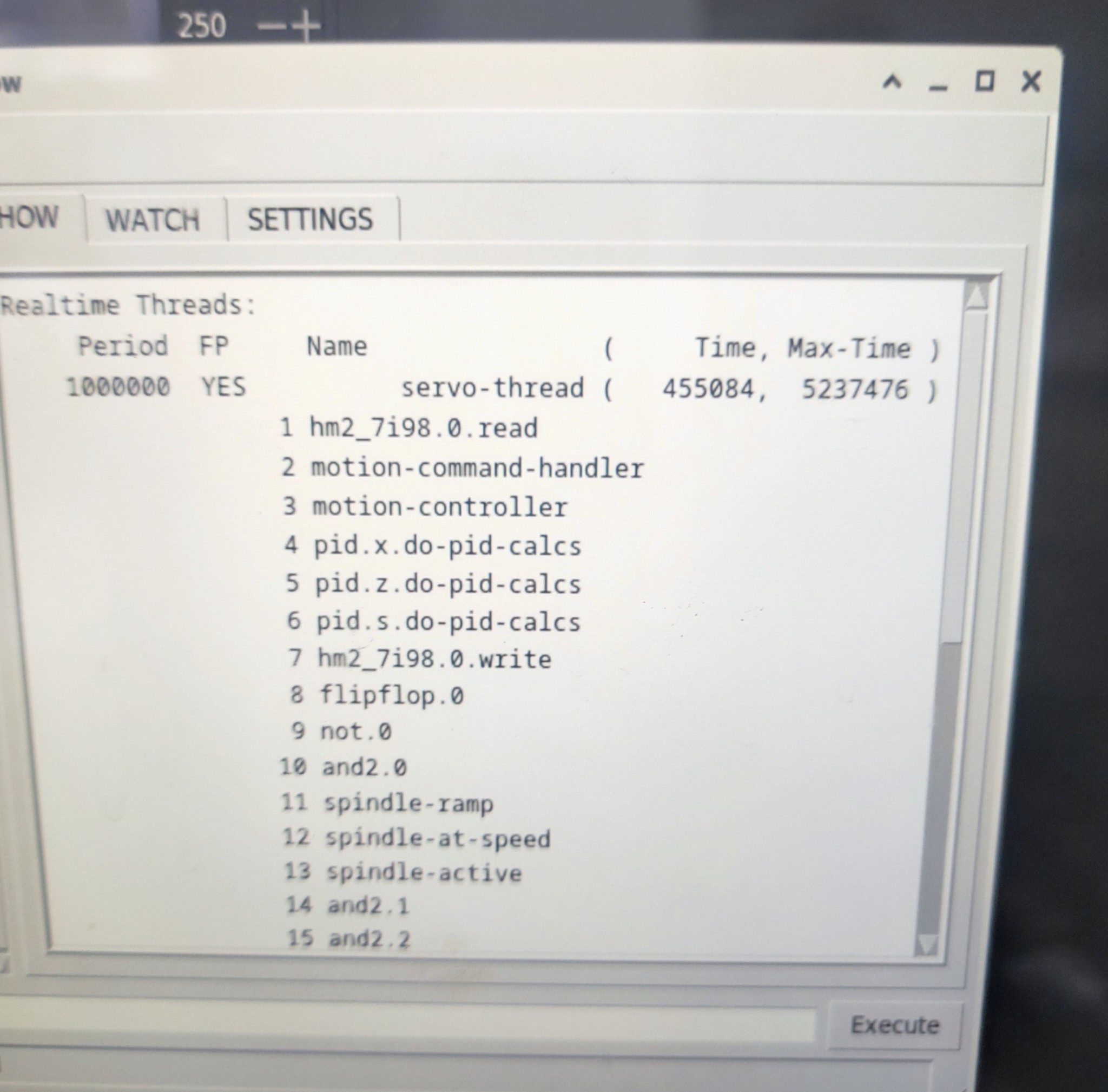

10 Mar 2025 12:34 #323622 by besriworld
Replied by besriworld on topic OLD Lathe conversion to a CNC
I'm getting the error 5 times today.
joint 0 following error
Unexpected realtime delay on task 0 with period 1000000...
Could the delay be due to an electrical noise problem?
10 Mar 2025 13:52 #323623 by PCW
Replied by PCW on topic OLD Lathe conversion to a CNC
What are the results of:
sudo chrt ping -i .001 -q -c 60000 10.10.10.10
(takes 1 minute)
and
lspci | grep -i eth

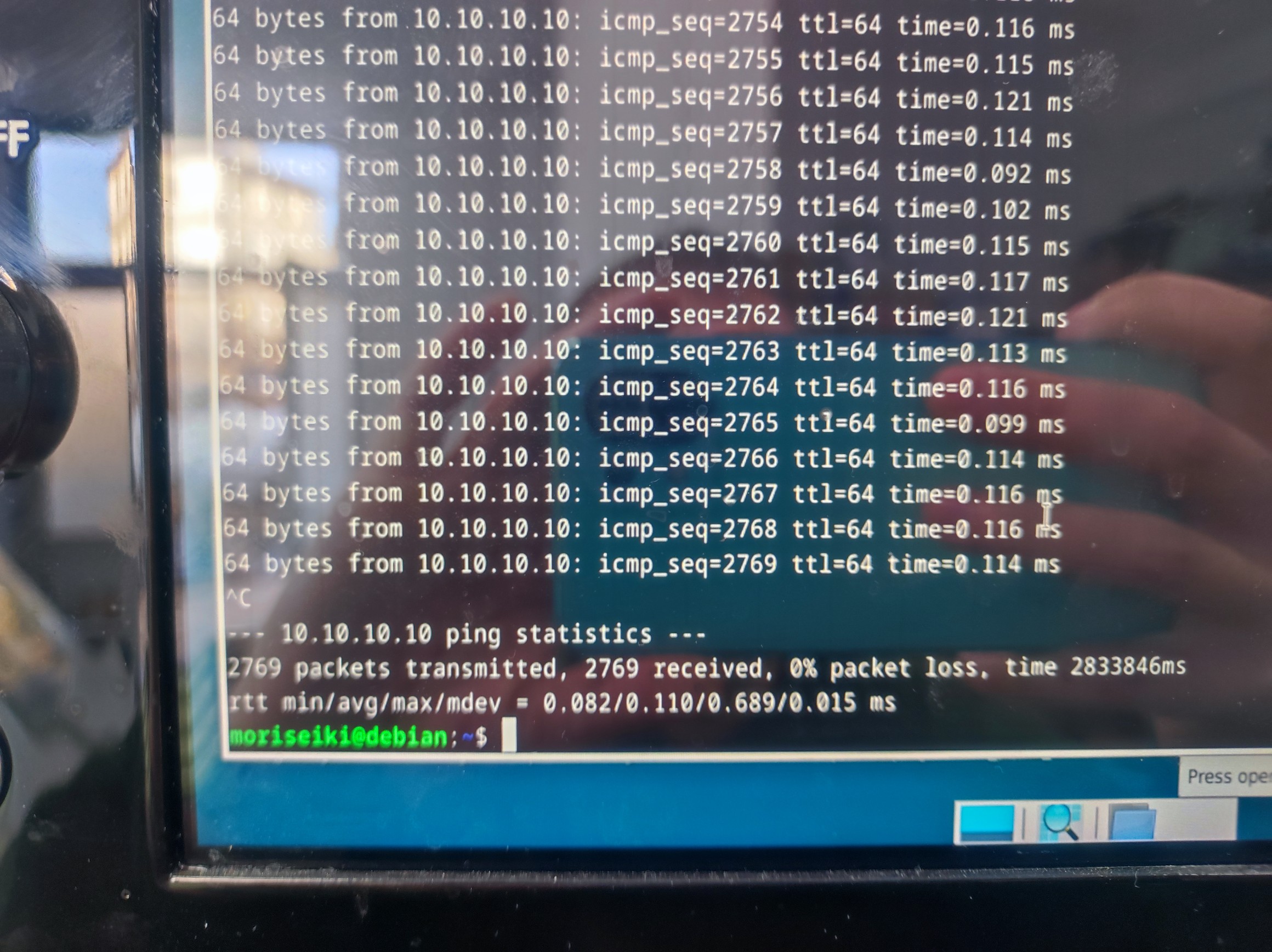

10 Mar 2025 15:19 - 10 Mar 2025 15:20 #323629 by besriworld
Thanks for joining. Here's what it showed.
moriseiki@debian:~$ sudo chrt -f 99 ping -i .001 -q -c 60000 10.10.10.10
PING 10.10.10.10 (10.10.10.10) 56(84) bytes of data.
--- 10.10.10.10 ping statistics ---
60000 packets transmitted, 60000 received, 0% packet loss, time 59999ms
rtt min/avg/max/mdev = 0.065/0.074/0.241/0.007 ms

10 Mar 2025 15:26 #323630 by tommylight
Replied by tommylight on topic OLD Lathe conversion to a CNC
I wonder, why was the kernel not updated for the 2.9.4 ISO????
6.1.n kernel has huge latency and networking issues that are frankly getting to damn tiresome to read about them daily for nearly two years.
I have 6.8.n and 6.10.n on laptops without any issues.

10 Mar 2025 16:11 #323634 by PCW
In the lspci command:
lspci | grep -i eth
The | is a vertical bar character (pipe) not an uppercase i
