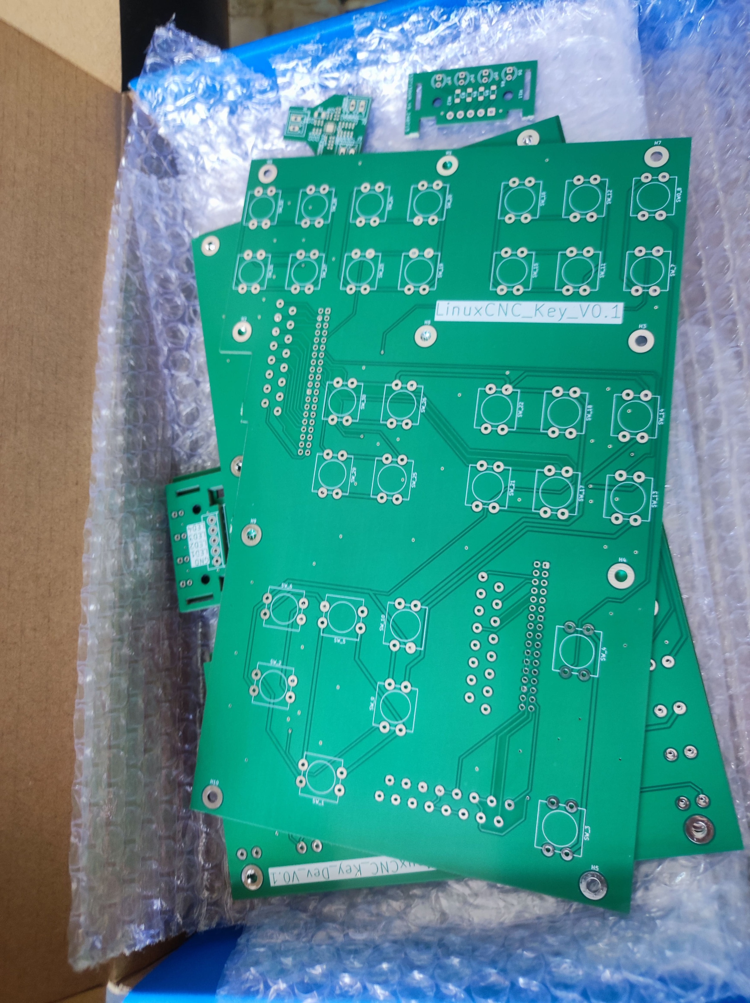

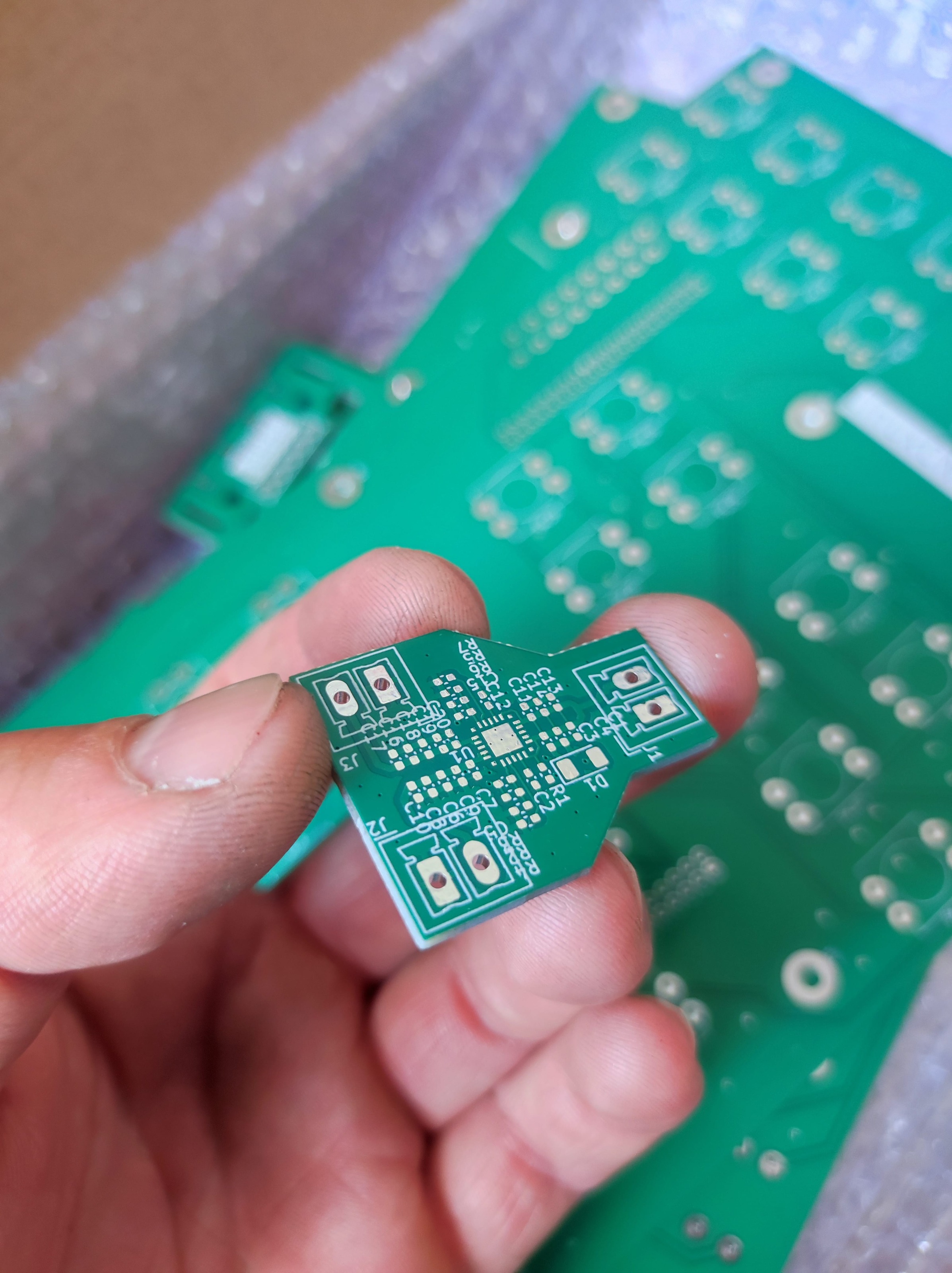

Nice work. What did you use to design and layout the panel PCB?
- besriworld
- Posts: 327
- Thank you received: 92
30 Jul 2024 05:03 #306392
by besriworld
Replied by besriworld on topic OLD Lathe conversion to a CNC
- RotarySMP
- Posts: 1635
- Thank you received: 595
30 Jul 2024 05:14 #306394
by RotarySMP
Replied by RotarySMP on topic OLD Lathe conversion to a CNC
I should have done the same on my last build.

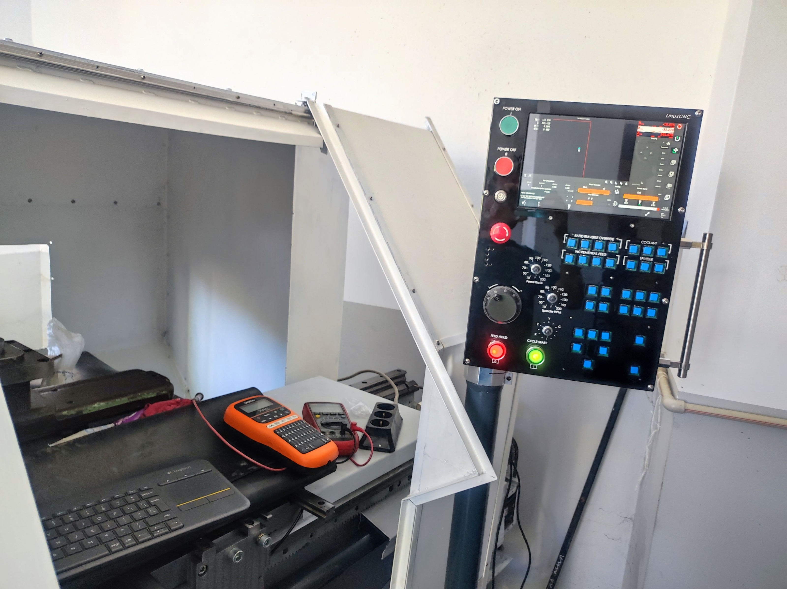

Quick video of the first tests. I'm still learning how to work.

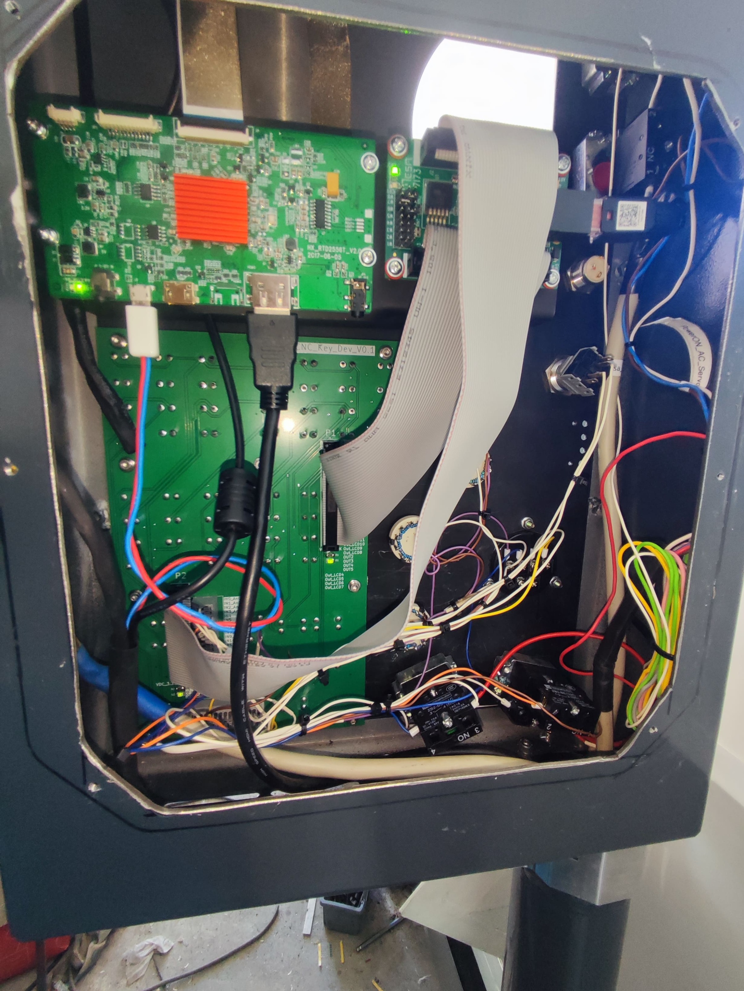

Most likely I also have a problem with electrical noise. When I turn on the lubrication pump of the spindle, the screen flashes (the display is connected with an hdmi cable). Also in two weeks twice lost connection with 7i73
The following user(s) said Thank You: Mecanix
- Posts: 22037
- Thank you received: 7505
12 Aug 2024 11:12 #307559
Replied by tommylight on topic OLD Lathe conversion to a CNC
Find some of those doughnut shaped ferrite rings and wind the pup wires twice through it.
Plenty of those on old equipment.
