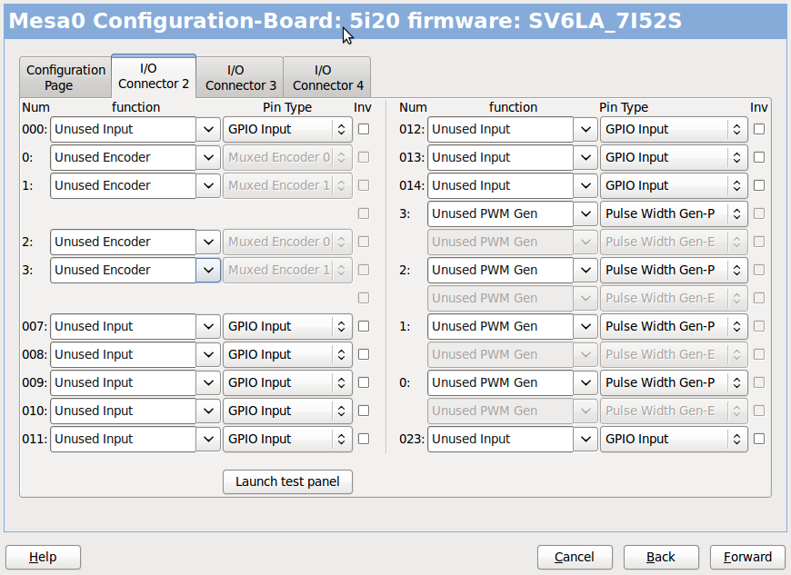

This is part of .xml file for pncconf. This directly match with .PIN configuration. In the attachment I put screenshot of generated I/O configuration for first connector.

Looks like pncconf issue of some kind, but may not actually matter.
have you tested the actual index inputs?
I dont think pncconf can do anything to make them _not_ work
worst case you will have to hand edit the HAL file to connect them
11 Dec 2011 19:22 #15563 by cmorley
Replied by cmorley on topic Re:Mesa 5i20 - All pins at +5V
The short answer is not to worry it should work just fine, just follow the pinout for the daughter board.
longer answer.
The readme shows the pinout for the Mesa MAINBOARD (5i20 in this case) not the daughter board connected to it.
In the muxed encoder case a single mainboard pin does not correspond to a single encoder.
So the readme just tells you the encoder component number in general for the signalname.
Most components that PNCcond configures for have a one to one relationship between the pin and the combobox.
These components such as regular pwm and regular encoders don't necessarily require a daughter board.
others such as mux encoders and resolvers etc require a daughter board and so the one to one relationship sometimes must be ignored.

There is relationship between 7I52S daughter card and I/O Connector 2 Encoder Configuration.I would expect that README document relationship between drop-down selected encoder (i.e. ecoder-x) and 7i52s PIN layout, where encoder is connected to.
encoder-x - P5 PINS 1 QA0, 2 /QA0,3 GND, 4 QB0, 5 /QB0, 6 +5V, 7 IDX0, ....
encoder-y - P5 PINS 9 QA1, 10 /QA1,11 GND, 12 QB1 ...
encoder-z - P4 PINS 1 QA0, 2 /QA0,3 ....
Does this make sense?
Another solution would be just to say that encoder connection should be done according to 7i52s documentation.

The problem comes in that PNCconf has no way to know which or if any daughter board is being used ( in the case of mux encoders we know a daughter board is being used but not which one)
At the moment the read me just tells you what the mainboard connections are.
In the case of mux encoders it tells you that encoder 0 is connected to signal X which could help you with connection
on the daughter board by looking up encoder 0 in the manual and then figuring out which pins connect it.

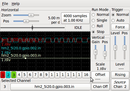

Finally I receive all Mesa boards. As I do not have all servos, I want to try with X-axis only. Connecting encoder to 7I52I connection 0 (rs-422 type) does not update position readout on AXIS display, also monitoring signal x-pos-fb does not show any changes.
Halscope shows correct signals coming in.
Any suggestion?
