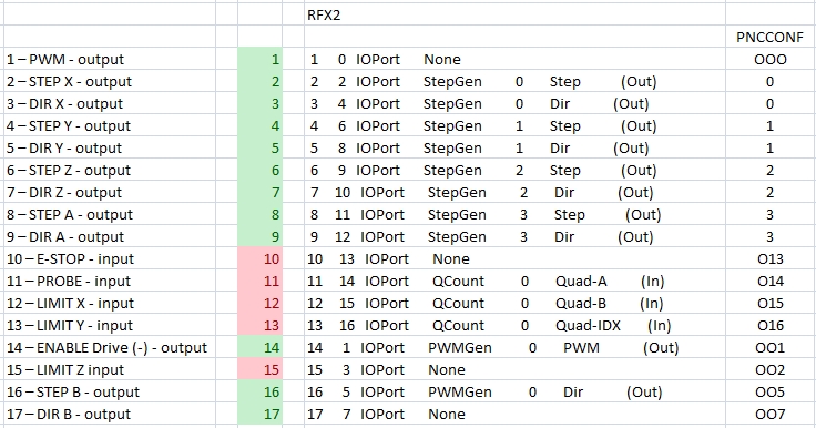

18 Apr 2016 16:08 #73543 by pacman13b
Replied by pacman13b on topic Mesa 5i25 config for chinese BOB
Parallel port BOB is as follows . Pins reflect to parallel port schema..
1 – PWM - output
2 – STEP X - output
3 – DIR X - output
4 – STEP Y - output
5 – DIR Y - output
6 – STEP Z - output
7 – DIR Z - output
8 – STEP A - output
9 – DIR A - output
10 – E-STOP - input
11 – PROBE - input
12 – LIMIT X - input
13 – LIMIT Y - input
14 – ENABLE Drive (-) - output
15 – LIMIT Z input
16 – STEP B - output
17 – DIR B - output
18, 19, 20, 21, 22, 23, 24, 25 – GND
My step / dir & enable drive signals are (-)
5 - AXIS Break out board.
Thank u.

18 Apr 2016 16:38 #73545 by G0G53Z148
Replied by G0G53Z148 on topic Mesa 5i25 config for chinese BOB
Have you copied the Hostmot2 files into the %root% firmware/hm2 directory? this is important
when you start pncconf you have to select the rfx2 firmware in pncconf after flashing the card and press accept
i have no computer here with linuxcnc on it you must a little improve
at the start configurating page of mesacard in pncconf you select 0 encoders then you can use the encoderpins for I/O
only the pwm you must bridge with an adaptor to the cross of the cable
i do not use pwm regulation
and then you canb klick any pins in the dropdown list
this is all i know about this sorry more help i cant give to you
the numbers at last 000: 1: 001: are the digital inside pins this are not the output pins this is important
the grean and red numbers in the pictures should be the Real pin numbers
if you want to have them others you have to seek an coder who makes a custom bitfile
i hope you help this to get it up

20 Apr 2016 18:20 #73657 by pacman13b
hurray...... Got movement on all axes's . Had to dig up and read the manual twice overnight to hook up manually by hand and not with pncconf the gpio to HAL. Anyhow got it all setup switches input - outputs working and motors working with dmm_bb2.bit file.
G0G53Z148 your post really helped me on getting the idea of how to map things out.. thank you.
The only thing I can't bypass and I'mm stuck is when testing for motor movement velocity etc. the motor moves but doesn't stop on time
maybe after a long while it keeps on moving and incrementing speed . can't seem to understand, step drivers are DQ860MA, maybe step time delay?? I tried different numbers up to 5000ms but same issue numbers below 2000ms don't run at all. DataSheet of driver say 2500, so I left it there.
Any ideas has anybody reference this situation.
If I do a motor test inside pcnconf +-50mm goes 50.5xx then it comes back to 50.0 with microsteps and vise versa.
