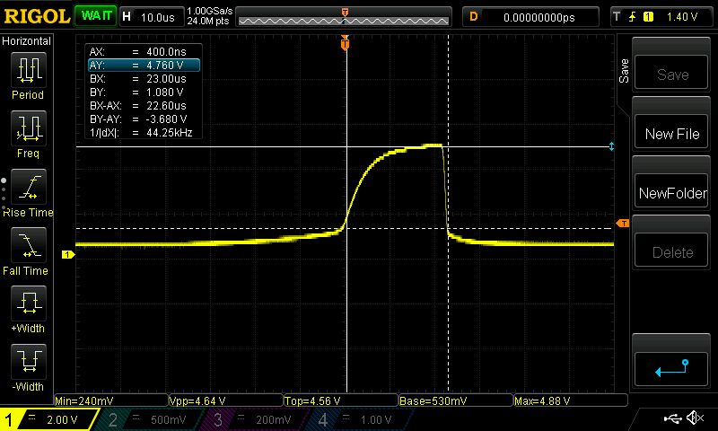

12 May 2018 04:17 - 12 May 2018 04:47 #110592
by BrendaEM
Replied by BrendaEM on topic First Look: Cheap Parallel Port Opto Isolator Board
I am disappointed with the interface card at this point. The card is not doing what it's supposed to.
The instructions are have nice pictures, but the ChinEngrish does not read well.
Looking at the blurry output schematic, it looks like the voltage is pulled up with a resistor, and the opto-coupler pulls it down.
Aside from the rounded corners, I think what's going on is that the resistor pulling the output pins high is too high of a resistance to drive the driver optos. While it has 4+ volts swinging in the breeze, as soon the opto in the front end of the stepper driver sinks some 10 lousy MA, it pulls the voltage down to around 1.7 volts, that is not going to drive the optos in the stepper driver because they have a current limiting resistor, to work with 5 volts.
I suspect that by pulling the jumpers, the optos can be driven by a higher voltage, that might raise it's output, but I will have to drive it at 7 volts to get 5 out. As far as I can tell, the board's output is supposed to be isolate, or they wouldn't have included the jumpers to disconnect the power rails.
I never appreciated the Aduino's outputs until I ran into this thing.
I don't have the resources to come up with my own opto board, but if I did it would have replaceable optos, and good instructions.
I PM'ed some here about the board. I also sent a message to the ebay seller of the board. I figured the seller might want to get involved in this, send me better instructions, you know, to protect his rating : )
This was not the turn-key opto board solution I was looking for.
Last edit: 12 May 2018 04:47 by BrendaEM.
- BrendaEM
- Posts: 266
- Thank you received: 120
12 May 2018 07:37 - 12 May 2018 07:50 #110593
by BrendaEM
I got it working!!!
Low voltage was the problem. I pulled the jumpers from the board, and at first I tried 9 volts. Checking the oscilloscope, the voltage output was over 2 volts. Half of the motor directions worked.
Then, I used a 12 volt power supply, putting a diode in line to cause a voltage drop, dropping to around 11 volts. Now, all the motors and directions work!
Thank you in no particular order: Andypugh, Tommylight, Grotius, Ozzyrob, PCW, Todd Zuercher, and Rodw, others, and for LinuxCNC.
I will shoot some video in the morning.
Last edit: 12 May 2018 07:50 by BrendaEM.
