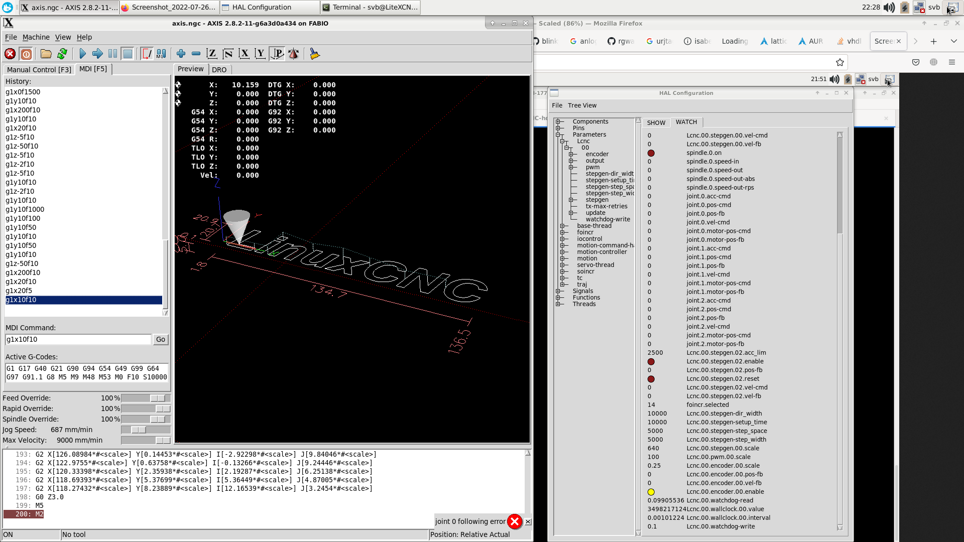

Extremly low speed
I.e. if i set feedrate 5mm/min, and set move to less than 20mm, i'm always arrive to destination (+-0.003mm).
If feedrate greater 5mm/min or distance to go greater 20mm i never arrive to destination. Joint error. Always.
I'm try to change *FERROR parameters but nothing changed :(
This is for stepgen module.
Input worked. BUT! Not reading at start. Im have DCRS-01J rotary switch for setting feedrate as on Siemens MCP, and while im not change switch position, always readed 100%.
I'm try to move config section for my component in any places of a config - nothing happened
Update.
Run G1X10F10 from X20 position
Arrived to 10.159 instead 10.00
Last edit: 26 Jul 2022 19:33 by svb.

About the speed, consider that my approach to stepgen Is velocity only mode, so It accept a velocity command input (and provide the corresponding step frequency on it's pins) and provide internal position feedback based on number of steps emitted.
But you need to provide externally the position control, trough a pid component. Much like a servo.
This way i simplified my work on stepgen validation and pid loops are already available and validated in linuxcnc Hal.
So in summary that depends on you configurazion, I Need some time before arriving where you are with my hardware.
About inputs I'm not sure, are you referring to gpio or encoders?
Encoders are reset when the board Is reset, since in that state the board feedback could not be trustable. Maybe this behavior can be made more smart.

I see that you are using very high settings for stepgen times, step width and space at 5000.
Combined with a scale of 640 pulses per mm this will slow down you maximum speed.
Consider that the times are expressed in microseconds and not nanoseconds, so 5000=5ms.
This parameter Is internally clipped anyway, but maybe you intentions are for lower times.

26 Jul 2022 22:03 - 26 Jul 2022 22:06 #248372 by svb
Yes, i mean 5000ns. Change from 5000 to 5 and WOW!!! It's worked!!!!
Will try on real hardware!
