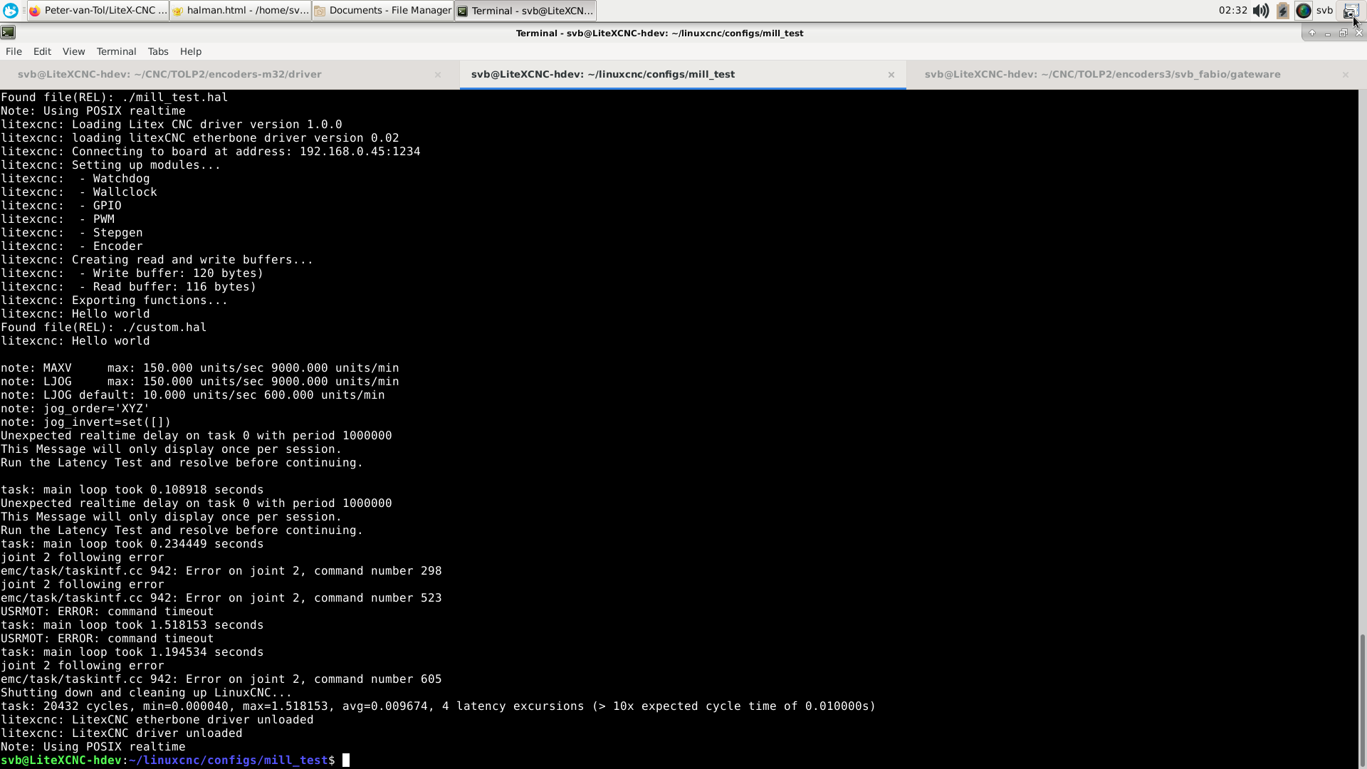

14 Aug 2022 23:50 - 14 Aug 2022 23:55 #249747
by svb
Replied by svb on topic ColorCNC Colorlight 5A-75E/5A-75B as FPGA controller board
With Fabio's driver and firmware everything works fine if there is no ethernet packet loss. More than 4 hours of continuous operation without a single failure. I'm run flood ping to board from 3 terminals and all work fine.
I'm connect motors on Y, and test on real hardware.
From time to time packet's lost (i'm don't know why) and all stopped. But NO MOVING after error!
Last edit: 14 Aug 2022 23:55 by svb.

15 Aug 2022 06:01 - 15 Aug 2022 06:05 #249755
by romanetz
Replied by romanetz on topic ColorCNC Colorlight 5A-75E/5A-75B as FPGA controller board
Can you point to these versions?
Standard behaviour of of-the-shelf products is to ignore packet loss until timeout has been occured. Loss of packet must only be counted for link quality metering.
