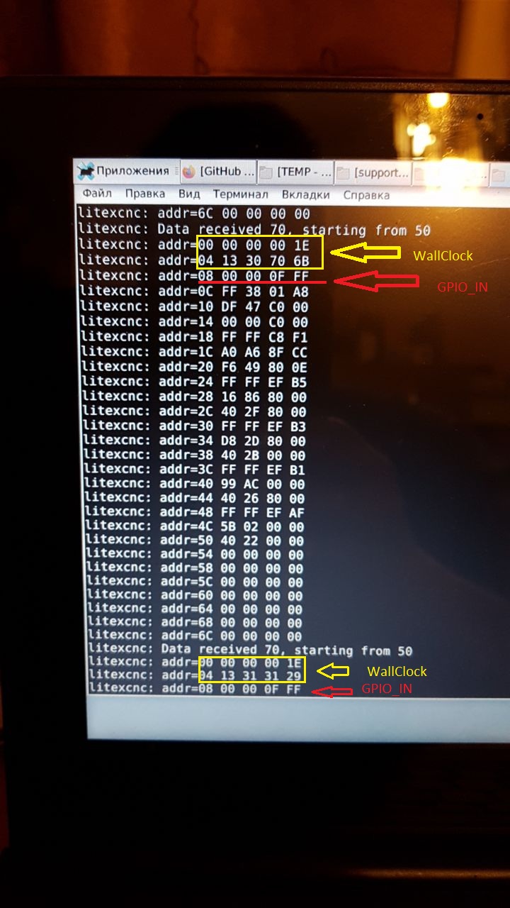

I found a bug in the register reading function from the FPGA.
In driver package has structure: Watchdog (32),WallClock(64),GPIO_IN(32), .......
In reality, there is no Watchdog in the package.
The starting address of the read buffer is shifted by the size of Watchdog (32), which leads to errors described by me and SVB.
P/S: Peter, you can post an example of how to use litexcnc_debug, now I have added the debug info to litexcnc.c.

12 Aug 2022 21:17 #249623
by TOLP2
Replied by TOLP2 on topic ColorCNC Colorlight 5A-75E/5A-75B as FPGA controller board
Which method did you use to print this out?
To check whether the watchdog data is missing or the datastream is mis-aligned I would like to have your configuration.
I'm very keen on solving this problem. With the data from svb I've verified so far:
- it is not due to an error in the driver (I replaced the driver and it still worked)
- it is not due to an error in the HAL-file (his HAL-file works with my card).
Other words: I was not able to reproduce the error. Next step is to verify the firmware. Somewhere something has changed, now to find where. Thanks a lot for the lead to look.

Peter!
i find an error occurred in the size calculation.
The value is 4 bytes larger than it should be. This results in a shift of one register when reading from the FPGA.
file stepgen.h (137)
#define LITEXCNC_BOARD_STEPGEN_DATA_WRITE_SIZE(litexcnc) ((litexcnc->stepgen.num_instances?sizeof(litexcnc_stepgen_general_write_data_t):0) + LITEXCNC_STEPGEN_INSTANCE_WRITE_DATA_SIZE*litexcnc->stepgen.num_instances)
