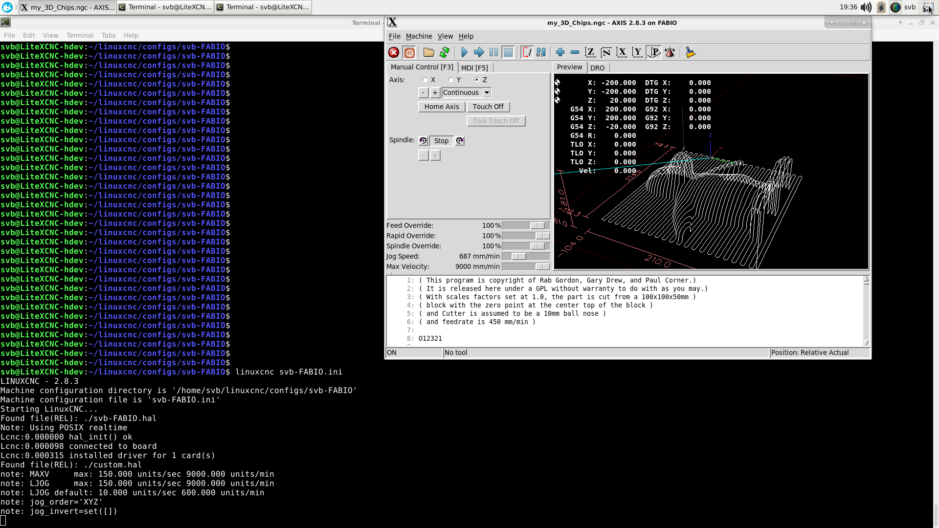

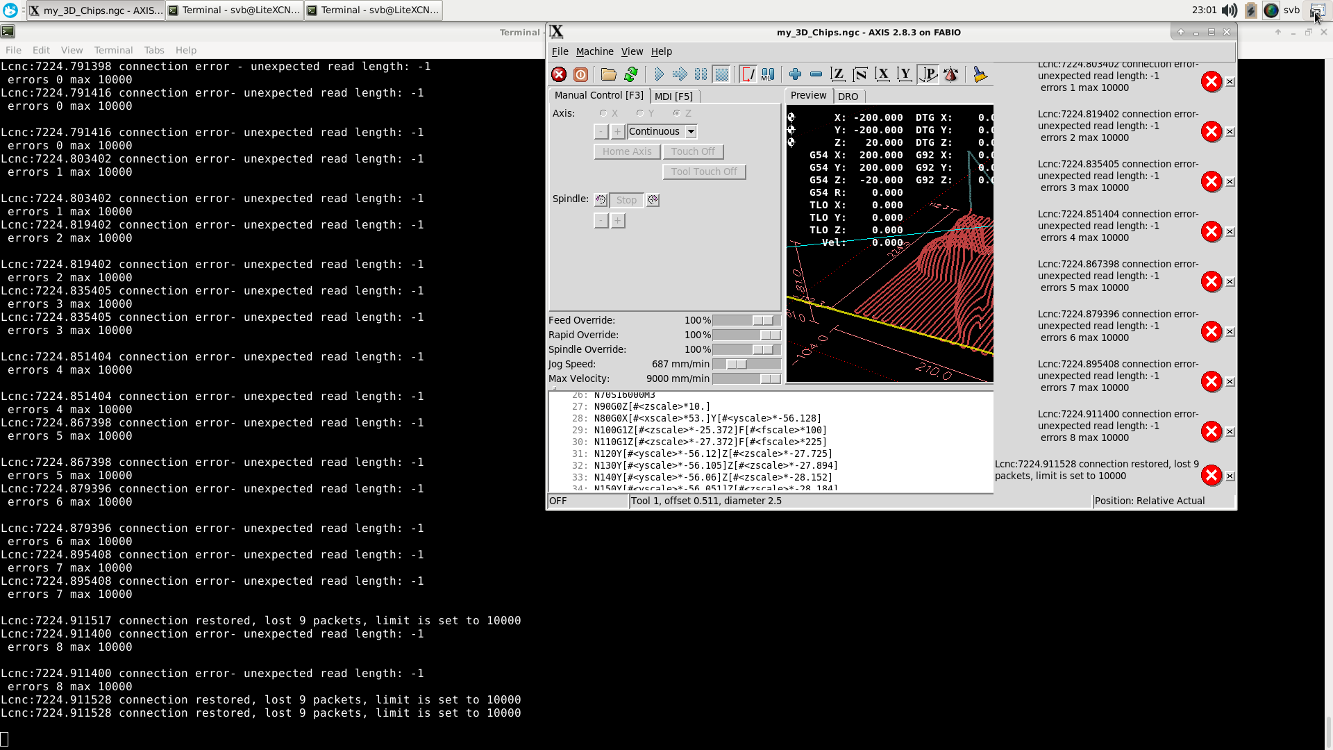

- svb
- Posts: 44
- Thank you received: 10
23 Aug 2022 18:52 #250276
by svb
Replied by svb on topic ColorCNC Colorlight 5A-75E/5A-75B as FPGA controller board
Hello Fabio.
I'm so sorry but with your config's maximum working time before error only 25 minutes. With my config's this time more than 4hours
- muvideo
- Posts: 62
- Thank you received: 30
24 Aug 2022 14:03 - 24 Aug 2022 14:05 #250325
by muvideo
I found a mistake in my handling of incoming data: in case I had a receive timeout I keep reading data, also if they are garbled.
This results in joint following errors in case of packet loss.
I've updated the git repository with a fix, I also made some small changes in error messaging.
Can you try last version of driver github.com/faeboli/Lcnc ?
If it behaves better, you can change the tx_retry parameter back to some sensible number, depending on your link robustness.
I'm working with 5, but you have to monitor number of "normal" packets loss you see in your setup and use a value reasonably higher, in order to not have an error in normal use, but be sure that in case of a big link disconnection you are notified.
Please let me know what changes you will notice in behavior.
Fabio
Replied by muvideo on topic ColorCNC Colorlight 5A-75E/5A-75B as FPGA controller board
Hello Fabio.
Fabio
Last edit: 24 Aug 2022 14:05 by muvideo.
The following user(s) said Thank You: svb
- svb
- Posts: 44
25 Aug 2022 20:06 - 25 Aug 2022 20:08 #250443
by svb
Hello Fabio.
Try new version.
After first error machine go to OFF state.
All errors after first is a in IDLE mode (Machine OFF)
Try new version.
Last edit: 25 Aug 2022 20:08 by svb.
