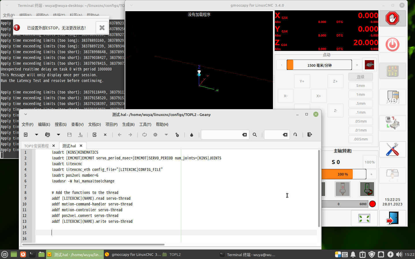

The above gui shows that external estop is enabled, and I have minimized hal
