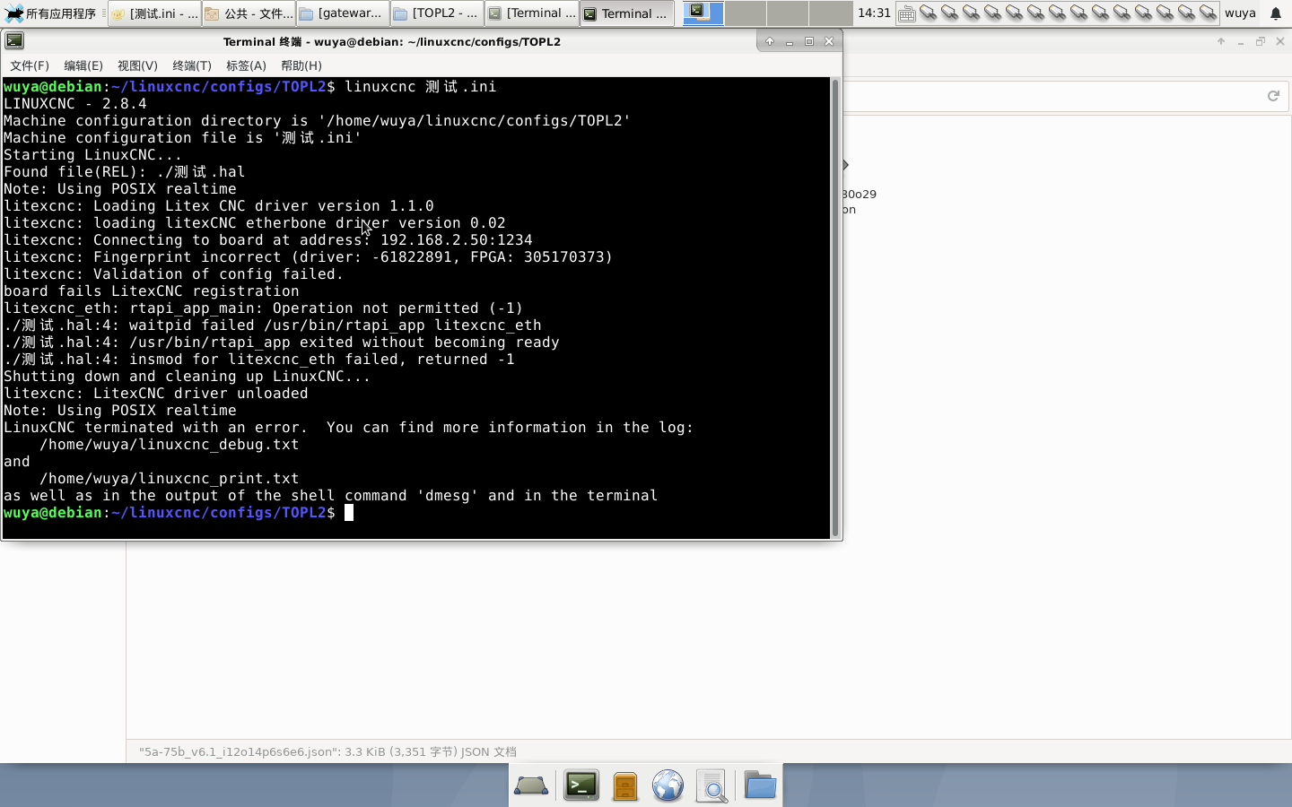

24 Jan 2023 06:40 #262801 by wuyatom
  What is the reason for this? The first time you brush the firmware, you can connect the board, and the linuxcnc can also display it. After the linuxcnc is closed, the connection will be like this
24 Jan 2023 11:03 #262808 by wzor
Have you tried naming a hal file in English?
25 Jan 2023 08:43 #262863 by TOLP2
The error you get is that the checksum of the board is different from the checksum of the config-file. Could you please verify:
  • you did not change the JSON-file after compiling the firmware?
    As even changing the name or changing a line ending will lead to different CRC checksum, changing names requires recompilation. Maybe something went wrong while copying the file. You can check the check-sum your self with an online CRC calculator. When compiling the driver it will also show you the calculated CRC which is stored on the board.
  • if JSON unchanged, do you use other then UTF-8 characters?
    I didn't test it with extended character sets (i.e. UTF-16 etc.). These files might mess things up due to a BOM being present, which might be not read with Python, but are picked up by the driver.
