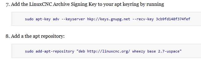

31 Oct 2022 15:57 #255580
by rubes
Replied by rubes on topic trying to decide...wait for new 7i76E or get 7i96S
OK...thanx guys appreciate the help. This is way more Linux than I ever expected to get into, but maybe not a bad thing.
so if I understand this correctly I use the instructions in that first link, but add the repository in the second link?
because step 8 in the first link points to a 2.7 repository (see attached screenshot).
also step seven references a signing key (see same screenshot)...would it work on the diffrerent repository?
So sorry for all the dumb questions.

- Posts: 19899
31 Oct 2022 16:26 #255582
Replied by andypugh on topic trying to decide...wait for new 7i76E or get 7i96S
The key is the same for all sections of the LinuxCNC repository
You might end up with Wheezy / Preempt-RT / LinuxCNC-uspace-2.7.14 at the end of that process, but can then re-do the update to 2.8.4
