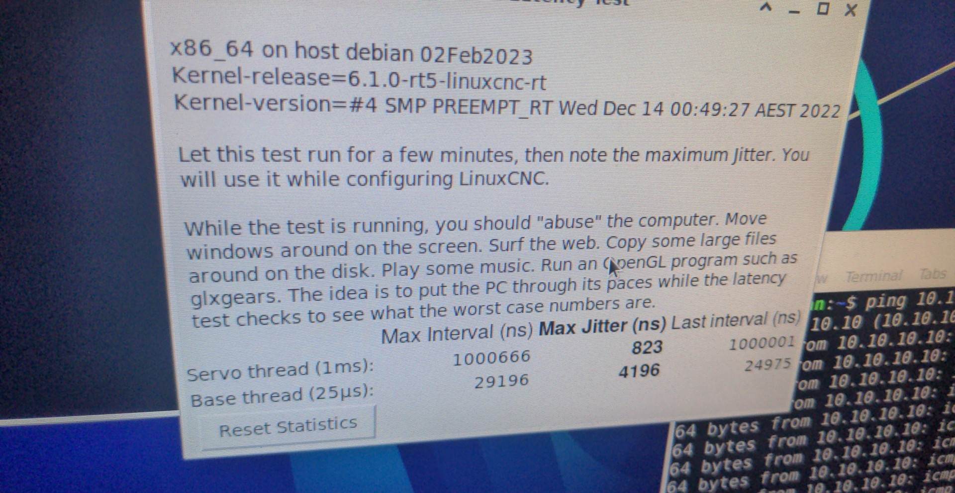

02 Feb 2023 17:29 #263536
by CADdy
Replied by CADdy on topic Error message during operation with a 7i96s
Rod, thank you so much. I've now installed the 6.1 PREEMPT Kernel. LCCNC is running about 3 1/2 hours without errors. Let's see what happens overnight.
Peter
Peter
- Posts: 12156
- Thank you received: 4149
02 Feb 2023 23:21 #263554
Replied by rodw on topic Error message during operation with a 7i96s
Here is hoping. I helped a mate last night with similar issues and despite having hands down the best latency ever, still failed with an error finishing read with my kernel buildRod, thank you so much. I've now installed the 6.1 PREEMPT Kernel. LCCNC is running about 3 1/2 hours without errors. Let's see what happens overnight.

- Posts: 18093
- Thank you received: 5325
03 Feb 2023 00:08 #263560
Replied by PCW on topic Error message during operation with a 7i96s
What hardware?
What are the ping times?
(These give a clue if the basic networking options are setup correctly
or if management functions in the BIOS like AMT are interfering)
