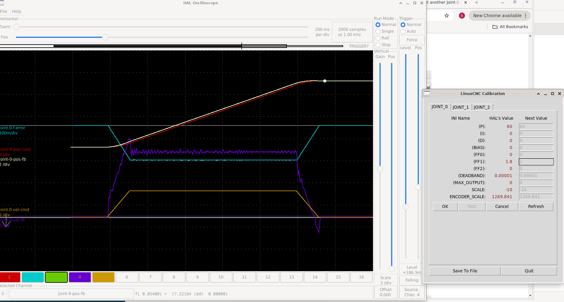

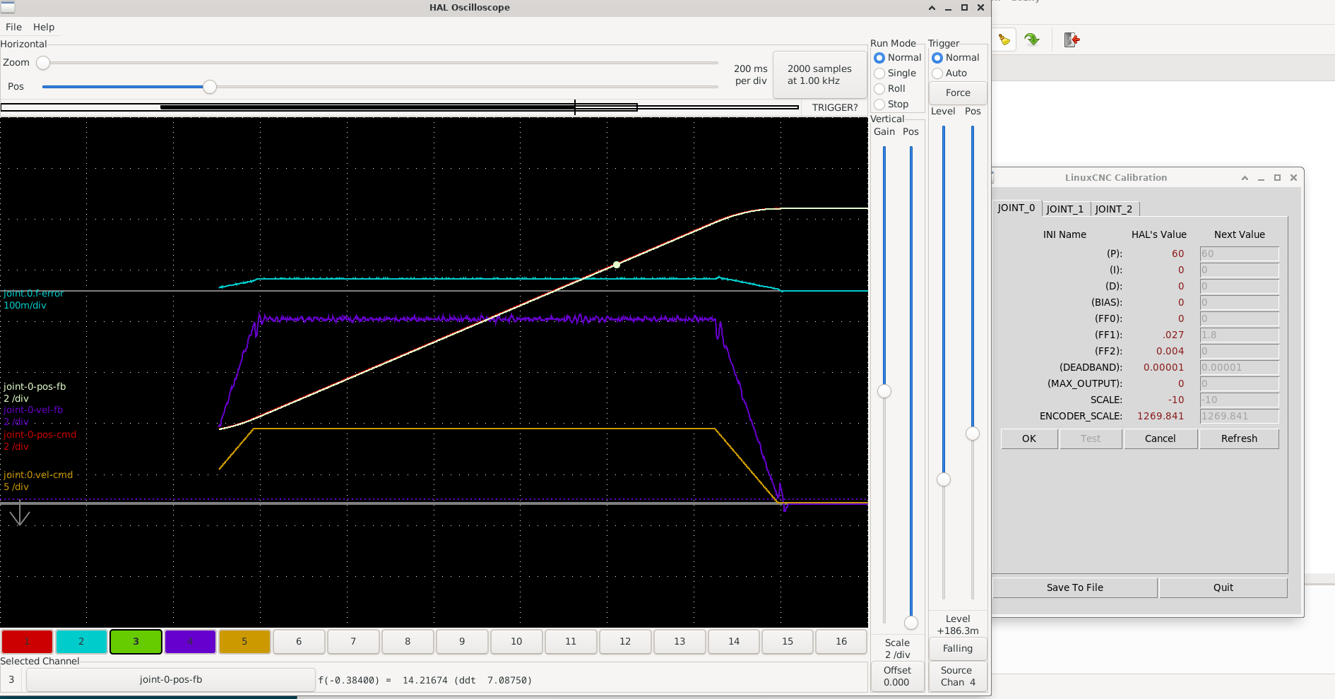

09 Jul 2025 14:39 #331575
by gwond
Replied by gwond on topic Koike Aronson Plasma Conversion - sanity check on Mesa board selection?
Getting back to this project. Servo enables are working now, and started the drive tuning. Was wondering if someone could take a look at the attached images and provide any recommendations. Drives are moving smoothly with the tuning parameters, but wondering if there is further improvement to be made in the servo tuning. I also have an issue where the torch enable signal is being sent all the time. I have not fully debugged this yet in the wiring, but any suggestions on if there is a configuration issue that could cause this? The LED on the SSR on the board does light up when the torch pulse is toggled to on.
Without FF1/FF2 Tuning:
With FF1/FF2 Tuning:

09 Jul 2025 15:00 #331576
Replied by PCW on topic Koike Aronson Plasma Conversion - sanity check on Mesa board selection?
FF1 can be tuned further to flatten the ferror plot
Once this is done, you can usually add some I term
If a SSR seems on all the time, it may be that you have the polarity backwards

09 Jul 2025 16:01 #331581
by gwond
Thanks for the quick reply. I've been referencing the servo tuning guides, which have been helpful. Would you go higher or lower on FF1 and how do you best determine if the f-error is at an acceptable level? The drives move smoothly, but unsure how much more tuning is needed.
For the polarity issue, would that be in the wiring, swap terminals at the board?

09 Jul 2025 17:36 - 09 Jul 2025 17:57 #331588
If the ferror is in the opposite direction of the velocity plot, FF1 is too high (first plot, FF1 = 1.8 is too high)
If the ferror is in the same direction of the velocity plot, FF1 is too low (second plot, FF1 = .027 is too low)
On the polarity, it should be checked with a voltmeter and the most positive lead goes to the OUT+ pin.
