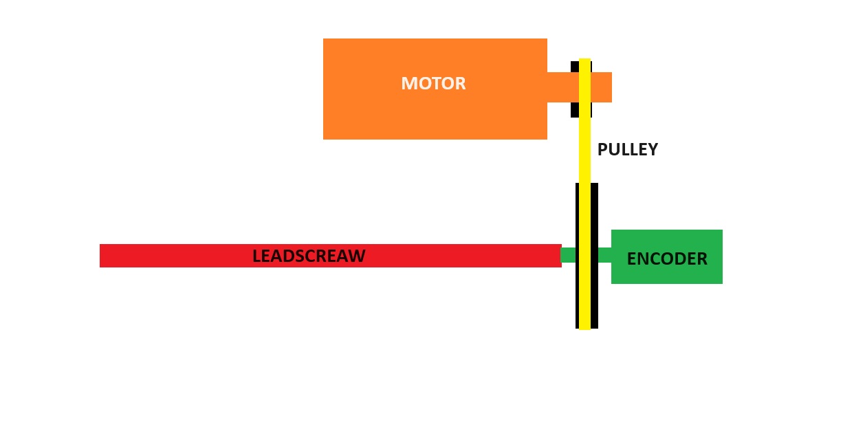

My setup is as follows:
Motor 1600 rpm - 10V anlog
pulley ratio: 14/28 = 0.5
leadscreaw pitch = 10 mm/turn
Encoder : 2500 PPR
Encoder : 2500 PPR

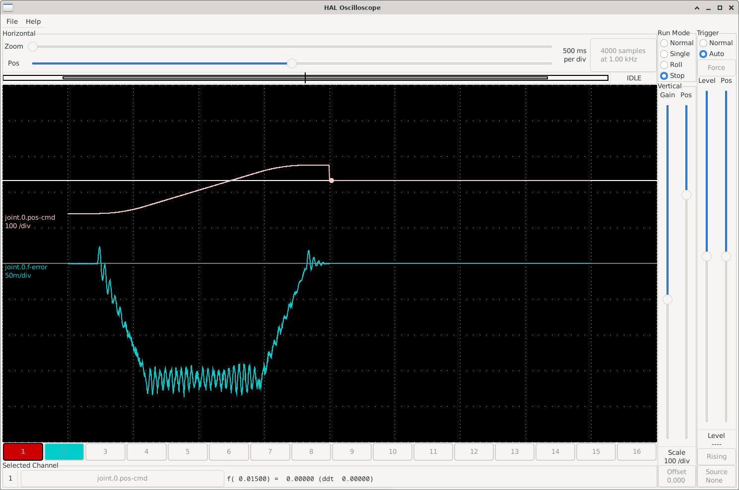

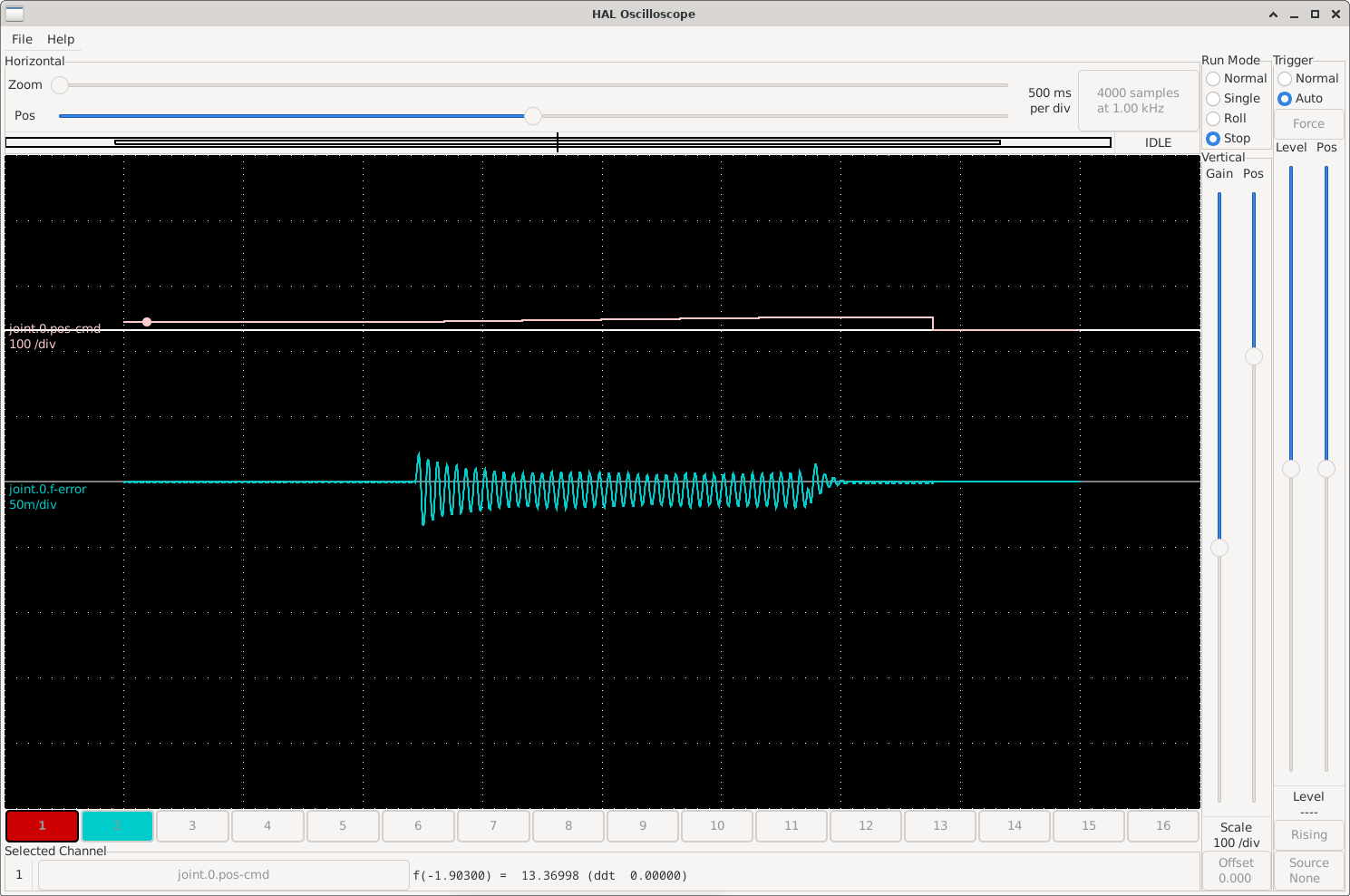

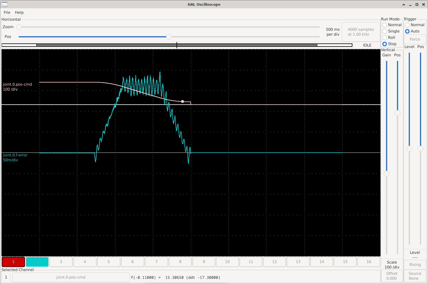

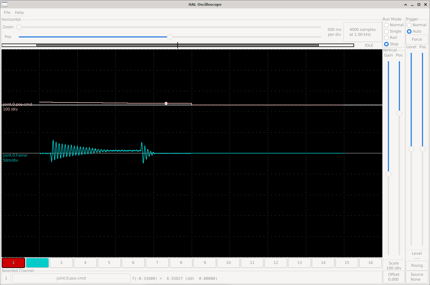

26 Aug 2024 18:22 - 26 Aug 2024 18:24 #308726
by greg23_78
Replied by greg23_78 on topic Driver NUM GEC MK2S
Thanks, the axes move perfectly!
I've just set the PID parameters for my axes.
i'd like to know if bounces are ok or should i have as few as possible?
because the procedure is very well written, except that it doesn't specify what scale to stop at.
At 50 mv/div, are bounces negligible?
the images are relative to my X axis (with the turret), which is why there are more bounces when drawing. Im actualy at P=125 and F1=1
Slow speed UP (134 mm/min)
Slow speed DOWN (134 mm/min)
High speed UP (7127mm/min)
High speed DOWN (7127 mm/min)
