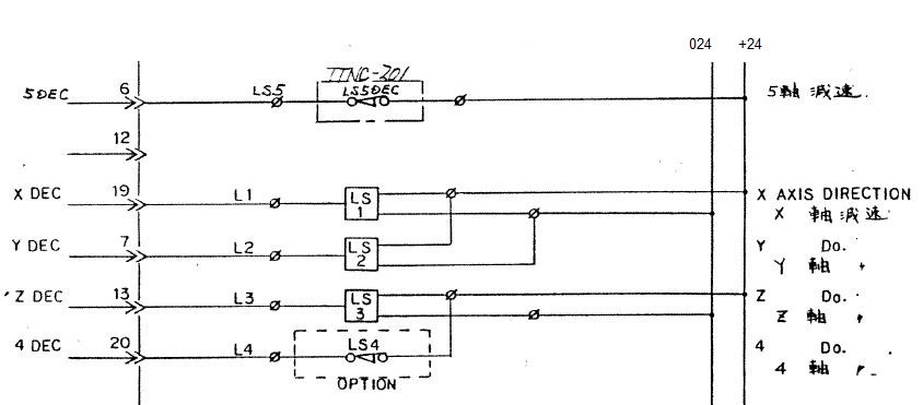

The good news is I finally found a wiring diagram for the limit/homing switches
The bad news is I don't understand how the control can tell if the machine is near home and slow down and stop at the right point from what appears to be only one wire from each axis.
Could it be that maybe it has three voltage outputs 0,24 and something in between?

12 Sep 2011 20:27 #13140 by BigJohnT
Replied by BigJohnT on topic Re:Mori MVJR Build Log
For homing you approach the home switch and one velocity (faster than a snail but not so fast that you damage something) and when found normally back off the switch till it changes states then go again to the home switch at a slower velocity (one that gives you the accuracy you want.
John
12 Sep 2011 21:20 #13144 by clkeck1
Replied by clkeck1 on topic Re:Mori MVJR Build Log
Jon
The Dec switch shown there in the diagram are proximity switches. Im not sure how well they will work for a accurate homing switch.
There are limit switches tied to the estop circuit you could posibly use.
Cory

13 Sep 2011 07:06 #13151 by schmidtmotorworks
Replied by schmidtmotorworks on topic Re:Mori MVJR Build Log
clkeck1 wrote:
Jon
Cory
OK thanks, thanks to wiki now I know what a proximity sensor is.
en.wikipedia.org/wiki/Proximity_sensor
That must be what tells the machine to slow down for the final homing.
So I think what I have to do now is figure out what wires to each of the proximity and limit switches and then figure out what to do in HAL.
I think there is just one proximity and one limit switch for each axis on my machine, not sure about that yet.
Thanks for the help.
