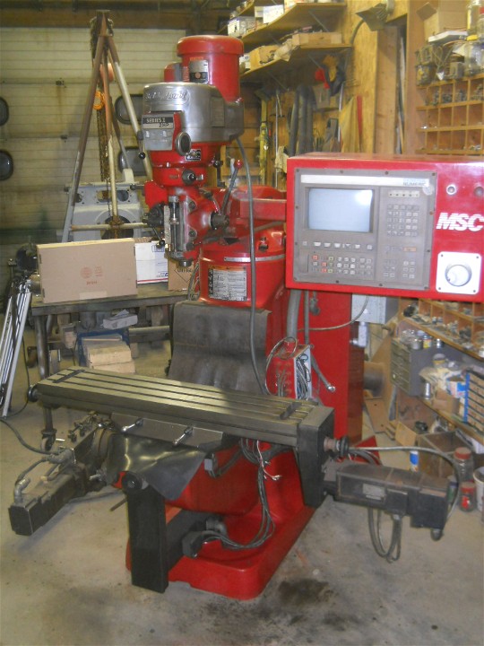

21 Dec 2011 00:39 - 21 Dec 2011 00:42 #15916 by robh
check attached file
what i helped john out when we was playing with his machine
i think some where i haev a written out more detailed whats what, but i think image will speak for its self..
hope it helps
Edit, forum did not let me attach PDF so uploaded it
Siemens Axis - CHNC.pdf
Last edit: 21 Dec 2011 00:42 by robh.

27 Dec 2011 03:09 #16011 by BRoth
Replied by BRoth on topic Re:Bridgeport with Siemens amps and servos
The pin info is a big help, thanks! I'll have to take some time to check if what I have works.
It has the factory motor and two large relays for the spindle.

22 Jan 2012 21:04 #17025 by BRoth
I have been holding off buying anything until I know that the drives work. So far I haven't been able to enable them. The power supply board Yellow LED is on as well as the Green LED. I can hear the relay click and the Green LED is extingushed when I enable but there is no power to the axis drives. I thought it was the DC voltage being too high but as far as I can tell that is not the case. Anyone have any ideas or thoughts?
Benjamin
23 Jan 2012 01:26 #17030 by BigJohnT
Replied by BigJohnT on topic Re:Bridgeport with Siemens amps and servos
Is the old control DOA? I finally jumpered out the drive enable and used a lab power supply with a couple of switches to "drive" my CHNC around... a 1.5v battery and a couple of switches should work to see if the axis drives work.
It's too late to see what leds are lit up on my boards, I'll try and remember to look in the morning.
John
23 Jan 2012 03:11 #17031 by BRoth
I gave up on the controller and shelved it. If I feel like it I could work on it again but for now I'll go with Linux.
Yes John, that's what I was going to check the drives with. For now I'm mostly curious what LEDs are supposed to be lit. One other thing. Before I removed the controller, when the drives were enabled there was interference with the CRT, similar to what you would get if you had a spark coil near an old telvision. If I disconnected the ribbon that links the boards there was no interference. When the ribbon was reconnected and the power turned on, all the servos advanced 10 thou and all the LEDS were lit up on the boards, 5 reds, 1 green, and 1 yellow
Worst case scenario I'll scrap everything and have a manual mill, I bought it with that in mind.
Benjamin
