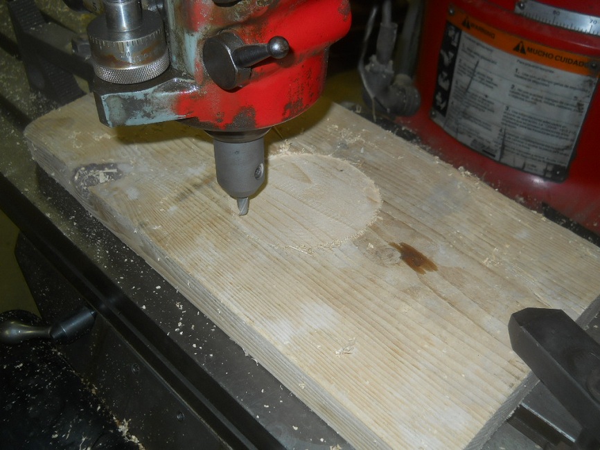

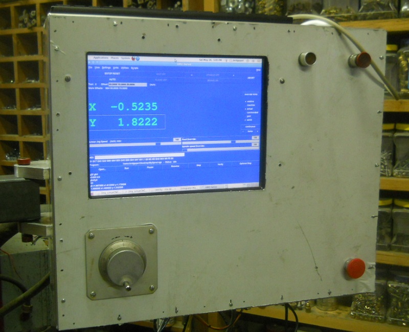

31 May 2012 01:44 #20517
by BRoth
Replied by BRoth on topic Re:Bridgeport with Siemens amps and servos
Thanks PCW, I was so concerned with the .ini file that I forgot about simply switching wires.
I tightened the connections for the tacho and that solved the jitter in the motion. I think I have everything tuned fairly well, dimentions seem fine.
Attached is a picture of the first cut using a modified version of the sample program Spiral.ngc. I cut an aluminum part afterwards just to check.
The rotary is left to do yet and maybe eventually a Z axis. At least I can do something with a two axis for now.
