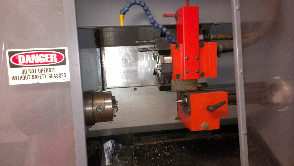

26 Apr 2016 12:41 #73898 by LutzTD

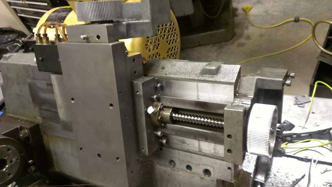

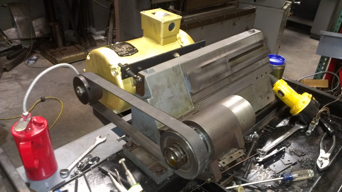

Replied by LutzTD on topic Emcoturn 120 lathe retrofit
current status of machine

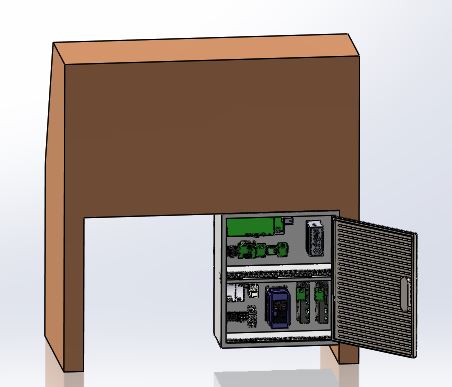

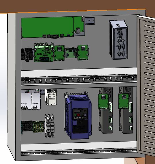

26 Apr 2016 12:43 #73899 by LutzTD
thoughts on control layout, this is a Mach system layout but would be similar? in linuxcnc

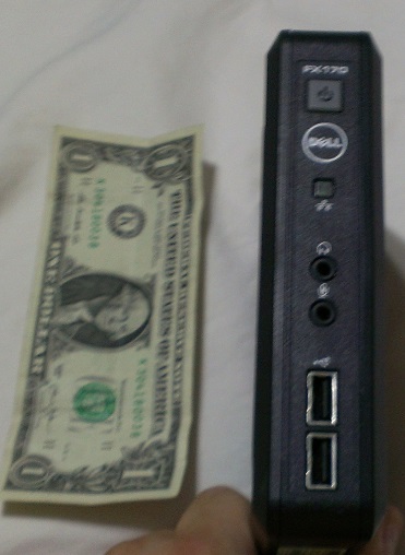

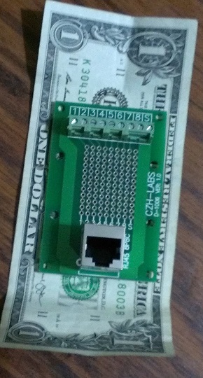

27 Apr 2016 20:24 - 27 Apr 2016 20:41 #73965 by LutzTD

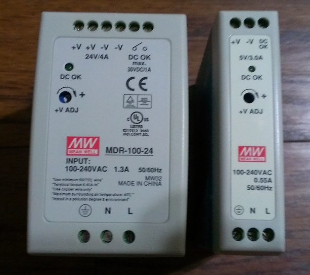

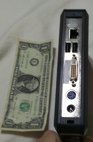

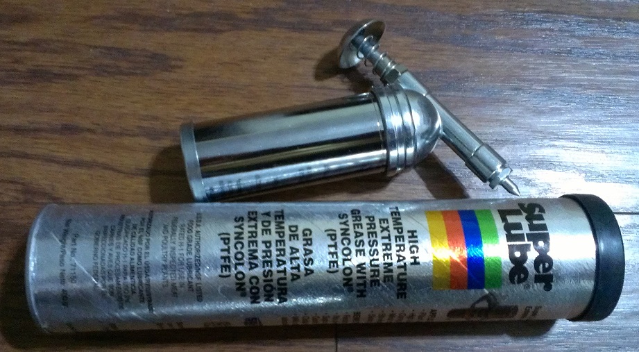

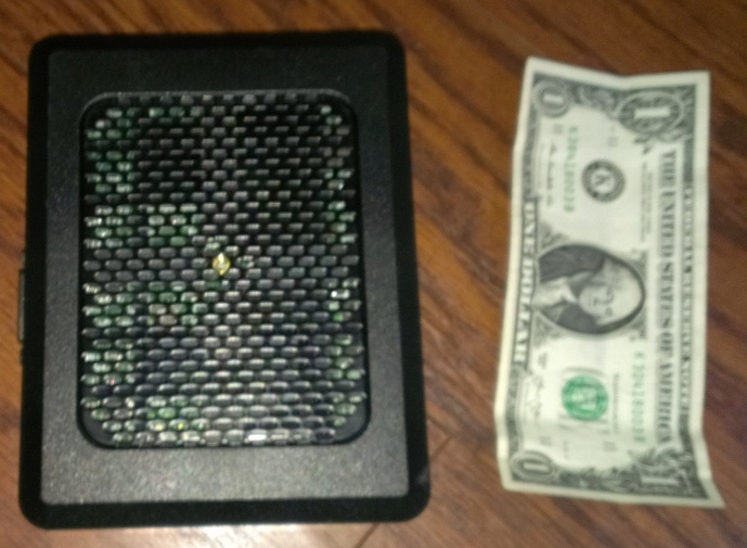

the Dell FX170 arrived today as well as the ball screw grease, 24vdc, 5vdc power supplies (thx tome) and the small rj45 BOB.
