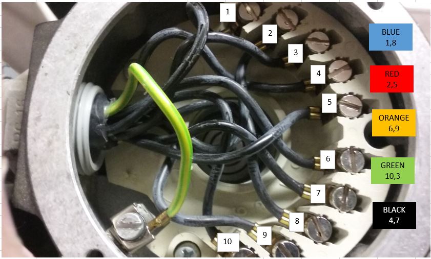

04 Dec 2016 16:36 #83670
by tome
Cool, glad to hear it! And just to close the loop (pun intended), can you verify the wiring sequence from your stepper terminals to the Vexta terminals? Just for future reference...
Replied by tome on topic Emcoturn 120 lathe retrofit

05 Dec 2016 00:39 - 05 Dec 2016 00:39 #83682
by LutzTD
Replied by LutzTD on topic Emcoturn 120 lathe retrofit
Last edit: 05 Dec 2016 00:39 by LutzTD.

05 Dec 2016 01:36 - 05 Dec 2016 14:48 #83683
by tome
Excellent. By the way, I was reading back through this whole thread and on page 3, post #74002, I posted some links to the Emco 120 literature I have accumulated as well as a link to a zip file of all my config files.
