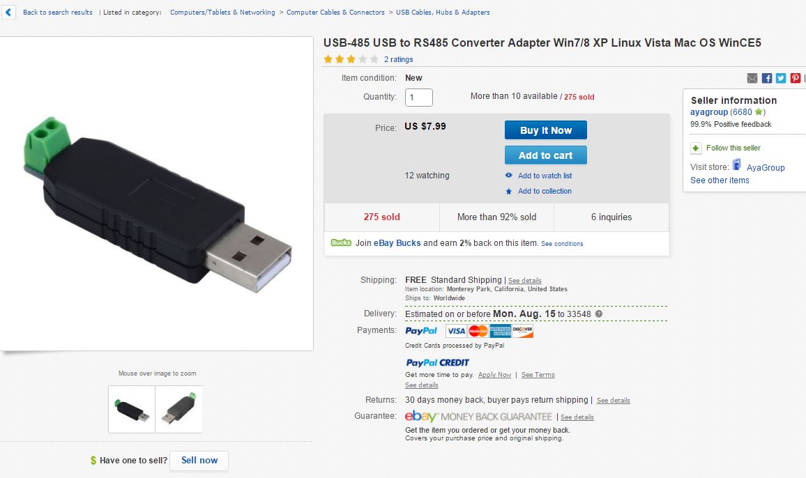

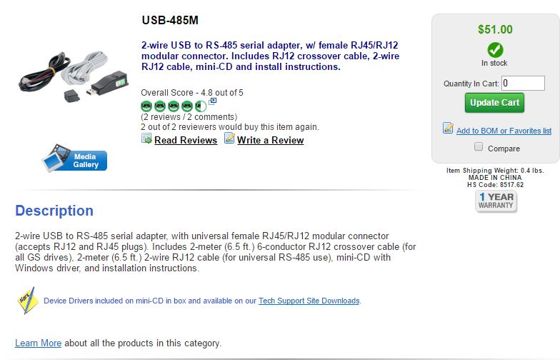

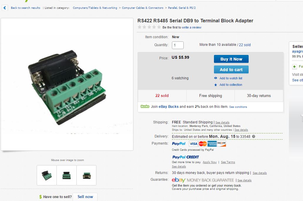

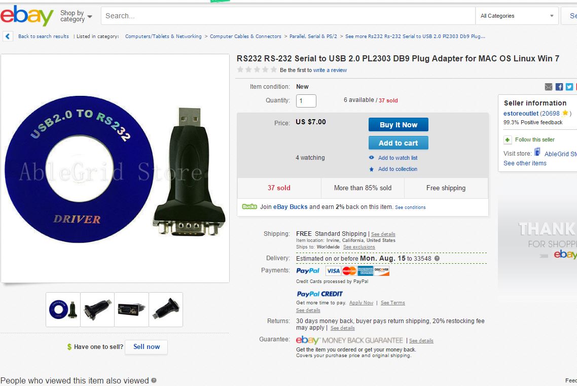

would you use rs-485 or rs-232? I see a couple adapters, looks like rs485 would be cheaper but disregarding cost would it be better or worse?
08 Aug 2016 11:18 #78482 by LutzTD
Replied by LutzTD on topic Emcoturn 120 lathe retrofit
I bought this one from Automation Direct

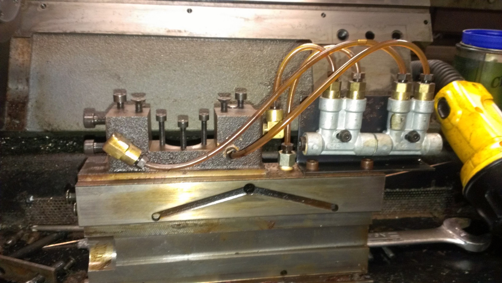

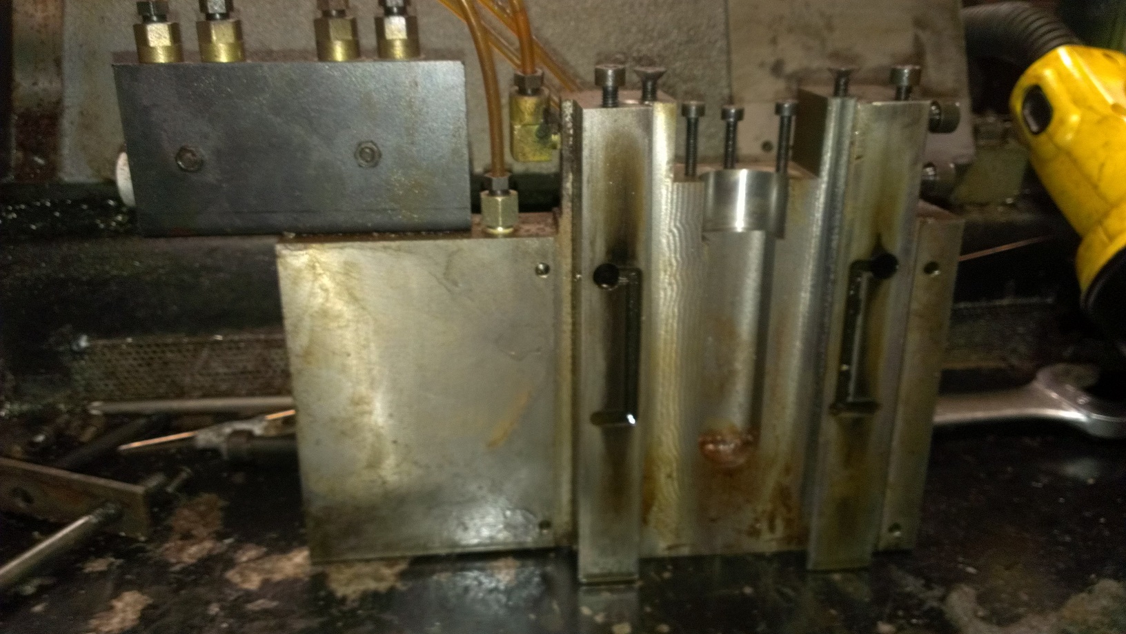

08 Aug 2016 12:00 #78486 by LutzTD

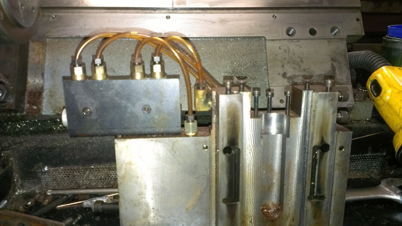

someone asked for pics of the lube system but I accidentally deleted the email. here are some.

08 Aug 2016 13:47 - 08 Aug 2016 13:48 #78490 by Todd Zuercher
Replied by Todd Zuercher on topic Emcoturn 120 lathe retrofit
I am currently using the Automation Direct one you linked to to control 8 VFDs on a gang router. It works OK but I'm getting a lot of com errors. I have tried 2 different RS232 (DB9 port) to RS485 adapters, and have not been able to get one that works for me. The first one I tried I did not notice when I bought it can only transmit, it can't receive, it worked as good as it was supposed to, but wasn't what I wanted. The second one I bought I couldn't get to work at all. It's been a frustrating subject for me.

OK thanx, I have the AD one coming, hooefully with only 1 VFD it will not have com errors. I likely wont be polling it for any info either but you never know.
09 Aug 2016 12:01 #78521 by andypugh
Replied by andypugh on topic Emcoturn 120 lathe retrofit
I am using one of the $2 ones from eBay. Seems to work fine.

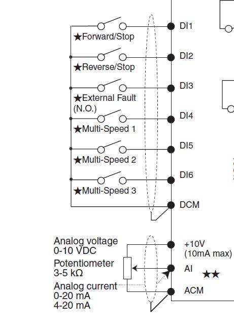

09 Aug 2016 12:43 - 09 Aug 2016 12:49 #78524 by LutzTD
thanx Andy. I thought I had asked that question and understood the 7i76e provided voltage which is not allowed. Can you tell me which ports act as a switch instead of a signal? I assume its these? So It would be right to connect the spindle direction and enable using the DCM and the D11 and D12 pins directly through the 7i76e?
Last edit: 09 Aug 2016 12:49 by LutzTD.
09 Aug 2016 12:48 #78525 by andypugh
I assume its these?
Yes. It will depend on the VFD whether the on/off and fwd/rev terminals need to be connected to VFD V+ or GND, but those terminals can do either.

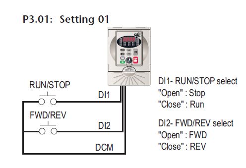

09 Aug 2016 12:55 #78526 by LutzTD
OK, that makes sense, here is the setting to make them run/stop fwd/rev
09 Aug 2016 13:21 #78528 by andypugh
Looks like DCM is "Digital common" which will be 0V.
So, connect ENA+ to DI1 and ENA- to DCM and connect DIR+ to DI2 and DIR- to DCM.
