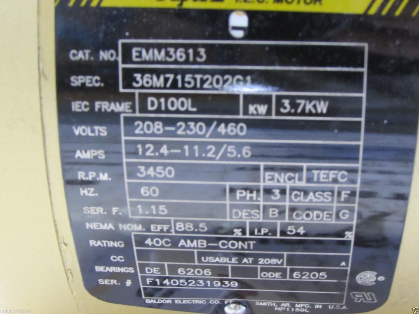

motor is a Baldor EMM3613 inverter duty 5hp, I plan to add a shaft ground as well

What spindle motor are you using? We ended up with a 3 HP Black Max Inverter Duty motor from Automation Direct. We also used an Automation Direct VFD...
-Tom

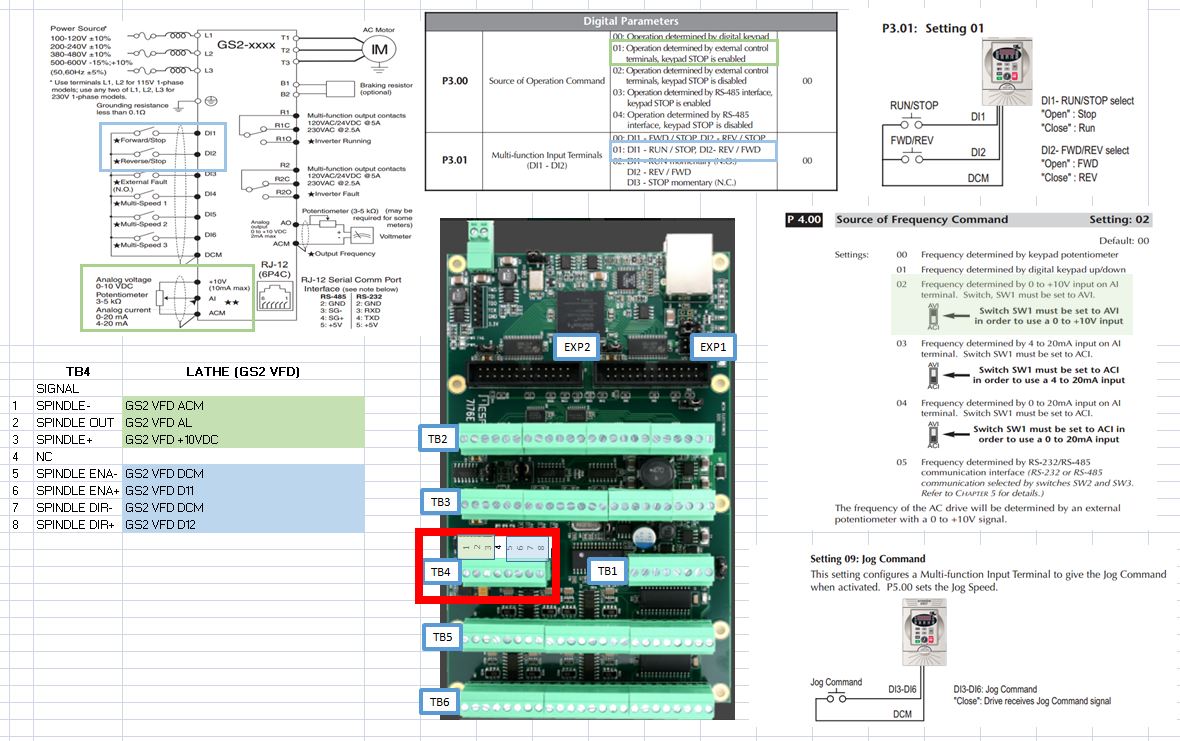

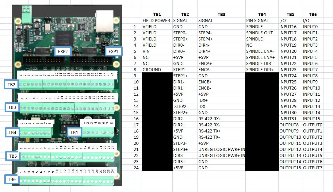

mesa card showed up today Looks like I need to get my power supplies hooked up so I can play. first glance at the linuxcnc setup is that I will need to identify all of the I/O connector pin locations. Does anyone have a list of standard pinouts (if there is such a thing) so Im not doing these at random?
- cncbasher
- Posts: 1021
- Thank you received: 202
19 May 2016 10:10 #74834
by cncbasher
Replied by cncbasher on topic Emcoturn 120 lathe retrofit
you dont mention which mesa card , to start a new config with the card connected , use pncconf.

Replied by BigJohnT on topic Emcoturn 120 lathe retrofit
For an Automation Direct GS2 use the gs2 component and connect via modbus so you have full spindle control. You will need the braking resistor.

can you explain how to connect using modbus? I have an idea kinda what it is but I wouldnt know how to even start setting it up. Looks like the 7i76e has a rs-422 plug but the GS2 is rs-485, they seem close, would I need to get an adapter card or something? Also, why would I get better control with modbus over using the direct outputs. Im really new at this so please excuse so many questions.

You connect the GS2 to your serial port. Why is it better... well you get a lot of information back and you can change speeds and reverse on the fly.

thanx. with direct connection set up the way I had worked it out I would be able to stop start, reverse or forward, and speed control on the fly. spindle rpm comes from the spindle encoder. I dont think the direct connection give any feedback, does the modbus allow a check method like a feedback loop? would the modbus do this more efficiently or offer some other feedback? I somewhat understand the direct lines but the serial I dont understand very well.
