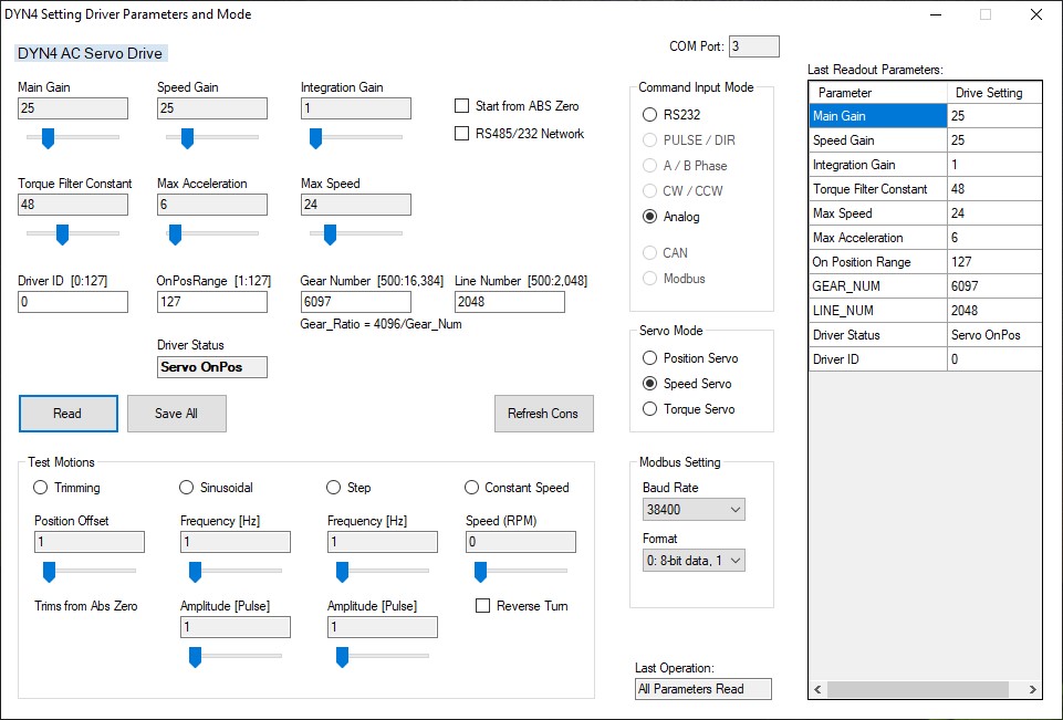

Don't know if this will help but these are the DMM settings I used. I am using the analog 0-10v control. My motor drives the spindle by toothed belt geared 1:1.8 that gives me a max speed of 5400 rpm.
This is some advice I got from DMM tech support.
For use as spindle motor, set Integration Gain to "1" and keep it at "1". Then increase Main Gain and Speed Gain until the motion is rigid and suitable. Keep Main Gain and Speed Gain at the same value.
Make sure to install a regenerative resistor on the drive to help absorb deceleration energy from the motor. Also install a transformer or AC line reactor on the AC power input to smooth and filter the power coming into the drive.
These are my DMM settings.
These are my ini settings:

my DMM looks pretty similar, still tuning that with Stephen over there, I have been having issues with the DYN4 "over heat"ing and he sent me some updated parameters to verify that the motor is tuned right. so i have yet to try those.
but to followup on the statement above to blazini, how are you getting your PID parameters? what was the process you used to set those? and how much difference are you seeing by having that over the initial setting from the PNCconfig?
when I command say a S1000 m3, the spindle will spool up and run anywhere between (according to the encoder from the DYN4) 950 and 1100 or so, it bounces around alot, so not sure whats causing that? maybe the TTL vs differential input? I was thinking it was some kind of refresh rate that is set in linux, or maybe is pretty standard to see that. I can film it and post it here if anybody wants to see what I am talking about.
