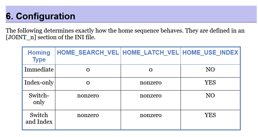

The docs at linuxcnc.org/docs/html/config/ini-homing.html says it
The cia402 component says
 For using the servo drives internal homing procedure configure your
joint homing to Home on Index Pulse only and connect the components
home Input to the index-enable Pin:
I don't see you have connected that pin.
To debug, use halscope and record controlword and statusword to and from the drive.

If I set like the table in your posts, it still moves and slams the axis into the end stops.
If I set homing sequence to -1 it flickers the drive.
I do not want any internal homing on the drive. I want no motion whatsoever.
What "normally" works is not here.

[JOINT_0]
TYPE = LINEAR
HOME = 0.0
FERROR = 0.5
MIN_FERROR = 1
MAX_VELOCITY = 20.0
MAX_ACCELERATION = 500.0
MAX_OUTPUT = 0.0
MIN_LIMIT = -106
MAX_LIMIT = 106
HOME_SEARCH_VEL = 0
HOME_LATCH_VEL = 0
HOME_SEQUENCE = 0
01 Nov 2025 03:10 #337625 by Hakan
I don't think it is a good idea to combine homing on current position with HOME_OFFSET.
That means is set's zero exactly where it is and immediately after moves to HOME_OFFSET.

Replied by ihavenofish on topic New ethercat / probe basic control for minimonster
does your lathe use ethercat drives?
this is what i had before with the pulse drives. everything was fine. And i could have sworn in my first ethercat program *before* all this modbus nonsense it was fine as well.
ive removed that now, now, no change. also that offset is + direction and it is slamming the thing full speed into the table.

01 Nov 2025 03:19 #337631 by ihavenofish
well we sorta already did that. there is no setting that doesnt either flicker the drives or slam the axis. like it does't respect search or latch vel at all.
that has to be a clue. something ELSE is making it home. maybe it IS doing internal drive homing?
