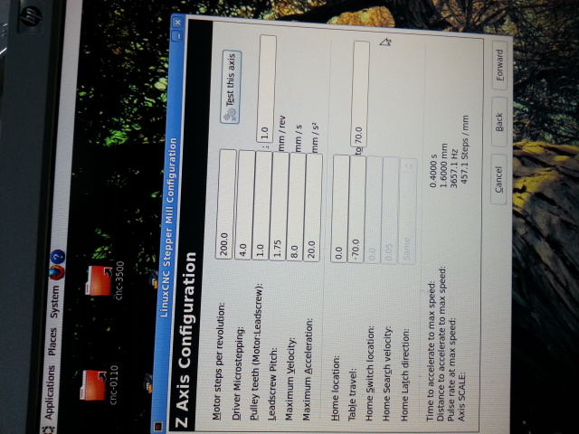

19 Nov 2013 19:52 #40975 by fannlow
Replied by fannlow on topic NEMA 23, weird velocity results.. need help
Ok tried the settings recommended.
Steps/rev 200
uStep 4
Pulley 1:1
Pitch mm/rev 1.75
Max vel 8mm/s
Max acc 20mm/s2
This is the final result without load.
Is this suppose to be the result I should be getting for a Nema23 425ozin?
I have attached a screenshot.
What is maxstep rate for 2nd screenshot?
My max pulse rate now is 3657.1 Hz
19 Nov 2013 23:49 #40978 by cncbasher
Replied by cncbasher on topic NEMA 23, weird velocity results.. need help
i notice you seem to have a high base period , so check your period jitter and perhaps ammend
for example i have lower than 5000 base period , so this allows a max step rate of up to 50,000
take some time and play with the values , you may improve them drasticly

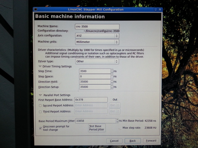

20 Nov 2013 00:02 #40979 by fannlow
CncBasher:
did you meant from the 2nd screenshot where the max base jitters are (33858)?
I have no idea, how to reduce this jitters... :(
i read all the rest of the docs in wiki, but its a HP to begin with, running 2gb DDR2, 160GB SATA, GeForce gCard.
i have also disabled hyperThreading on BIOS, and know of nothing else at this stage to further reduce this..
I got the 33858 after having the machine run itself over 23hours (using if I remember correctly "cell" screensaver).
any recommendations?
what PC are you using? do you have a spec, i can perhaps source my local store for something similar?
thanks
20 Nov 2013 00:12 #40980 by ArcEye
Replied by ArcEye on topic NEMA 23, weird velocity results.. need help
It is not likely that you have 33K max jitter without spikes
Read this FAQ and do the realtime latency test from a terminal and you should get some idea when the spikes are occurring
www.linuxcnc.org/index.php/english/forum...-the-latency-problem
If the spikes are regular see this FAQ
www.linuxcnc.org/index.php/english/forum...me-latency-solutions
Then do lspci -vv in a terminal and check the chipset number and revision against the list of those requiring the smi fix
At the same time check what video driver is being used by the video card
If it is one of the non-free ones, it could also be another source of problems, try removing the packages and substituting the open source driver
regards
20 Nov 2013 00:30 #40981 by fannlow
Hi ArcEye,
I didn't quite get the "spikes" that you are referring to...
will run a terminal check tomorrow, and update.
The video card driver... I didn't install it from the CD-ROM that came with it.
I bought the GeForce from a local store and just plug it in...
Linux detected it and used it right away..
so I ain't quite sure what it is now or how I can know where it is, since I'm not too familiar with Linux.. :dry:
any help is greatly appreciated :)
20 Nov 2013 00:51 - 20 Nov 2013 17:06 #40982 by ArcEye
The dialog based latency test just shows the highest jitter figures in a cumulative total.
So if you have 1 spike of 33k and 23 hours of 5K, it will still show 33K
If you have selected use non-free drivers during the installation, it will use the proprietary drivers automatically.
The print from lspci will show what drivers are in use for the video card
If you find that you get spikes when opening openGL programs, or moving windows around etc etc ie video based
the proprietary drivers can be removed using synaptic and the alternative open-source ones will be substituted instead
regards
Last edit: 20 Nov 2013 17:06 by ArcEye.
The following user(s) said Thank You: fannlow
