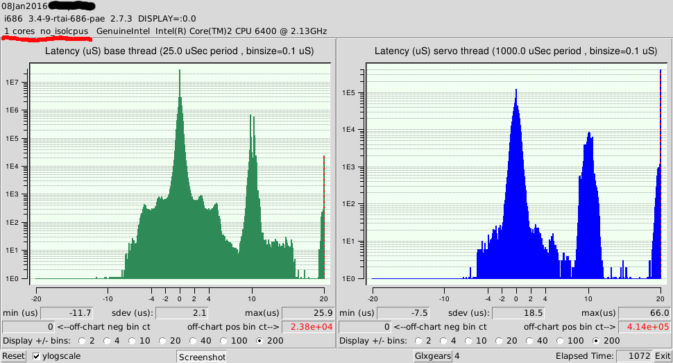

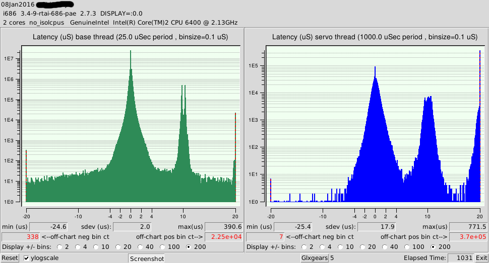

Hey
I've got a Dell Optiplex 745 with a ATI Radeon card. Looking at the plots below is there any using this computer to drive a Bridgeport clone 3 axis knee mill? The mill has Servos, Tacho, and glass scales that are all working now. The Anilam Crusader II needs to be replaced and I would like to use a Mesa 5i25-7i77 kit.
This is with the video card
This is without the card.

The without-car max latency of 63uS is acceptable for use with a Mesa Card. You won't need the base-thread with a Mesa setup, so can ignore that.

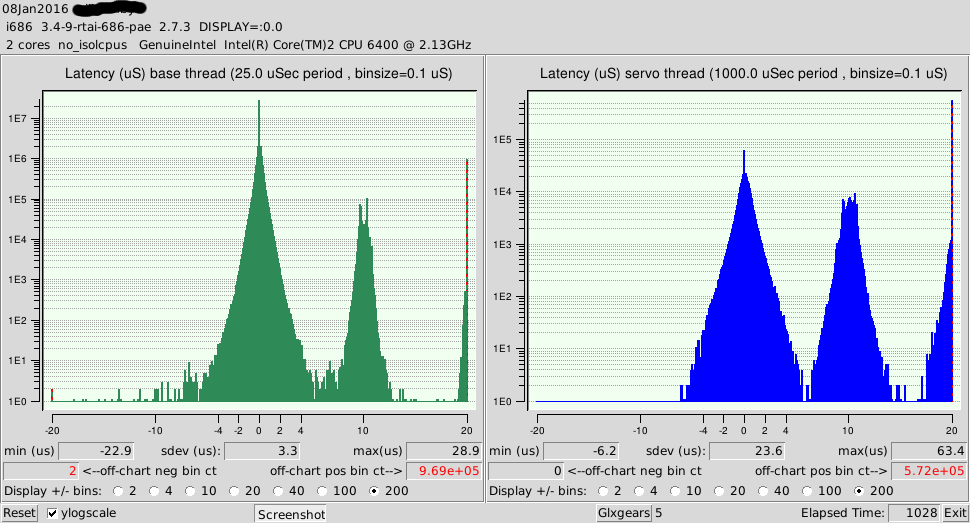

Setting up isocpus=0 or 1 should help. Also double check your bios to be sure any power saving stuff is turned off. (for the most part if you don't know what it is, or you aren't going to use it turn it off.)

Added isolcpus to the end of this line "GRUB_CMDLINE_LINUX_DEFAULT="lapic quiet rootdelay=5 isolcpus=1" to the /etc/default/grub file and ran grub-mkconfig. Now plot looks like:
I spent a lot of time fighting with that isolcpus setting. The upper left corner says no-isolcpus but the cores show 1.
Checking with "cat /proc/cmdline" doesn't show the isolcpus so I am not sure if its working or not.
Shut off everything in the bios as you mentioned. And finally got the screen saver and power saver to shut down.

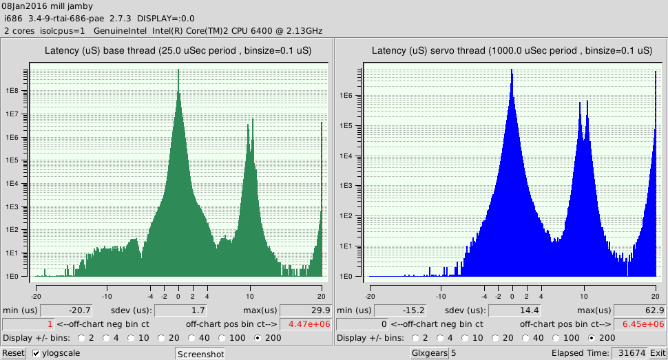

09 Jan 2016 12:14 #68115
by jamby
Replied by jamby on topic Can this computer be used?
Todd & Andy
Thanks, I finally got isolcpus=1 to work. I followed these instructions.
www.wiki.eusurplus.com/index.php?title=Install_LinuxCNC
With that I had it working however the results don't look that much different. Even though the time is tripled.
Thanks Again
Jim
