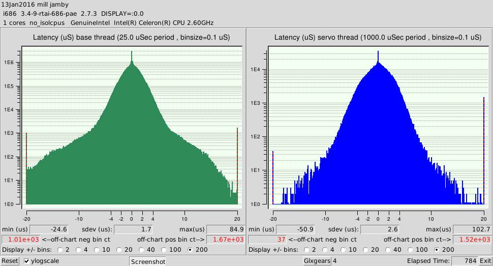

13 Jan 2016 22:57 - 13 Jan 2016 22:59 #68333
by jamby
Replied by jamby on topic Can this computer be used?
Hey
I dug out one of my old computers and thought I'd try getting it to run linuxcnc. Its a Insignia computer with a Intel D845EPI/D845GVSR motherboard. A Celeron processor but it only has 1.5 gig of memory, DSS 266.
The plot looks bad and I've tried shutting down things in the Bios but then it wouldn't run right so I had to put it back.
Do you think this could run a servo/tacho/glass scale system??
My only reason for using this computer is its much smaller size.
Anyone know if the Mesa 5i525/7i77 kit comes with the cable pictured??
Do I need to order anything else?? I've got a DIN rail adapter set of 3 on my wish list.
Thanks a lot folks
Jim
Thanks a lot folks
Jim
Last edit: 13 Jan 2016 22:59 by jamby.
- Todd Zuercher
- Posts: 4790
- Thank you received: 1477
14 Jan 2016 04:05 #68345
Replied by Todd Zuercher on topic Can this computer be used?
If that is the best it can do, I'd say it's not good enough.
14 Jan 2016 12:03 #68358
100uS is just about within scope if using a Mesa FPGA card.
Replied by andypugh on topic Can this computer be used?

14 Jan 2016 14:45 #68373
by jamby
Todd , Andy
Thanks again. I'll play with it a bit more but if this is it. its on the way to the dump.
Jim
Jim
- Todd Zuercher
- Posts: 4790
14 Jan 2016 17:00 #68393
Old hardware like that may run significantly better with an older kernel, such as what is on the old Linuxcnc Ububtu 8.04 live CD. I think I've read about others compiling new custom patched real time kernels for old single core cpus for newer Linux distros such as Wheezy. (but I haven't a clue how to do it myself, or if it is really worthwhile.)

14 Jan 2016 23:36 #68415
by jamby
Todd
I loaded up 8.04 but it could not be updated and the linux-install.sh had the same errors looking for a IP address. Because 8.04 is no longer supported apt-get update fails and apparently the linux-install script depends on the same repo.
Looking into Lubuntu 12.04 as a possible os.
Do you think updating the BIOS would buy me anything??
Jim
