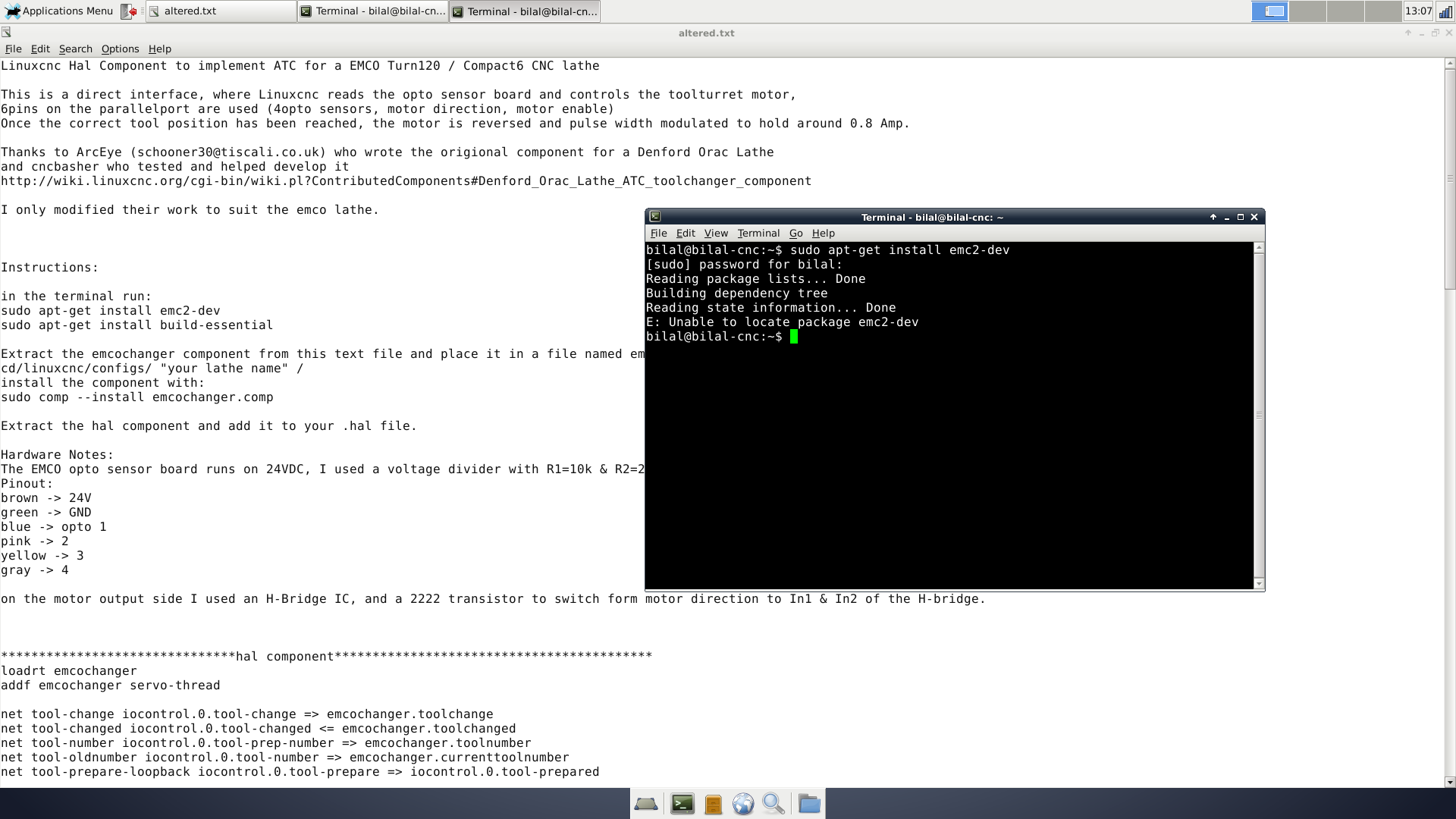

OK, so here is my problem then. When I am trying to install a comp as advised by ArcEye, I am getting errors. Please see the screenshot, what is the problem? It basically does not want to install dev which I believe is required to install a comp.
Here are the instructions that I followed and there are two screenshots I am sharing, I am getting error on dev install and comp install. Can you please point it out what the problem is.
Here are the instructions I am trying to follow:
Instructions:
in the terminal run:
sudo apt-get install emc2-dev
sudo apt-get install build-essential
Extract the emcochanger component from this text file and place it in a file named emcochanger.comp , copy this to you config file.
cd/linuxcnc/configs/ "your lathe name" /
install the component with:
sudo comp --install emcochanger.comp
Extract the hal component and add it to your .hal file.
And that is why my linuxcnc is not running now. It gives me comp loading error.
Please help me out. I want to try my ATC code that I altered.

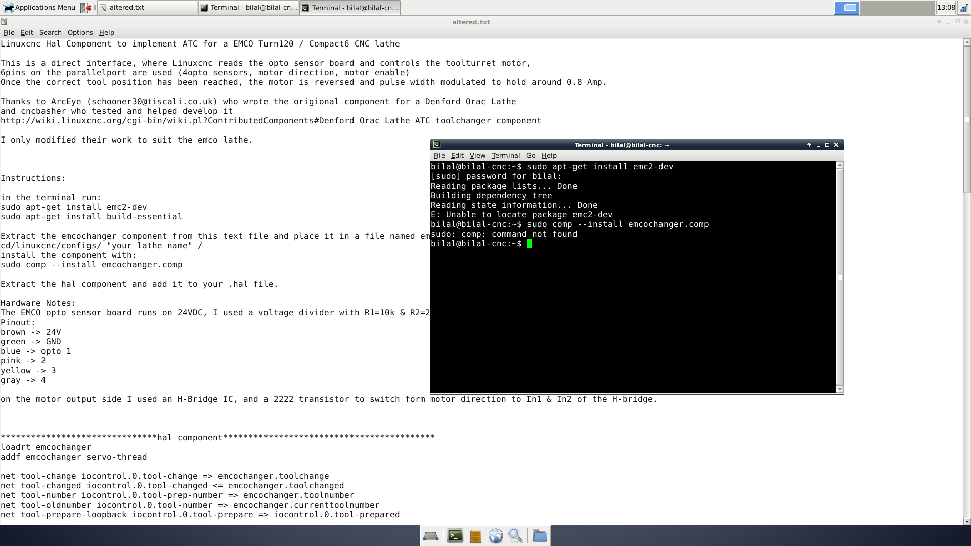

16 Aug 2016 12:24 #78833
by sxyuklad
Replied by sxyuklad on topic Urgent help required with EMC please
Tried a few other things... I will still not install my comp or dev even I think. See screenshot

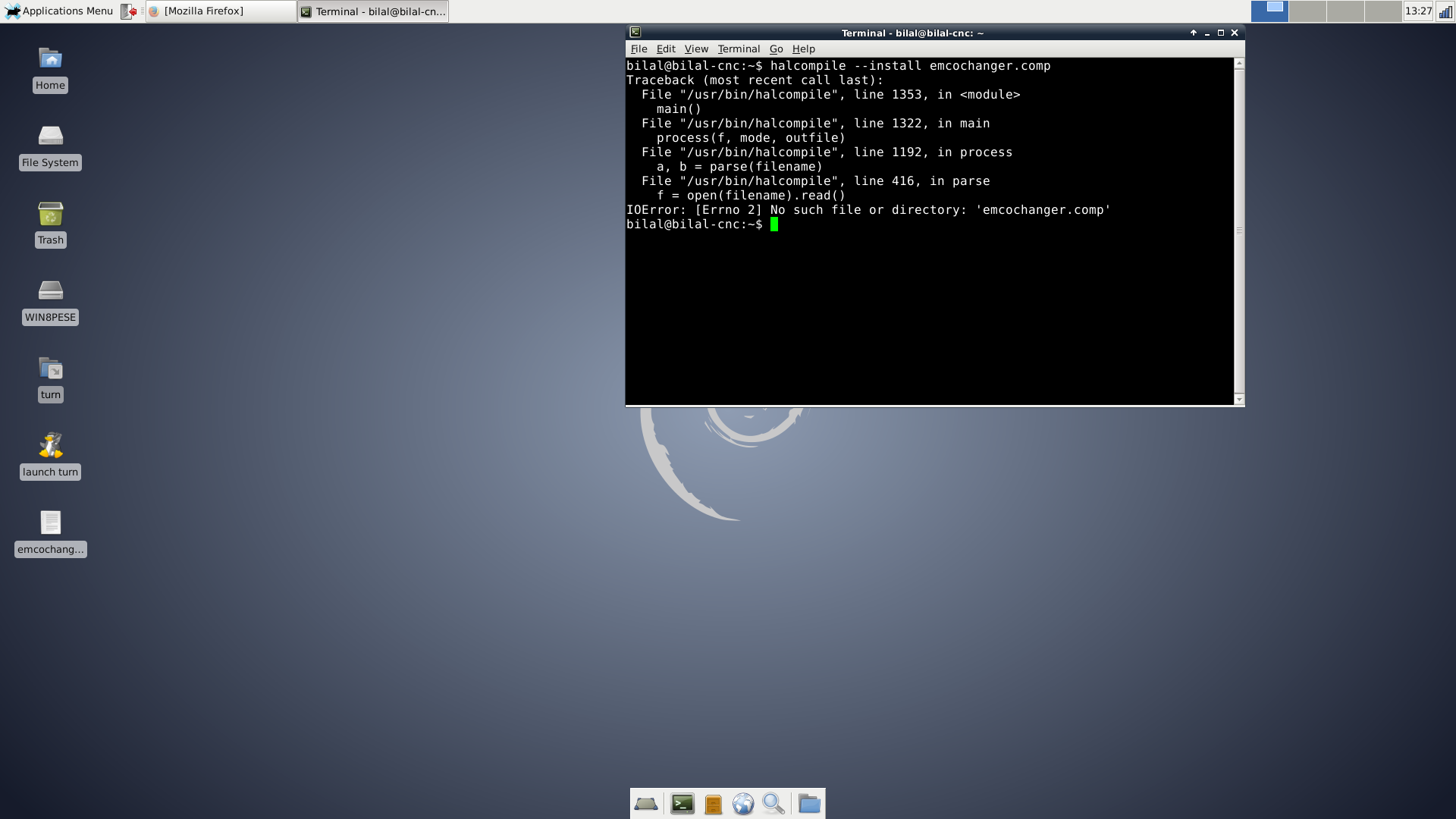

16 Aug 2016 12:28 #78834
by sxyuklad
Still will not install comp. I do not know why it will not find the file. I have already copied emcochanger.comp in my config directory where there are other files like hal and ini files
See screenshot.
See screenshot.

16 Aug 2016 12:30 - 16 Aug 2016 12:30 #78835
Replied by Todd Zuercher on topic Urgent help required with EMC please
The instructions you must have looked up must have been old. 4 or 5 years ago Linuxcnc was known as EMC2, some corporation took offense and their lawyers forced us to rename it.
The first command should have been.
sudo apt-get install linuxcnc-dev

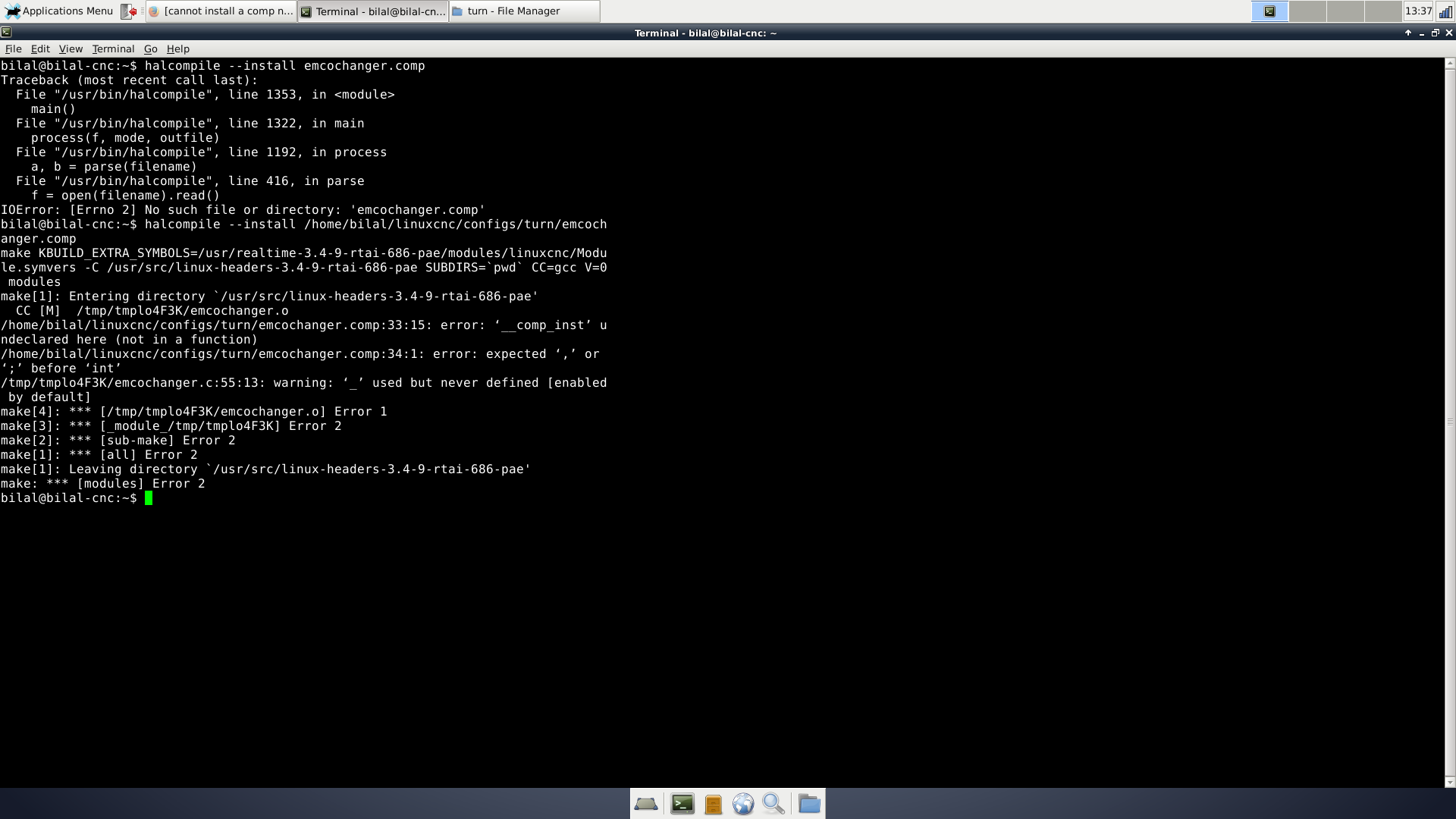

16 Aug 2016 12:38 #78836
by sxyuklad
I tried installing by giving full path, still errors... see screenshot

16 Aug 2016 12:39 #78837
The software has not been allowed to be called "EMC" for several years. (The EMC2 corporation had bigger lawyers than us).
You should be able to get "linuxcnc-dev" from the Synaptic Package Manager.
Or, if you prefer, with "sudo apt-get install linuxcnc-dev"
Replied by andypugh on topic Urgent help required with EMC please
OK, so here is my problem then. When I am trying to install a comp as advised by ArcEye, I am getting errors. Please see the screenshot, what is the problem? It basically does not want to install dev which I believe is required to install a comp..

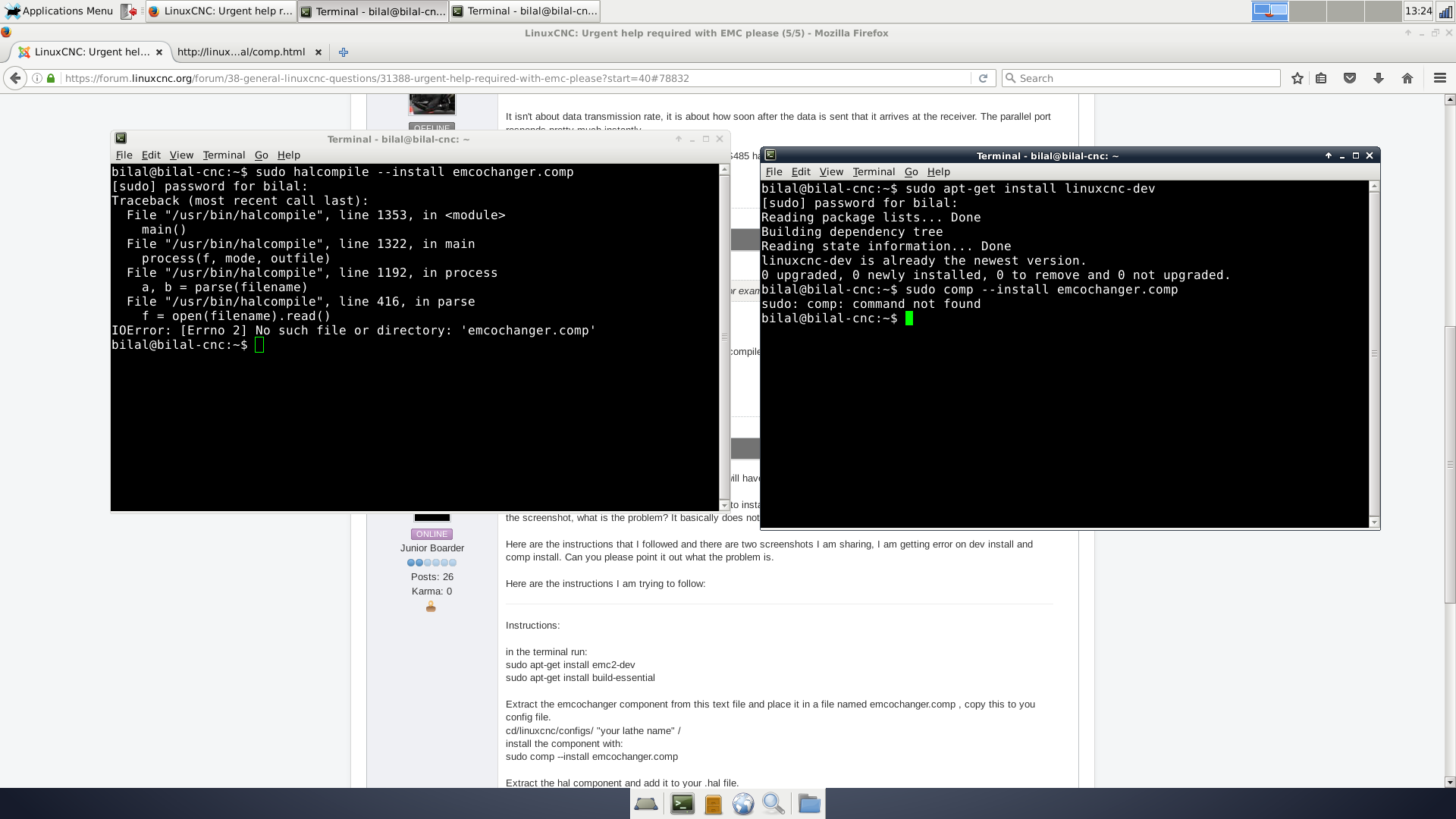

16 Aug 2016 12:41 #78839
by sxyuklad
If you see all my posts, I have already tried this:
And I got the this screenshot, it nothing changed at the end, is it installed now or not?
