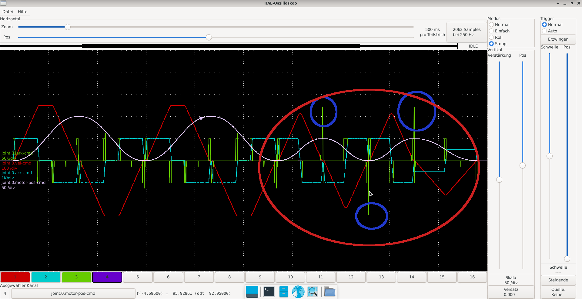

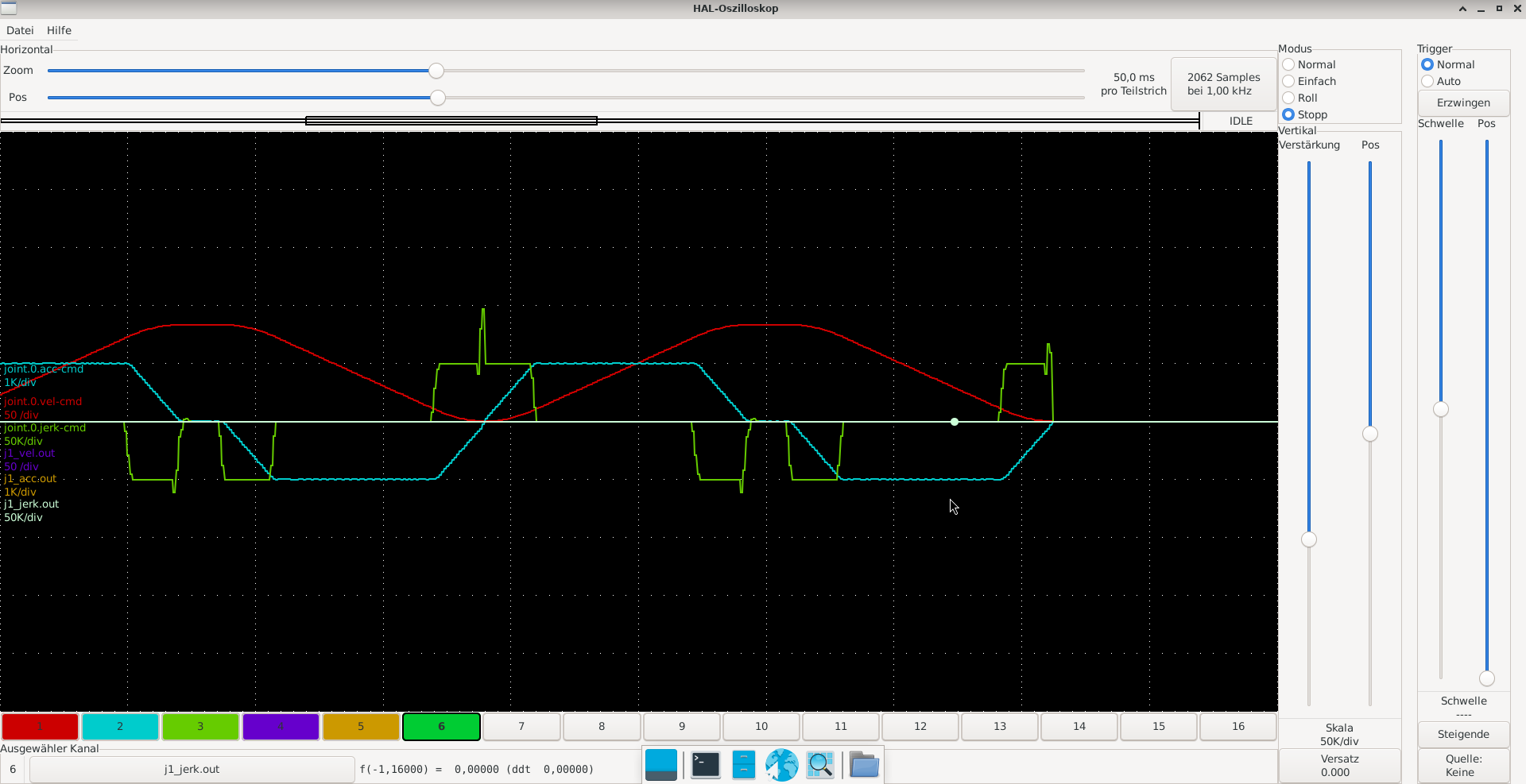

I've not noticed this behavior, but I'm not omniscient, I'd need more information, your pictures are lacking context...

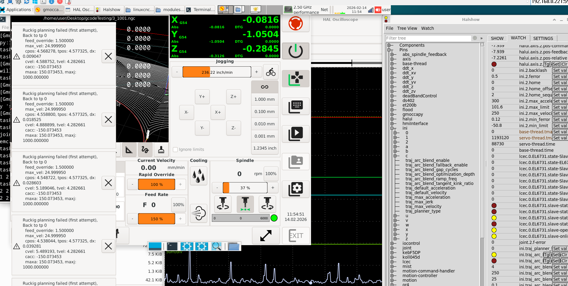

movement are incredible smooth ... basic shaping what I have tested till now is pretty ... but during movement at more points during simulation of rotation interpolation its jumping or woobing ... kind off braking and next accelleration
most spiking during cloud of points are gone ... some spiking are still present but it a huuuuge step forward
testing setup 2ms benchtop profibus master 3axis geany gui ... 3 servo axis with synchronized speed control loop at 2ms
some testing fault popups triggered during the movement of file 3_1001.ngc
I am still testing at default simulation file from past but splitted to separated operations ..
thanks a lot for your progress ... I am watching it every single day with mount open and box of popcorn to reading the edits ...
regards E.
regards E.

My initial tests showed no violations of the limits for jerk and acceleration.
Has the track speed for circles G2/G3 been reduced in the past?
The speed with G2/G3 seems very low to me.
