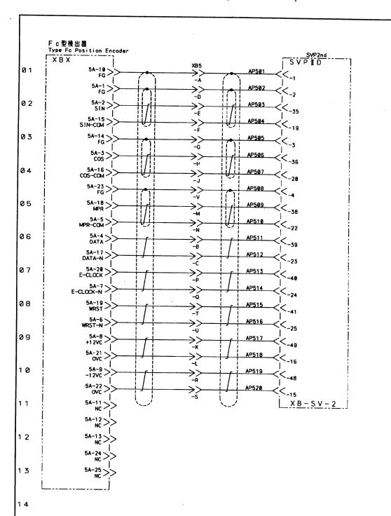

- Henk
- Posts: 408
- Thank you received: 92
12 Jun 2018 10:12 #112231
by Henk
Replied by Henk on topic Okuma Servo Drives
Hi Andy
See attached.
I have not worked with resolvers or serial encoders so not quite sure what I'm looking at here.
Thanks for your help.
See attached.
The following user(s) said Thank You: Diederik

12 Jun 2018 15:49 #112243
by Diederik
Replied by Diederik on topic Okuma Servo Drives
Thanks Henk and Andy for your interest. Much appreciated.
Normally if it is a absolute encoder, there would be a battery pack somewhere along where the encoder plugs in, but I can't find one, unless it is hidden.
Not sure if type fc position encoder is just a product of okuma, or if it has a universal meaning.
Allthough, there is data pins... so I assume this is absolute encoders. Now: Encoders is easily available for relatively cheap, so if I can just replace the existing encoder with a normal incremental differential encoder with signals: A, A-, 0V, B, B-, 5V, Z, Z-,... I am keen to do that. Will that make things simpler? I once used a normal 4 pole electric motor with a vsd, and a encoder, A worm gearbox, with a 7i77 to control a Z axis of a gun drill, and it is still in production today, and is working well, and was sufficient for what was needed. Now, if I can just get a velocity controller for these motors, that will make me happy. I don't really want to spend too much time figuring out how these serial encoders etc. works. I like to keep things standard and simple. So... that said... would you reccomend I use a stmbl drive in velocity control mode? and then handle the position loop within linuxcnc?
Andy, Just to verify: the signals on the existing encoder is:
1. FG(I assume this is ground)
2. SIN
3. SIN-COM
4. FG
5. COS
6. COS-COM
7. FG
8. MPR
9. MPR-COM
10. DATA
11. DATA-N
12. E-CLOCK
13. E-CLOCK-N
14. WRST
15. WRST-N
16. +12VC
17. OVC
18. -12VC
19. 0VC

- rene-dev
- Posts: 50
- Thank you received: 27
12 Jun 2018 16:08 #112245
by rene-dev
Replied by rene-dev on topic Okuma Servo Drives
looks like a normal sin/cos encoder, with additional abspos, and possibly multiturn.
stmbl can use sin/cos encoders only, but requires autophasing on startup.
I have seen many encoder pinouts, but yours doesnt ring a bell.
if you have the original drives, why not reuse them?
or use them to figure out how the serial data works?
Rene
Rene
