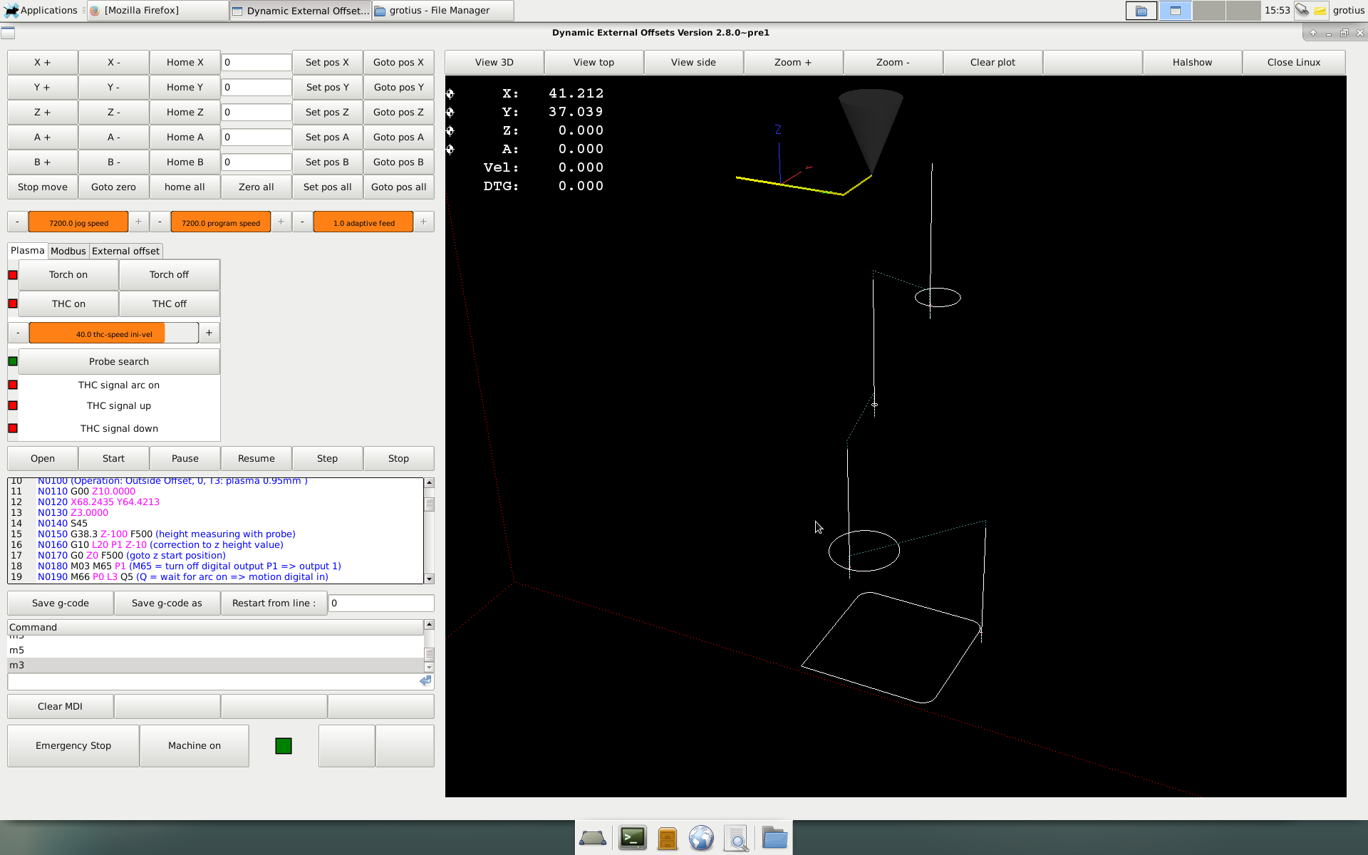

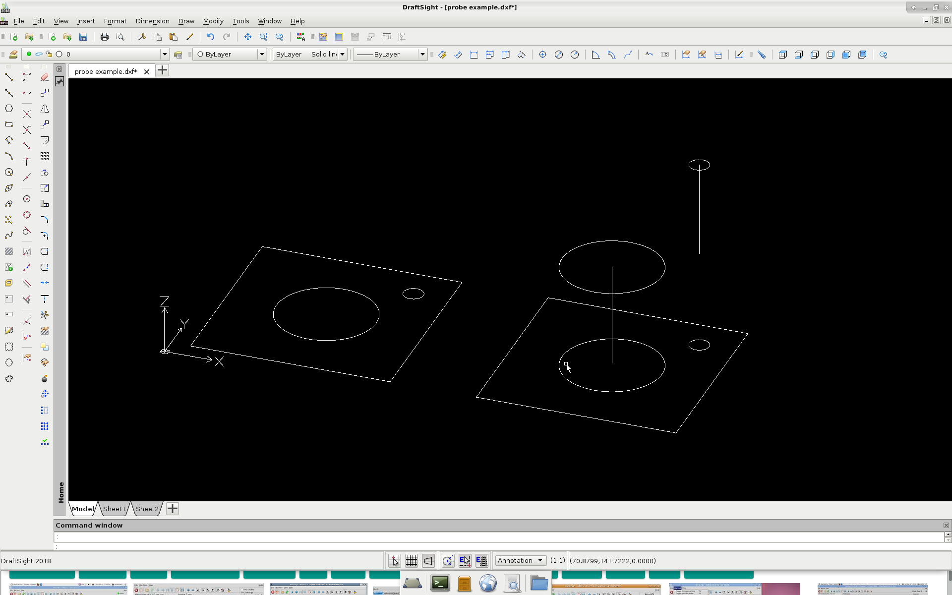

One of my problems with linuxcnc is the probe function, see picture.
Normally without probe, the gremlin screen looks like the left picture.
When i add a linuxcnc G-code based probe function in the post processor, i get a gremlin screen like the right picture.
Problem is : The probe measuring distance you see in the gremlin screen, this is not what i like. How to solve this?
The picture is an example of the problem. The height measuring distance for the probe function is for example 100mm in z axis.
So for a cutting a plate, your screen looks like...
The code looks like this, but i must check that : G91 G38.2 Z-100
Can i make a own gcode or macro in linuxcnc? Where can i find G38.2 in the linux source code?
That would make things easer for me.

11 Jul 2018 21:37 #114032
Replied by rodw on topic FPGA (field programmable gate array) programmed for linuxcnc motion
Grotius, I have the same problem with the gremlin preview and mentioned it here forum.linuxcnc.org/plasma-laser/34879-ex...erent-heights#114030
I'm sure there is a solution, I just can't remember it. I think its to use a different coordinate system (G10 L2).
As far as the additional axes go, with the development branch (v2.8), All you need to do is add the extra joints, configure them in hal and change this ini section to something like
I think you also need to add them to the geometry statement so the DRO's display on screen
I hope I got that right. The bevel head would be pretty cool and they don't seem too hard to make.

12 Jul 2018 18:31 - 12 Jul 2018 18:50 #114081
by Grotius
Replied by Grotius on topic FPGA (field programmable gate array) programmed for linuxcnc motion
Hi Rodw,
Thanks for your excellent tip, this can save lot's of investegation time....
Tomorrow i try this code example on the system, i hope i can solve it soon :

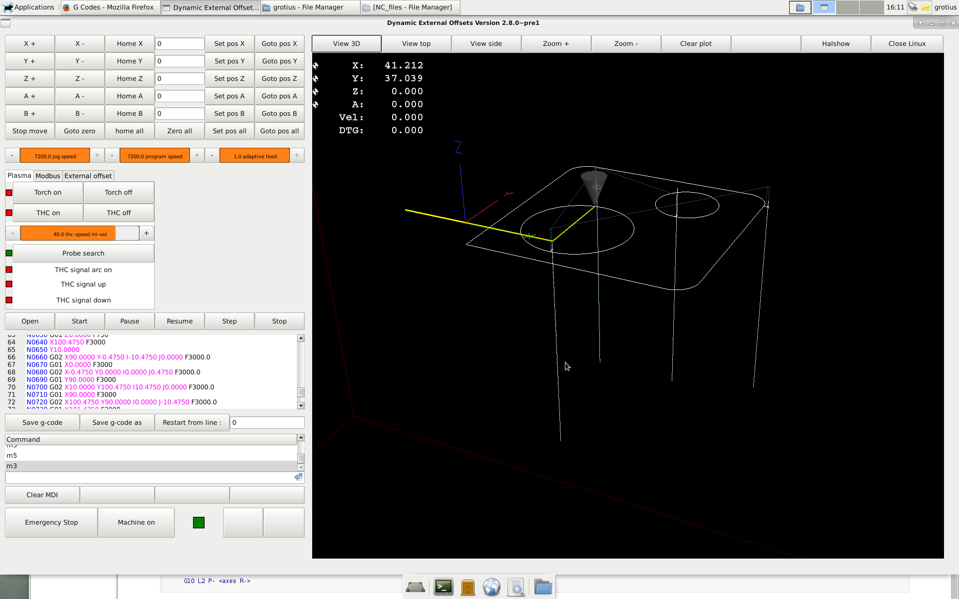

13 Jul 2018 20:15 - 13 Jul 2018 20:31 #114146
by Grotius
Hi Rodw,
Solution was to change L20 to L2.....
Pff.... very simple....
The bad way :
The good way :
For interest, i add the program code. This is done by sheetcam modified postprocessor.
It looks very difficult related to mach3 code.
This is the sheetcam postprocessor i used, just for information. There are a few modifications i did to get things
better working.
This code solution must be tested on a real plasma machine soon. So it is at this moment this solution is not tested !!!
Next problem is to solve the arc on signal during cutting.
The machine waits at start for arc on ....
M66 P0 L3 Q5 (Q = wait for arc on => motion digital in)
This works perfect.
But machine must stop if arc is lost during cutting....
I must find a solution for that....I would like a interrupt poll for this.

post.ModalNumber (" Y", endY * scale, "0.0000")
post.ModalNumber (" Z", (endZ + toolOffset) * scale, "0.0000")
post.Eol()
end
function OnMove()
post.ModalText (" G01")
post.ModalNumber (" X", endX * scale, "0.0000")
post.ModalNumber (" F", feedRate * scale, "0.###")
if(toolType == 8 or toolType == 9) then
post.ModalNumber (" S", power, "0.###")
end
post.Eol()
end
function OnArc()
if(arcAngle <0) then
post.ModalText (" G03")
else
post.ModalText (" G02")
end
post.NonModalNumber (" X", endX * scale, "0.0000")
post.NonModalNumber (" Y", endY * scale, "0.0000")
post.Text (" I")
post.Number ((arcCentreX - currentX) * scale, "0.0000")
post.Text (" J")
post.Number ((arcCentreY - currentY) * scale, "0.0000")
post.ModalNumber (" F", feedRate * scale, "0.0###")
post.Eol()
end
function OnPenDown()
if (preheat > 0.001) then
post.ModalText (" G00")
post.ModalNumber (" Z", cutHeight * scale, "0.0000")
post.Text ("\n G04 P")
post.Number (preheat,"0.###")
post.Eol()
end
post.ModalNumber (" Z", pierceHeight * scale, "0.0000")
post.Text ("\n G38.3 Z-100 F500 (height measuring with probe)\n")
post.Text ("\n G10 L20 P1 Z-10 (correction to z height value)\n")
post.Text ("\n G0 Z0 F500 (goto z start position)\n")
post.Text ("\n M03 M65 P1 (M65 = turn off digital output P1 => output 1)\n")
post.Text ("\n M66 P0 L3 Q5 (Q = wait for arc on => motion digital in)\n")
if (pierceDelay > 0.001) then
post.Text (" G04 P")
post.Number (pierceDelay,"0.###")
post.Eol()
end
end
function OnPenUp()
post.Text (" M05 M64 P1 (M64 = turn on digital output 1 => remove offsets)\n")
if (endDelay > 0) then
post.Number (endDelay,"0.###")
post.Eol()
end
end
function OnNewOperation()
post.Text (" (Operation: ", operationName, ")\n")
end
function OnComment()
post.Text(" (",commentText,")\n")
end
function OnNewPart()
post.Text(" (Part: ",partName,")\n");
end
function OnDrill()
OnRapid()
OnPenDown()
endZ = drillZ
OnMove()
OnPenUp()
endZ = safeZ
OnRapid()
endThis code solution must be tested on a real plasma machine soon. So it is at this moment this solution is not tested !!!
This works perfect.
Last edit: 13 Jul 2018 20:31 by Grotius.

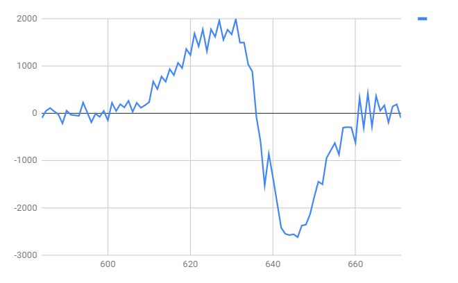

Perhaps it is possible to set halui.program-pause when ArcOK is lost when halui.program-is-running. this might need a component to deal with some logic conditions. It would be nice to be able to lift the torch so you can change consumables though.
Yesterday I spent some time looking at kerf crossings.
And a plot of the rate of change of voltage at the kerf cross (volts per second)
Still much more to do as this was at 200 ms per reading from halscope
I tried a 1ms capture from halscope but it had no meaningful data so I will repeat using halsampler which I know will sample the data.

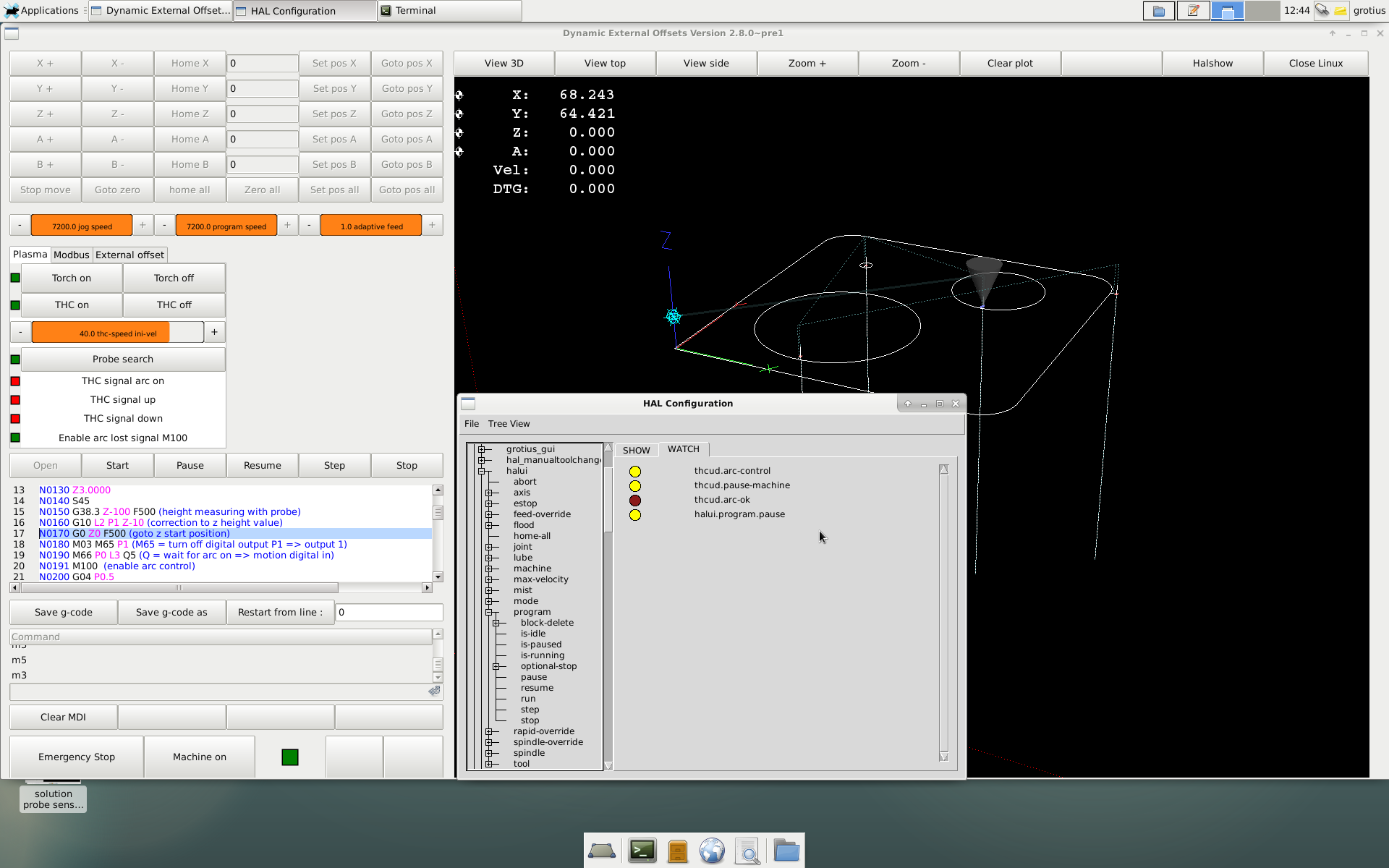

I have a solution that is working for pausing machine when arc transfer is lost. It depends on 4 files.
M100 (remove extension .txt and make executable)
M101
modified THCUD.comp
Postgui.hal ( this is simple : net pause thcud.pause-machine halui.program.pause
The M100 and M101 specifies the cutting path you exactly need in the program to trigger a arc transfer lost.
It begins to trigger after the waiting periode for stable arc.... And it ends at a m5. That was so difficult of this item.
Start triggering after stable arc....
Tjongejonge.... Why is uploading files so difficult here?
added pin in bit arc_control "M100 & M101 linking arc lost";
added pin out bit pause_machine "Pin for pausing";
For the thcud.comp i made a few modifications. Added pin in and pin out. Added
arc_control is the signal for the cutting path between the arc on waiting macro and the end of the cut.
!arc_ok means, no arc okey. The ! sign means it is not true.
Complete code :
Compiling thcud.comp : sudo halcompile --install thcud.comp
Rip location : src / hal / components
Orginal location : /usr/lib/linuxcnc/modules/
Don't forget if you have linux rip running .... To overwrite and replace the compiled comp file to the orginal linuxcnc directory
Just for fun, to keep everyone here in good shape :
M101
modified THCUD.comp
if(torch_on && arc_control && !arc_ok){ // pause machine
pause_machine = 1;
if(!torch_on){ // pause machine
pause_machine = 0;
}arc_control is the signal for the cutting path between the arc on waiting macro and the end of the cut.
Complete code :
