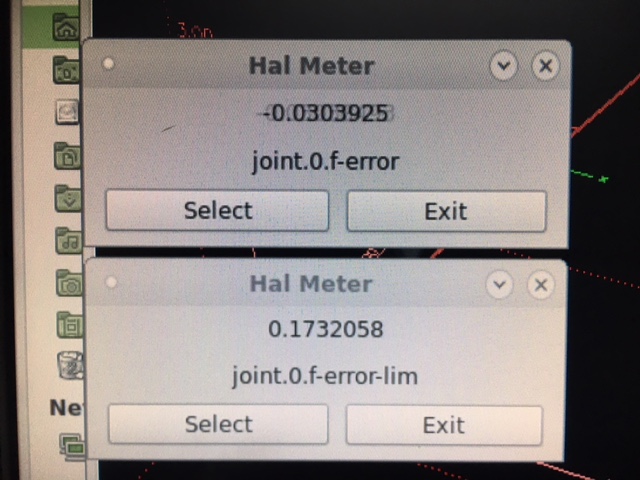

Can anyone tell me where to find the floating output pin that displays following errors?

There are several, in Master there is, joint.N.f−error, and pid.N.error. (these two may not always agree, it depends on when in the servo thread they are sampled and calculated)

Thank you. What is the math used for the following error units? I'm running a diagnostic program to tune analog drives. I'm getting .030" reading at 150 IPM from all 3 drives. Obviously that's not accurate if it's in machine units...

Following error is in machine units

You can compare to the joint.N.f-err-lim HAL pin to check whether the error is in machine units or LinuxCNC internal units.
Note that 0.030" error does not _necessarily_ mean that the tool is that for off the programmed path. It might be exactly on the path and 0.030" "late"

Late as in the floating pin isn't keeping up with the servo thread?

No, in that the tool is on the path, but not as far along the path as the programmed point.

After stiffening up the drives considerably, i was able to get the following errors down to .0035" from .030" at 150 IPM. Problem is i was getting random oscillation when tuned that aggressively. I have Fadal 5000 line/20,000 count AC drives with 3 adjustment pots; balance, signal gain, and compensation. So it has PI of the PID, and balance. Would you recommend leaving all software PID values at 0 and only adjusting on the drives?

f-error-lim is a linear interpolation between MIN_FERROR and MAX_FERROR from the INI between zero velocity and MAX_VELOCITY.
