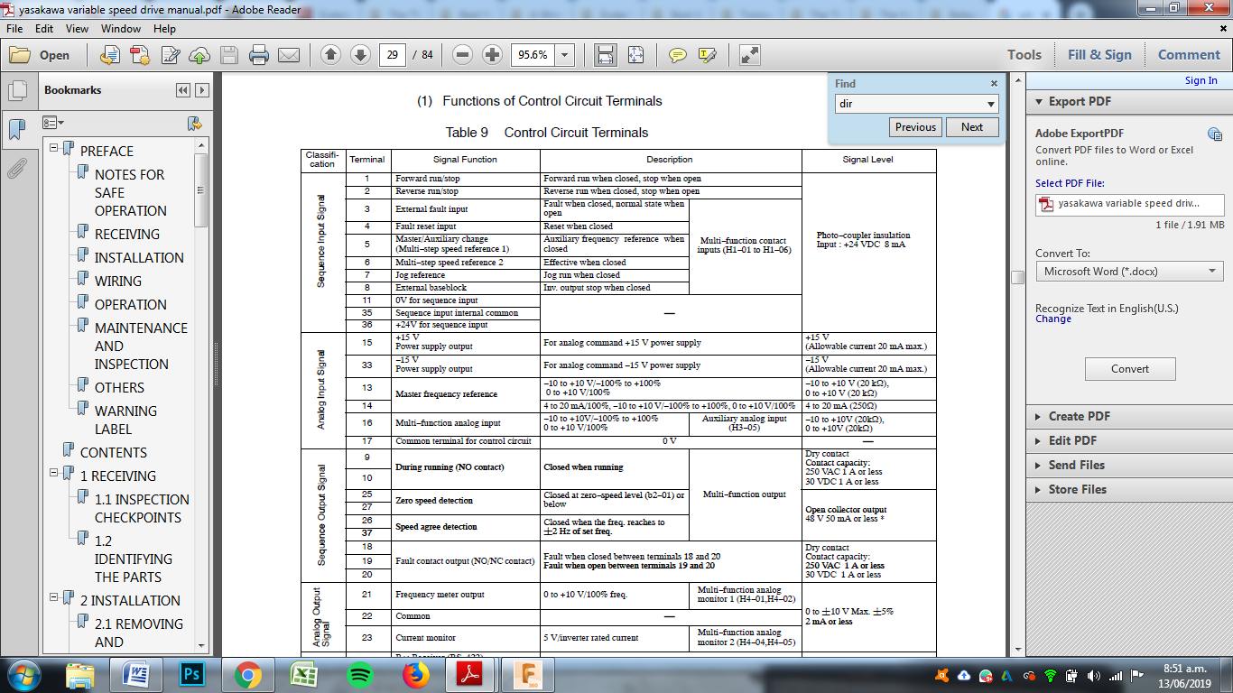

I think I was a bit misleading with my question. I have a yaskawa vfd. It takes +-10 volts analog to control it.
I only took the brake resistor from the heidenhain vfd. I am not using a heidenhain vfd.
I don't care what control voltage I use but this is a full scale VMC and I need rigid tapping and spindle orientation for the toolchanger. Can I do this with only 0 to +10 volts?

Just a quick add on here. I assume as I want to rigid tap that I need reverse working well? Unless I can toggle a reverse input on the vdf. Is that possible?
- Thank you received: 4652
12 Jun 2019 12:05 #136714
Yes, the 7i76 has 0-10V, ON and DIR outputs.
So if the VFD can reverse on the logical switch value everything is OK.
If not then some workaround would have to be found.
Replied by andypugh on topic question when using chinese servo drives with original motors

12 Jun 2019 20:54 #136788
by Becksvill
Replied by Becksvill on topic question when using chinese servo drives with original motors
Ok Here is a screen shot of the vdf manual.
It look like I have a direction input.
So I will be all good.
