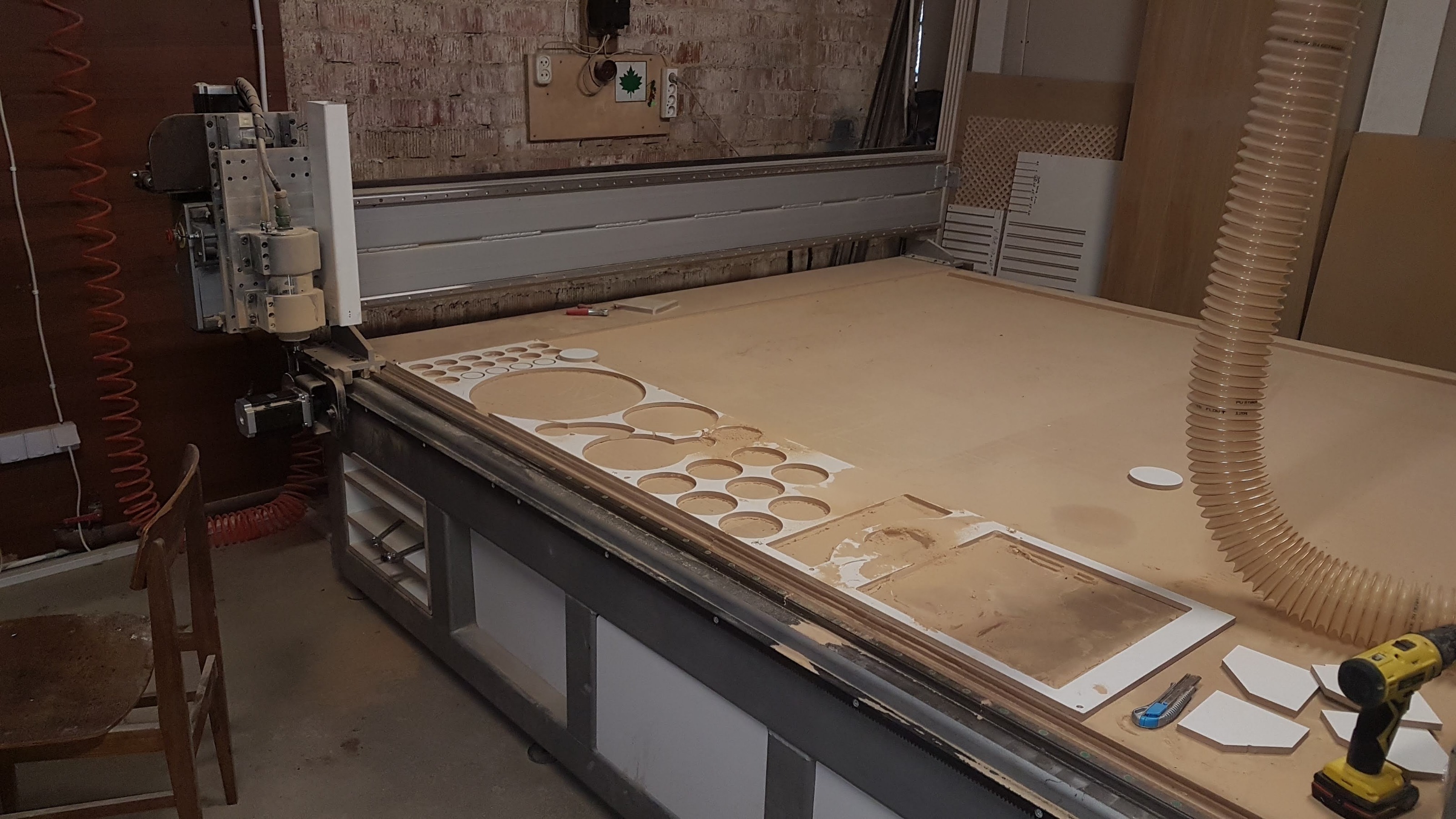

I've been building a CNC machine for a while. And of course I've been struggling from time to time, because lack of knowledge, but thanks to this forum and many many topics, that saved a lot of time and nerve.
First of all, I would like to tell you about what problems I've been facing in the past.
At first there was some inaccuracies in distance due to poor quality rack and pinion system.

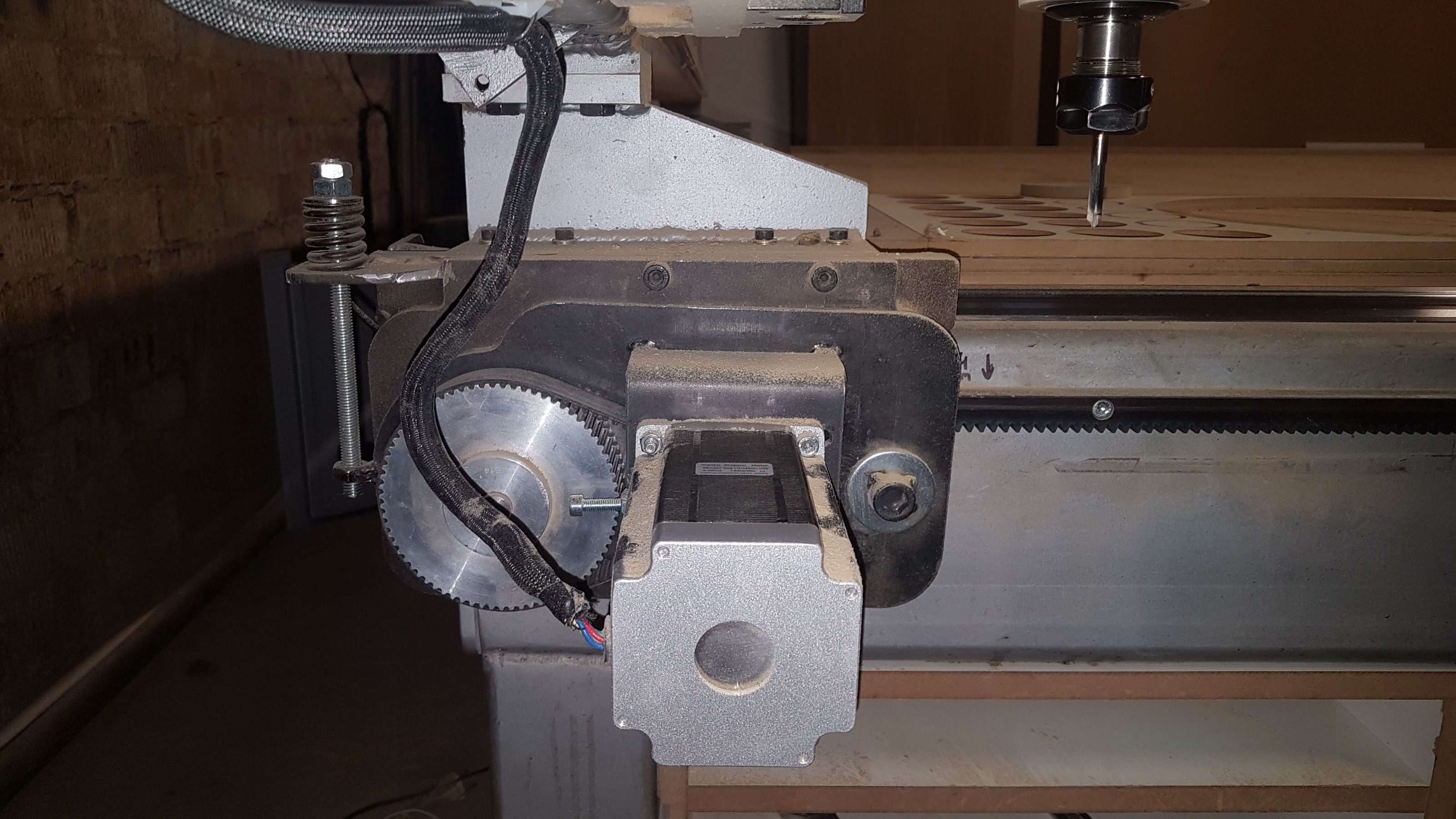

Then there was a lot of noise and movement with vibration due to stepper motor and pinion. Pinion was mounted straight on the motor axle. Today we solved this by instaling custom made gear reduction system (1:4 (pinion turns one time, while motor turns 4 time's at the same time). At this moment machine works really silent and has power that meets our needs. Speed is a little bit to slow, but that is okey, because machine works only at full speed when it is'nt cutting (160mm/s). Also we upgraded rack and pinion from M1.5 to M2.0.

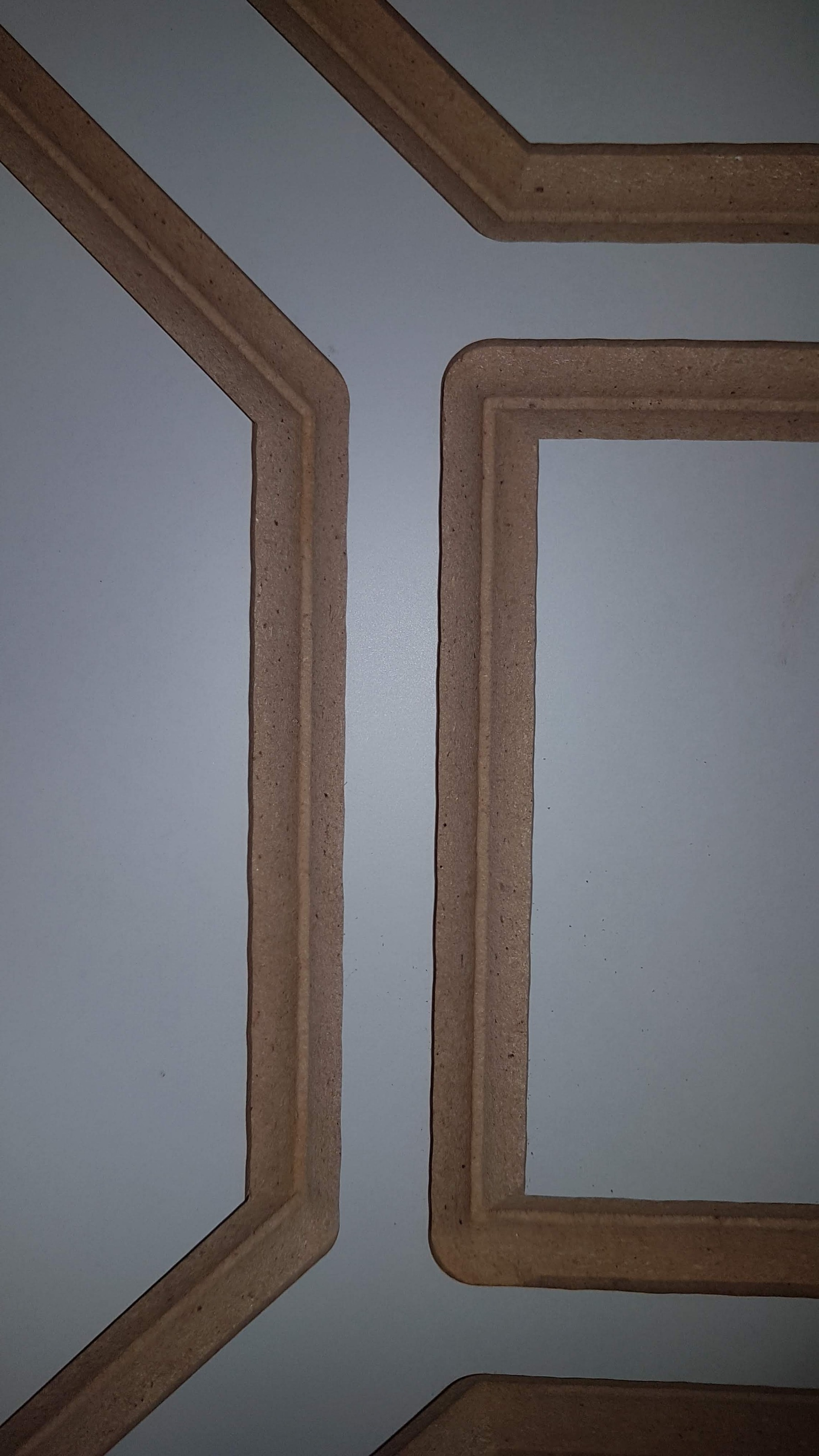

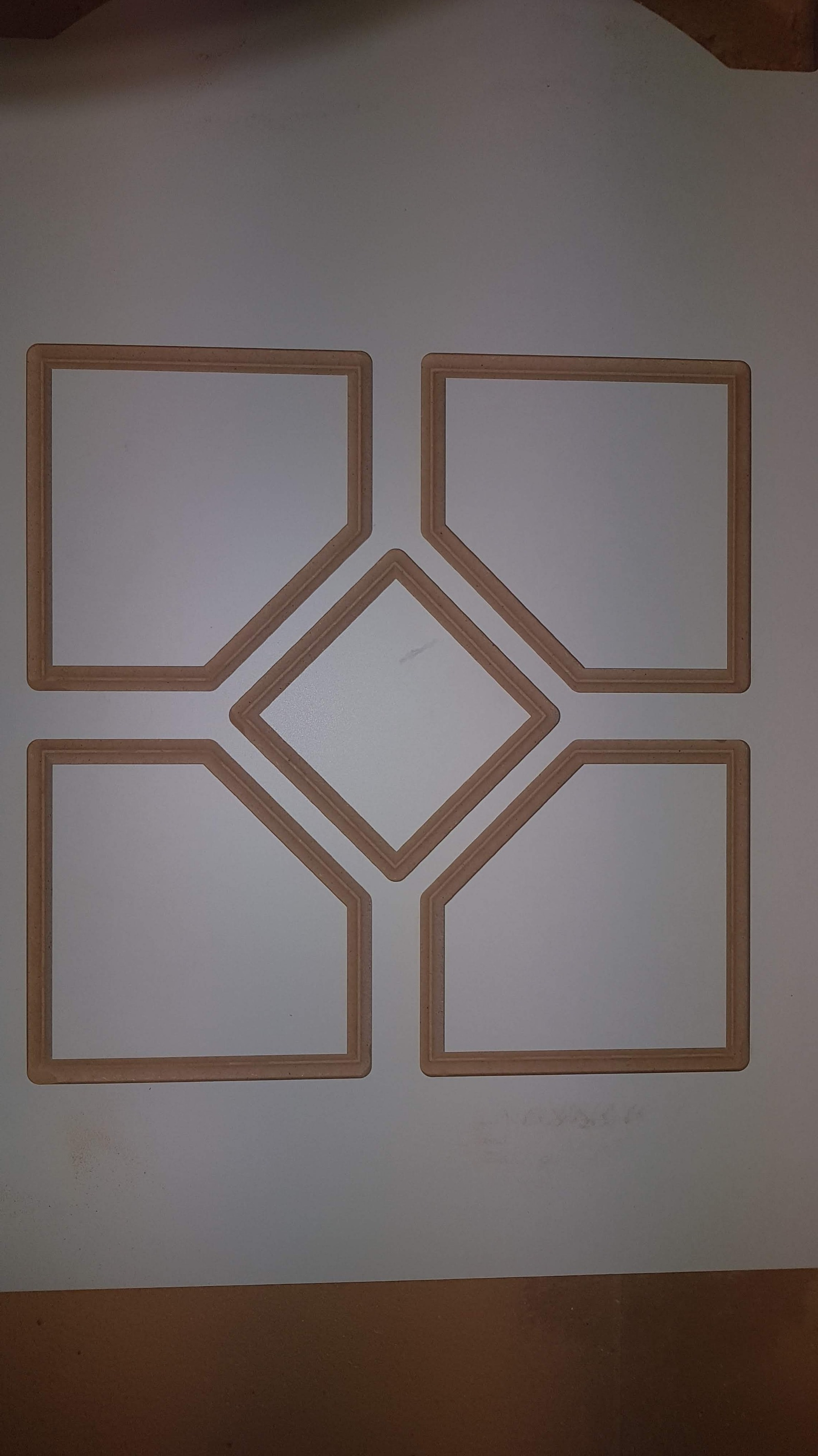

But now we are facing kind of "new" problem. We thought that until we matched parts that were cut before machine upgrade and pieces that we are cutting now. So the problem is that when only one axis is moving there are no problems, the cut is flawless. But when I want to cut part that needs two axis movement, when the cut gets some kind wavy no matter at what speed I'm cutting that purt (5-50mm/s). Old parts wavy cut kind of matches the new parts wavy cut. And now I don't know what to do.

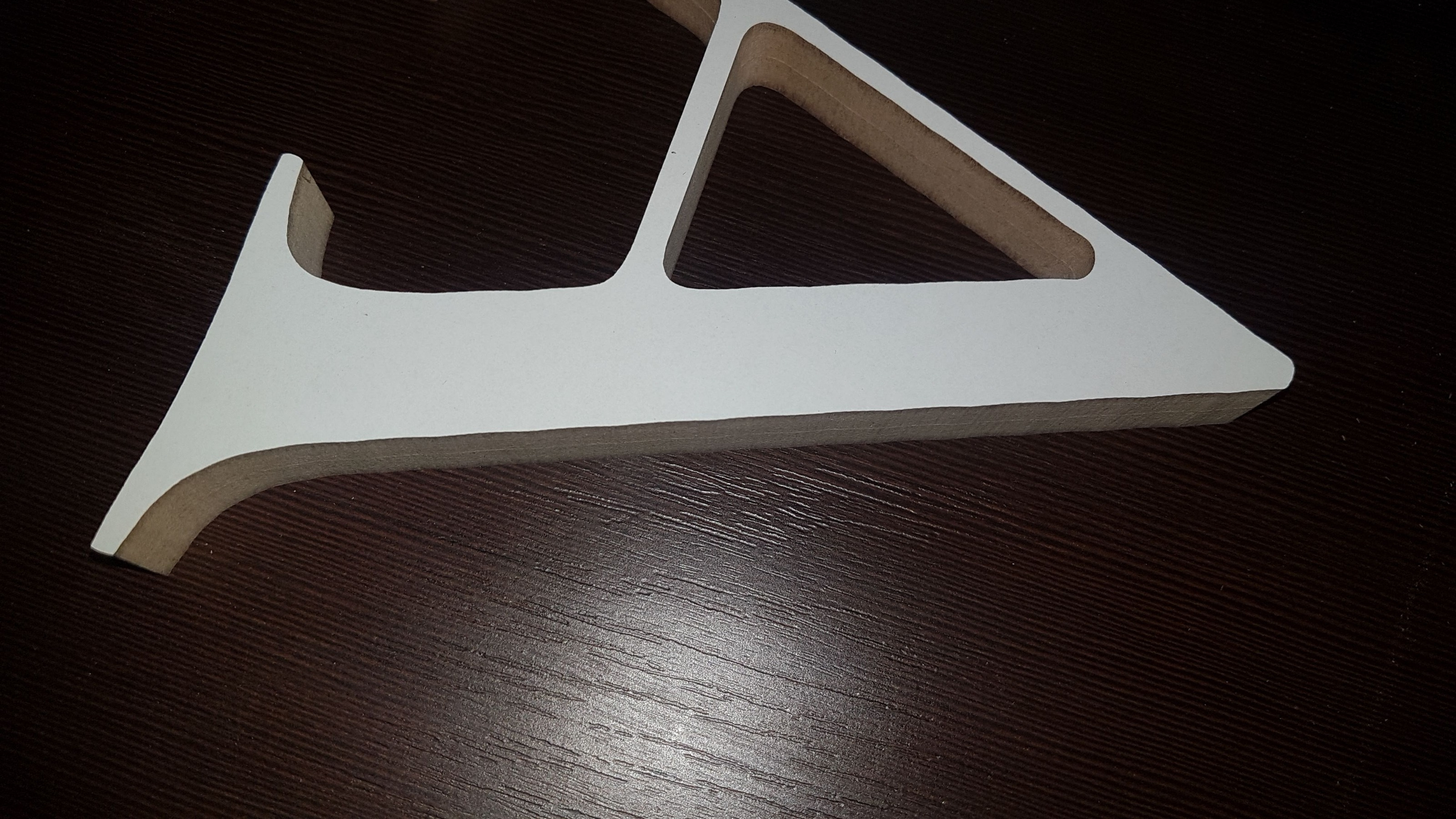

Forgot to mention one thing. Let's say, that I put MDF 18mm material and I cut it part in to steps, first I cut it in 9mm depth and then all the way to the bottom. After the part is cut, both waves are idealy the same and they match perfect on the same part, as seen in a photo with the letter "A".

13 Mar 2019 15:13 #128524 by PCW
Does the pitch of the wobble match either pulley or belt?
a non concentric pulley or stretched belt might do this

13 Mar 2019 18:06 #128536 by Todd Zuercher
Is one or both axis rack and pinion? If so a pinion gear that isn't properly meshing with the rack can give those results.

14 Mar 2019 10:23 #128569 by Python
Yes, Todd, both axis are rack and pinion. I'll check meshing as soon as possible.
PCW, in my opinion and observation there is no wobble in gearing. The belt isn't tightened to much. IMHO.
