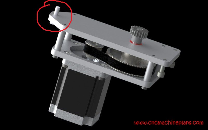

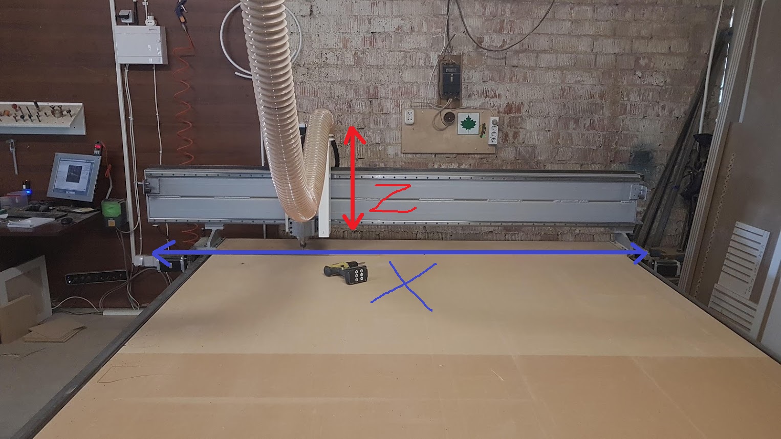

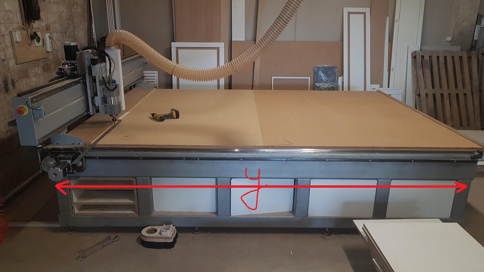

To rodw: Coupling is only mounted to Z axis plate. And it's not helical cut. X and Y axies are designed as shown in the picture below:

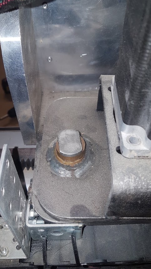

20 Mar 2019 20:11 #129105 by Todd Zuercher
The pinion has to stay perfectly perpendicular to the rack at all times.
With that design my first suspect for alignment problems would be the pivot axle here.
It does not look sufficient for maintaining alignment to me.
