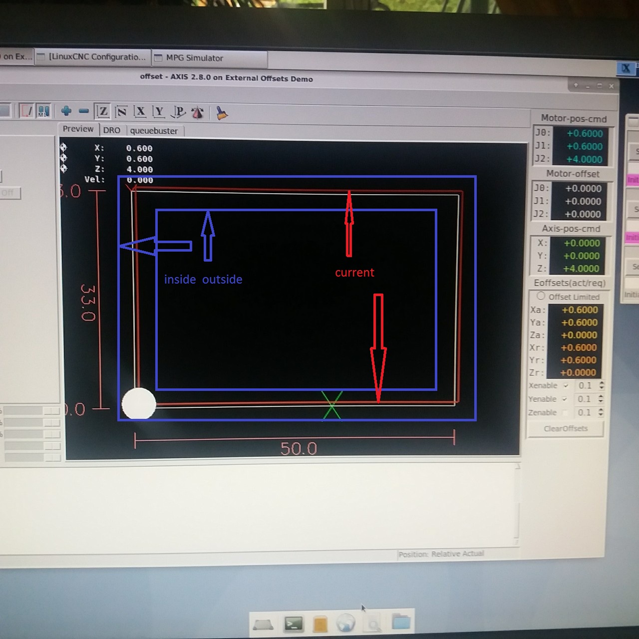

21 Mar 2021 12:54 #203113
by aluplastvz
Replied by aluplastvz on topic what is "external offsets"?
Greeting to all
Could someone help me and is it possible to adjust the offset to move as the blue lines are marked when determined inside or outside.
Now I get two sides well and two opposite whether it is possible to configure this in linuxcnc
Greeting
Thank you
Greeting
Thank you
- Posts: 4819
- Thank you received: 2164
21 Mar 2021 14:16 #203120
Replied by Aciera on topic what is "external offsets"?
Hm, not sure external offsets are the most convenient solution for this. You would need to change the sign of the offset depending on the geometry of the toolpath. Wouldn't this be a simple case of radius compensation?

21 Mar 2021 17:57 #203142
by aluplastvz
Thank you for your prompt response.
The problem here is that the abrasive tool wears out during polishing.
I can monitor the load of the machining motor on a digital panelmeter and correct the offset.
greeting
greeting
- Posts: 4819
21 Mar 2021 18:20 #203143
Ah, I see.
I think you would have to somehow do it in a similar way to how radius compensation works since you have to define which side of the contour the tool travels on. The direction of the tool vector would then be used to calculate if the external offset needs to be positive or negative. I'm somewhat sceptical that this can be done outside of the motion planner though.
But I'm out of my depth here. Maybe somebody else has an idea.

- Thank you received: 4652
21 Mar 2021 23:42 #203174
Replied by andypugh on topic what is "external offsets"?
I think that adjusting the tool diameter is likely to work better than using offsets.
However that would require some sort of handshake between the measurment system and the G-code, as tool diameter is a G-code internal thing.
