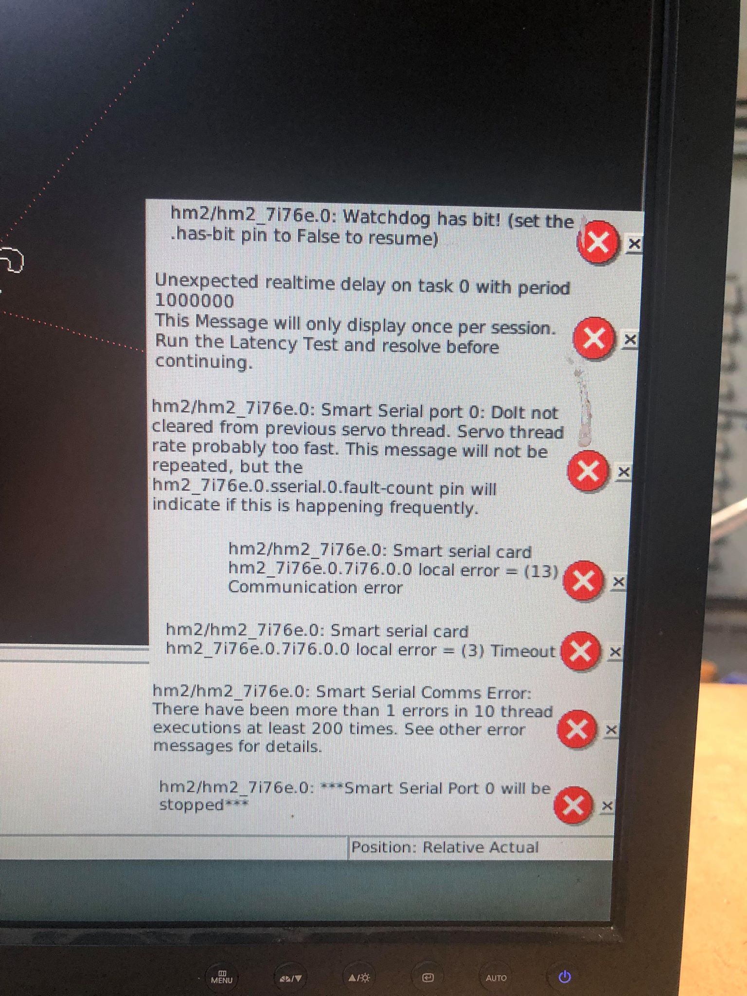

Sorry simple misreading, changed back to 5000 and that fixed the clipping problem.

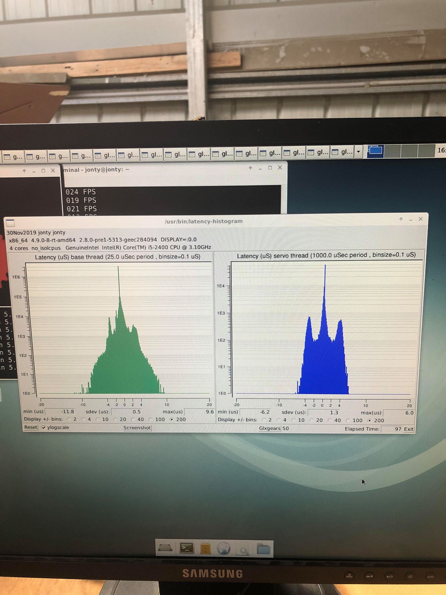

I ran some latency testing with the following results, where do I enter these in my .ini or hal files? Or where do they come into calculation?
note: turned off all BIOS power saving options
also note: these errors dont come up straight away, only after some time. I am able to jog and touchoff the 'X' and 'Y' axis, however not the 'Z' axis for some reason.

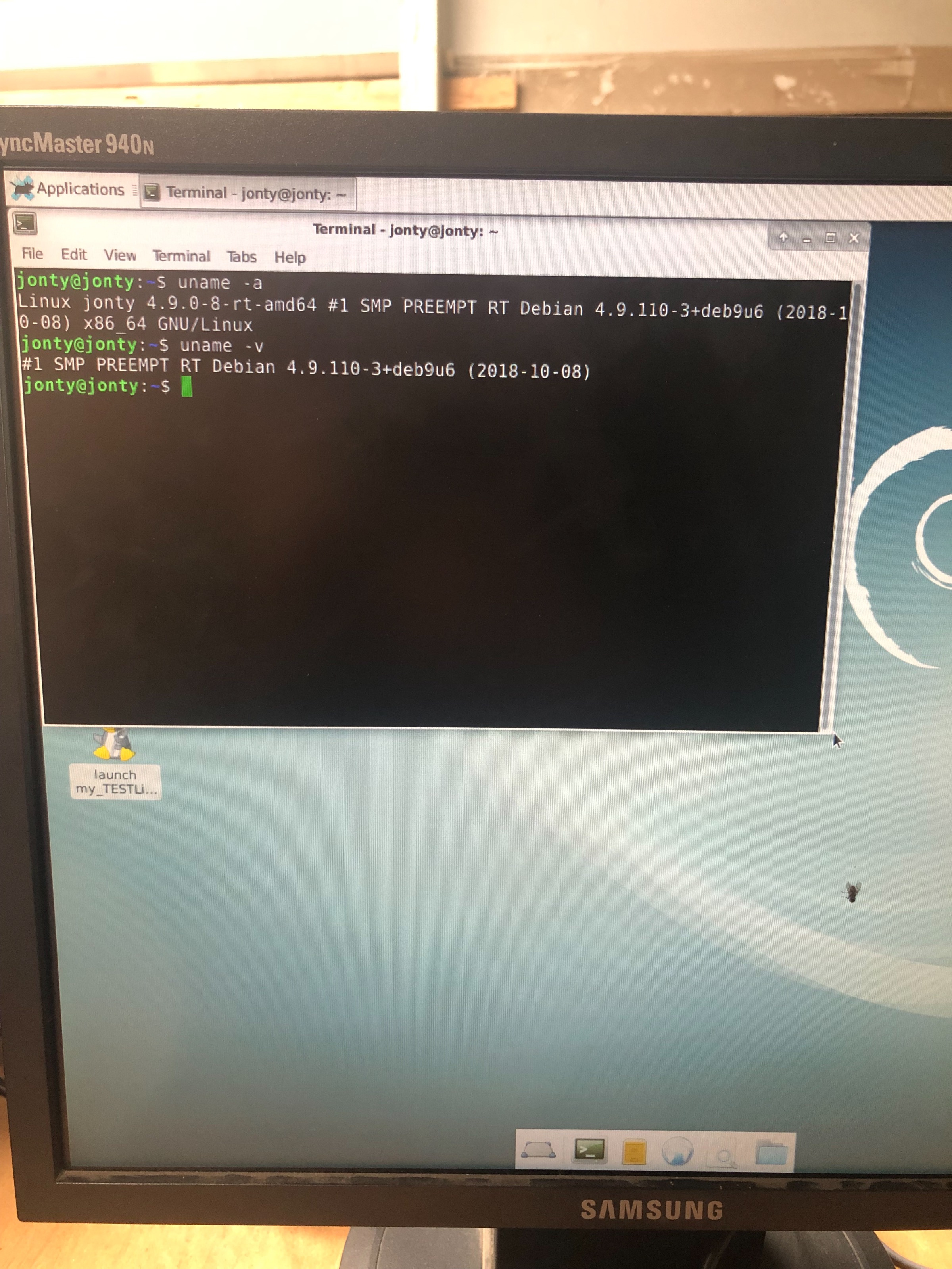

Are you sure?
Because I’ve had that problem before and I bought a whole new computer and uploaded one of the images you linked.
This is what uname -a and uname -v give.
Also I am able to run all of my motors and home switches with dual gantry, so surely this means it’s connected? I’m not too sure though.

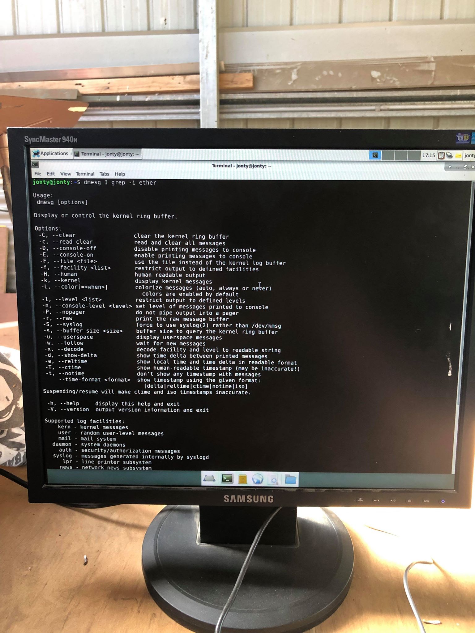

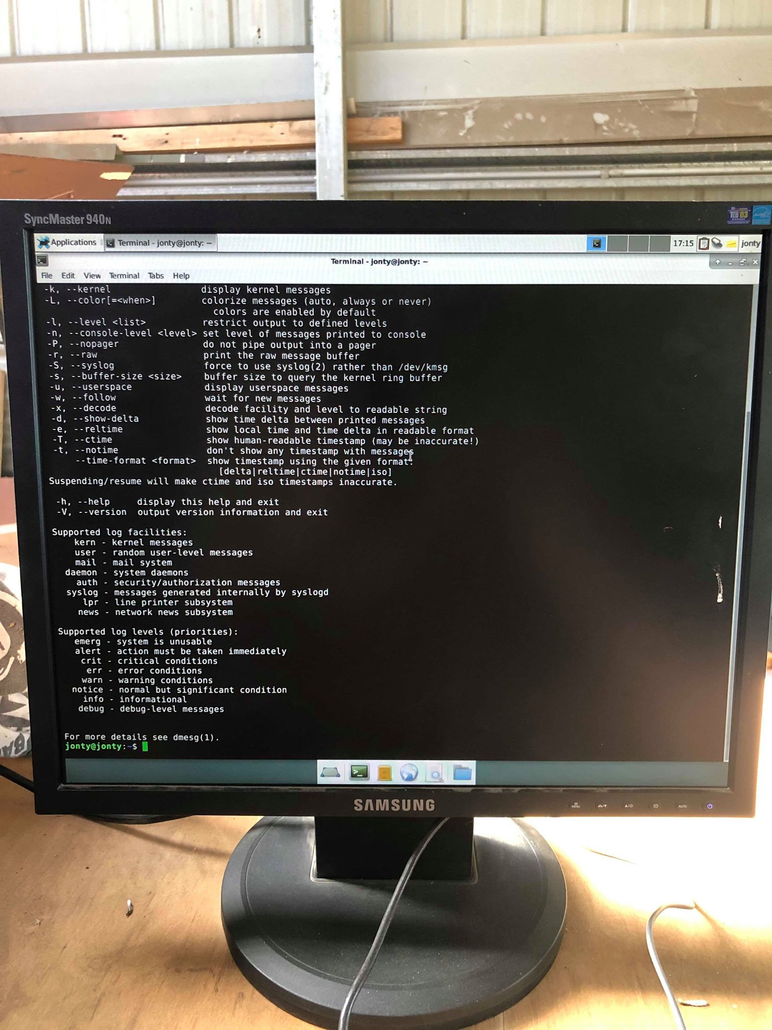

- Posts: 18118
- Thank you received: 5336
30 Nov 2019 16:22 #151614
Replied by PCW on topic Step Sale and Velocity
OK that does look like Preemt-RT
Have you disabled all power management options and C1 states greater than C1 in the BIOS?
Also if you have a Intel Ethernet chip in the host PC (check with dmesg | grep -i ether)
you will need to set a driver mode to get decent real time performance

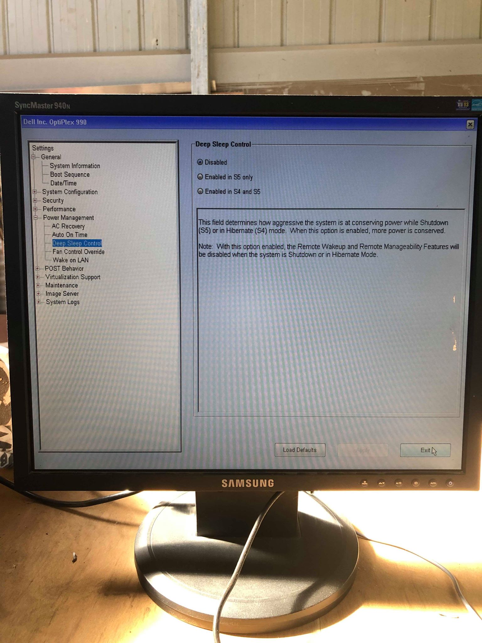

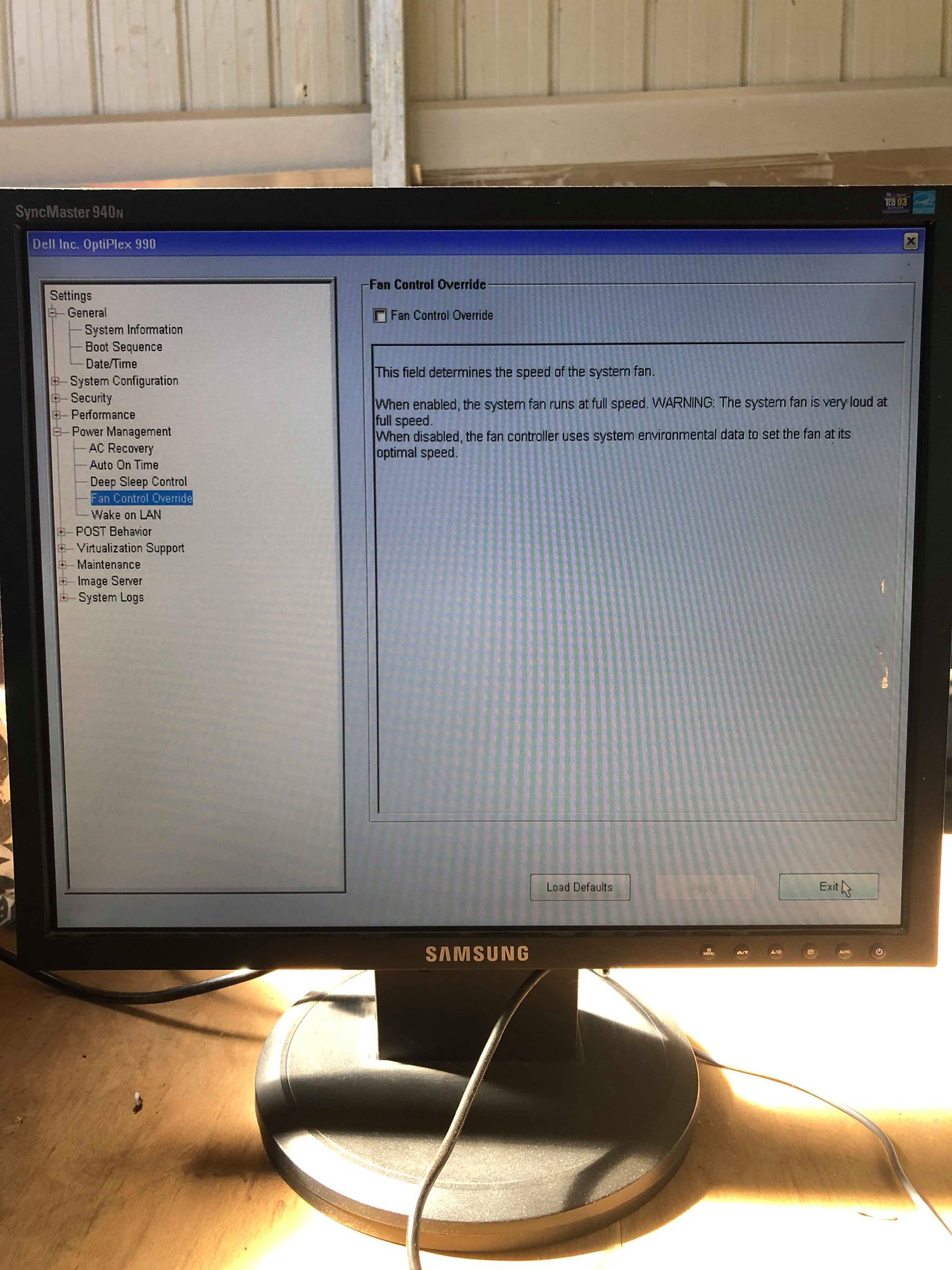

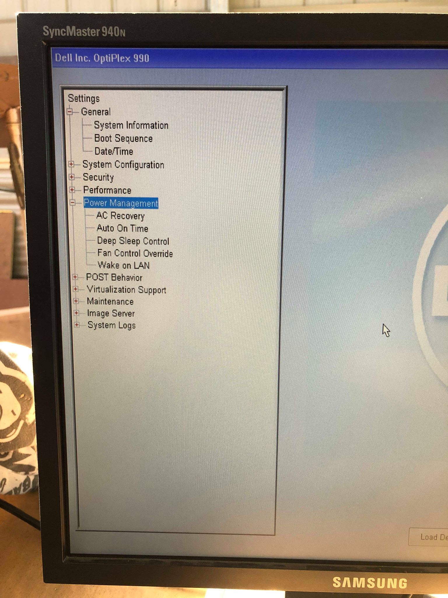

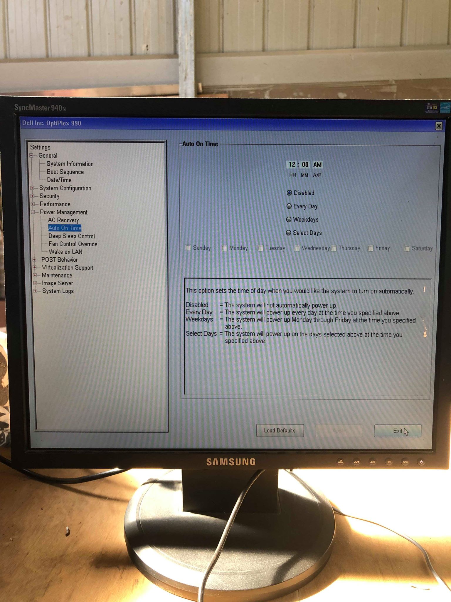

04 Dec 2019 04:43 #151966
by little_sparky
Replied by little_sparky on topic Step Sale and Velocity

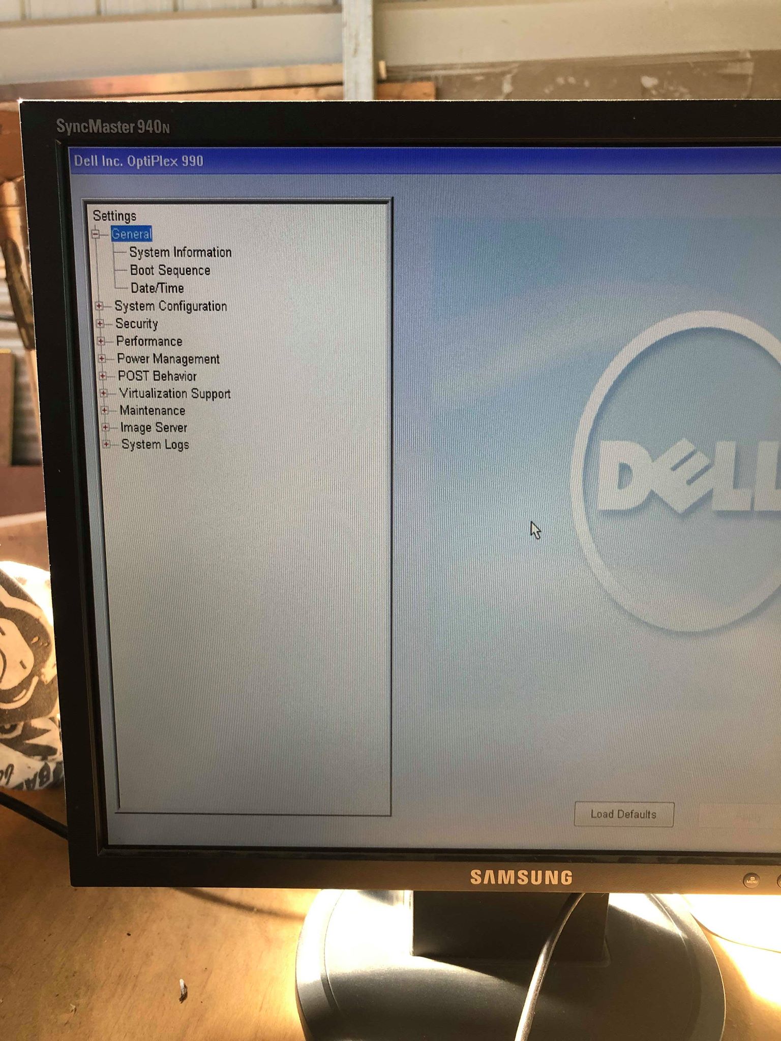

Thanks for your reply PCW, I had a look in my BIOS setup and I dont have any C1 value (that i know of?) however I disabled everything else.
Also I ran the command you said and got the following, no sure what this means? (I have a dell optiplex 990 which is an intel computer however its been refurbished so who knows whats in it, hopefully doesnt mean I have to buy a third computer)

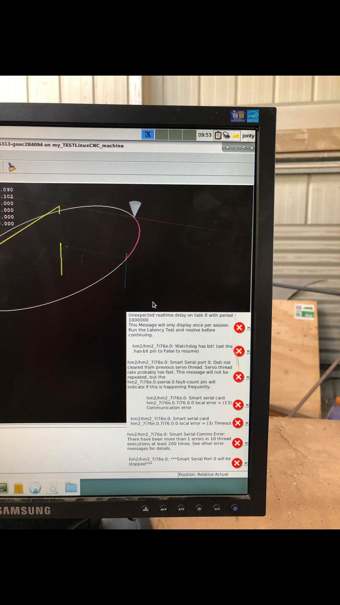

Its also weird that I only get the error after running the axis around for a while or if i enter a few manual g code commands that wont work, eg outside the limits.

04 Dec 2019 04:57 #151969
Replied by tommylight on topic Step Sale and Velocity
That is a Dell enterprise series, you have to disable a lot of stuff in the Performance menu and all the virtualization stuff, plus disable modem and serial, speedstep, turbo, etc.

04 Dec 2019 06:16 - 04 Dec 2019 06:56 #151981
by little_sparky
Tommylight you are my hero!
Disabled all of the above (except I couldn’t find modem and serial) but also disabled kvm, was I meant to do this?
Either way I ran the machine around for about 20 minutes and have not had an error.

Think I spoke too soon. I still get the message, nowhere near as often though. However I would like to completely get rid of it because its bearable when routing but when I go to plasma cutting it will be a nightmare.
Do you think this is all coming because I havnt disabled modem and serial (if i have it? cant seeem to find it) or do I need to enter the numbers from my latency somewhere that im missing?
