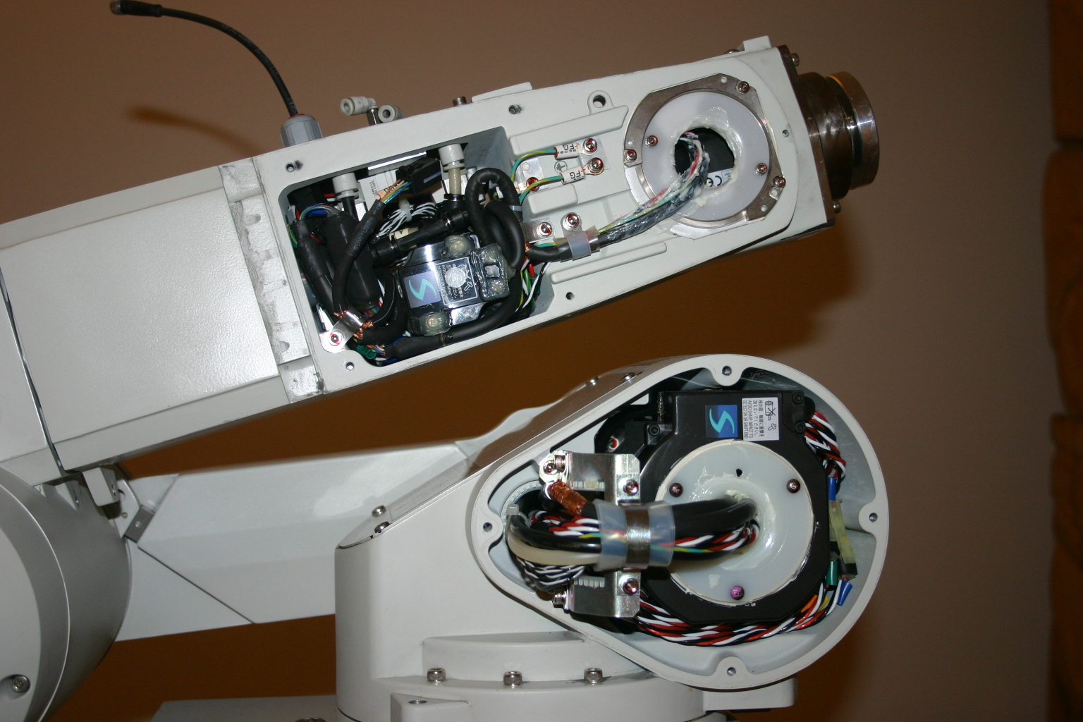

Hi All

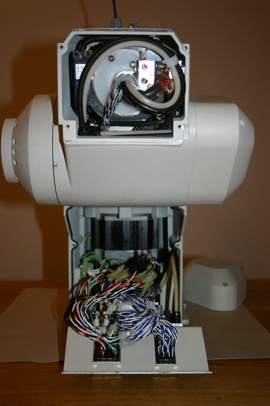

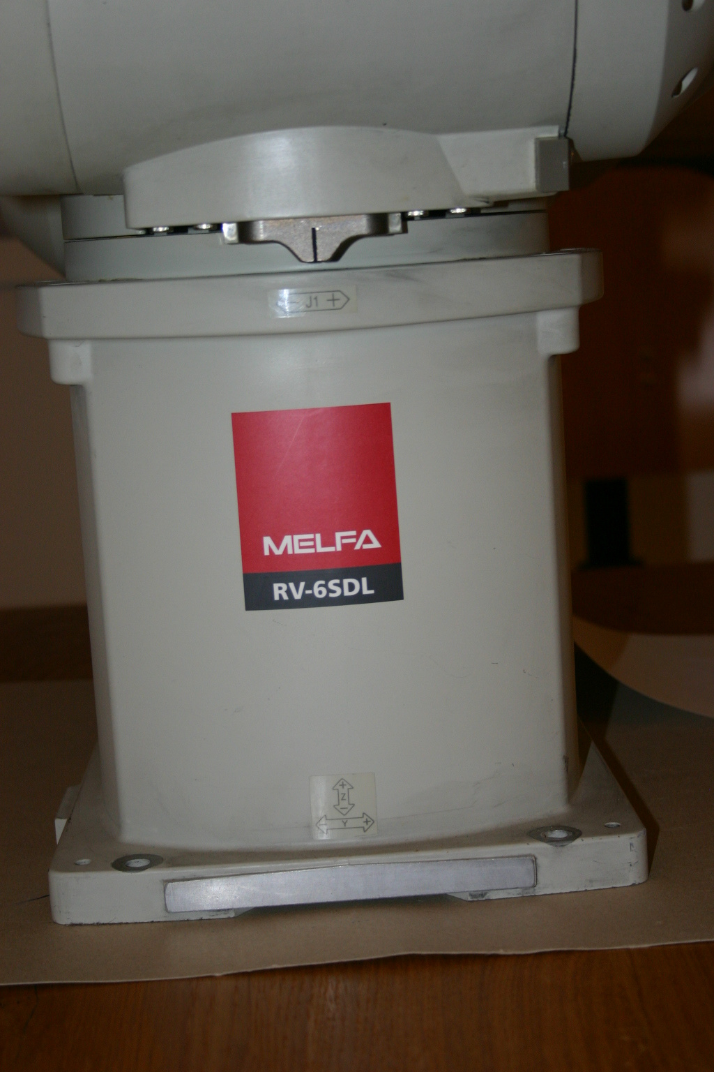

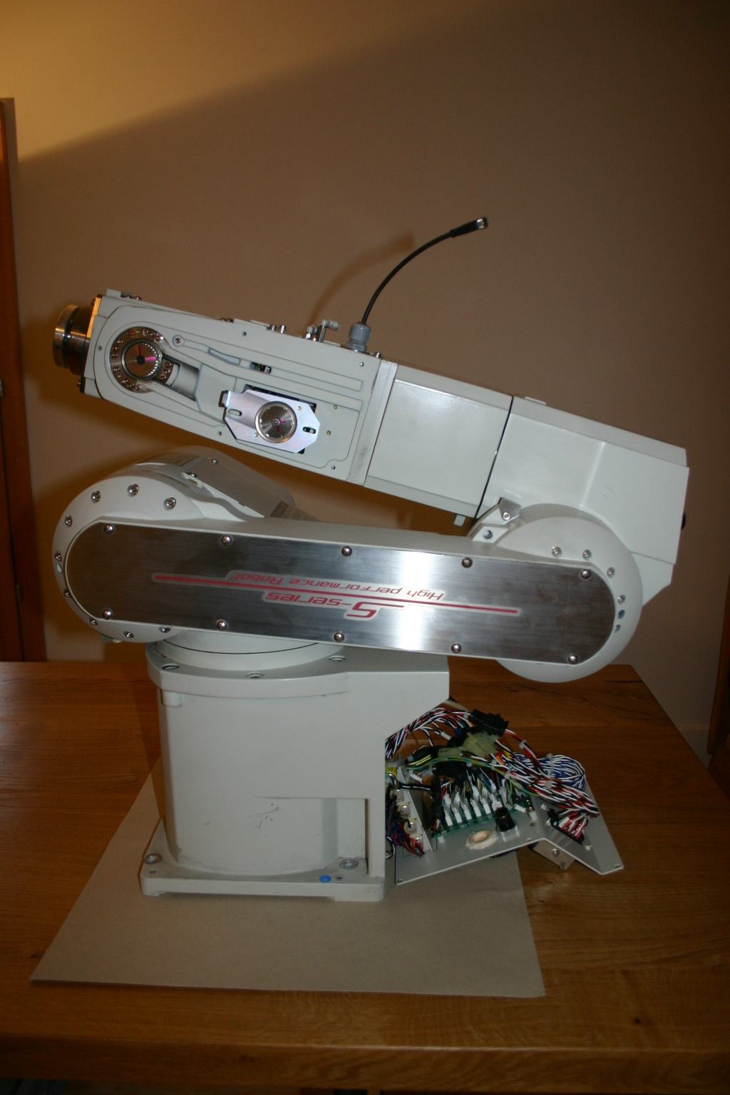

I've got a Mitsubishi RV-6SDL 6-axis Robot arm with a broken controller. I know the arm is functional, but a repair of the controller is not realistic because of missing documentation (service manual).
So now the question is, can it be controlled with linuxCNC?
I think there is a kinematic already built into LinuxCNC for such robot arms with 6 rotary joints. The 3-phase AC Servo motors should not be a problem, neither should the brake. However I am uncertain about the absoulte encoders fitted on the motors.
I managed to read the numbers of two servo motors: Joint 1 HF-SWS93B-S1 3-phase 900W 3000r/min and Joint 5 HC-KFS13BL-S16

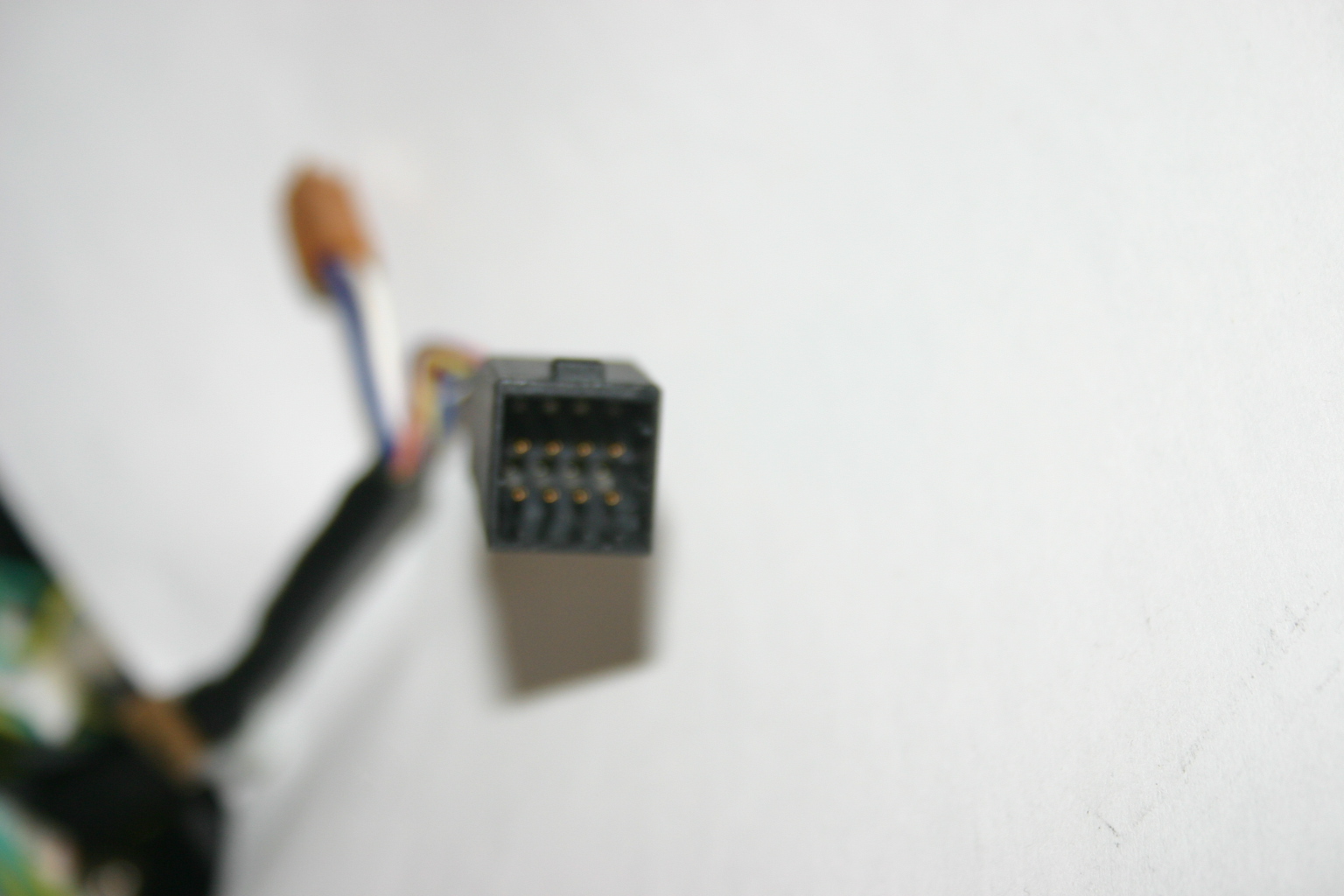

The connector is an AMP D-2100 series 2 x 4 pole (Just wouldn't focus properly)
I believe it is this interface but the connector is different.

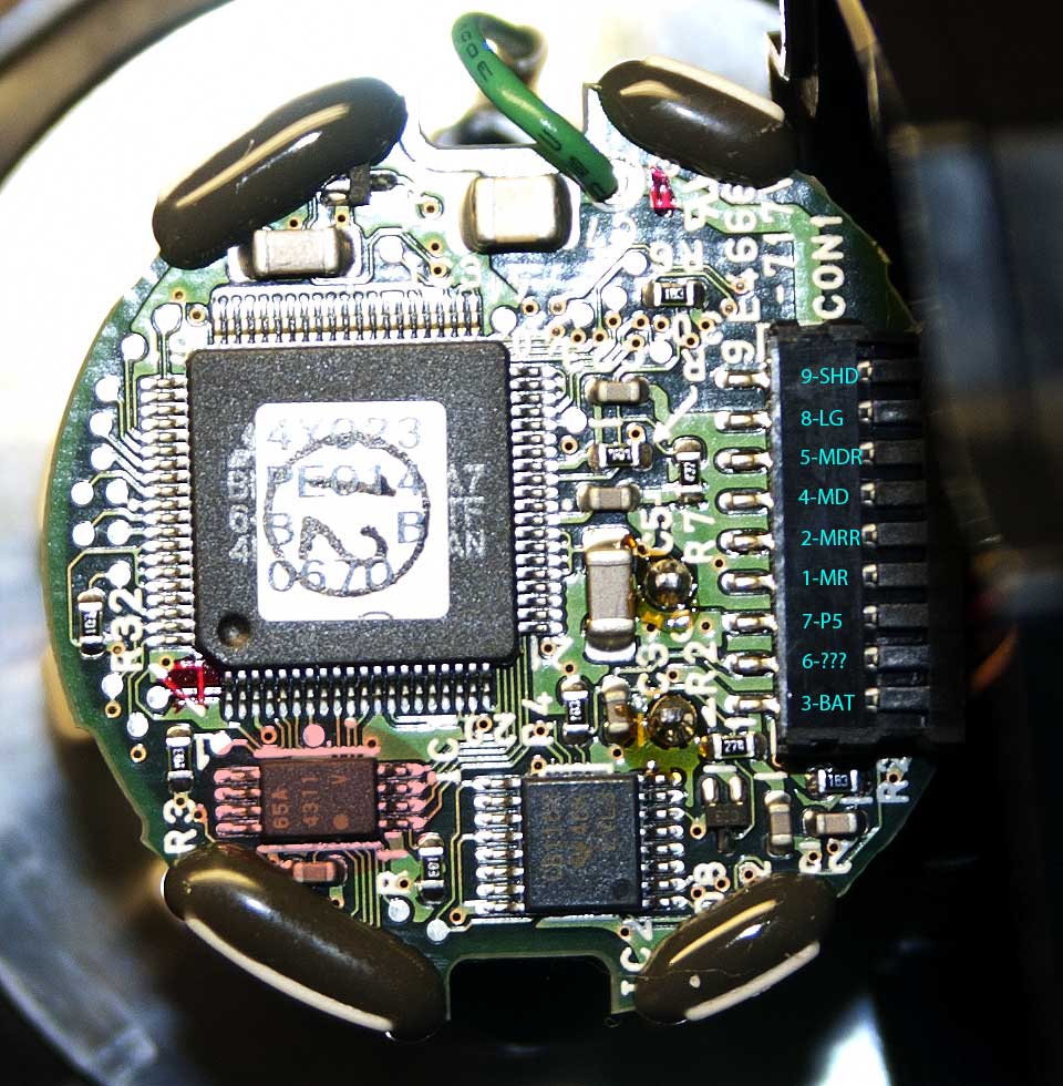

HC-KFS13 motors can be driven by MR-J2S, MR-J3 or MR-J4 mitsubishi servo amps. attached is the OBA17 encoder internal connector pinout.
but the HF-SWS is a problem. afaik, it is not present in any standard drive firmware. though it is possible to get it spinning by a standard drive specifying electrical/mechanical motor constants in drive parameters - it is totally undocumented and i don't know how to correctly derive many of those constants. so probably motor performance will not be great.

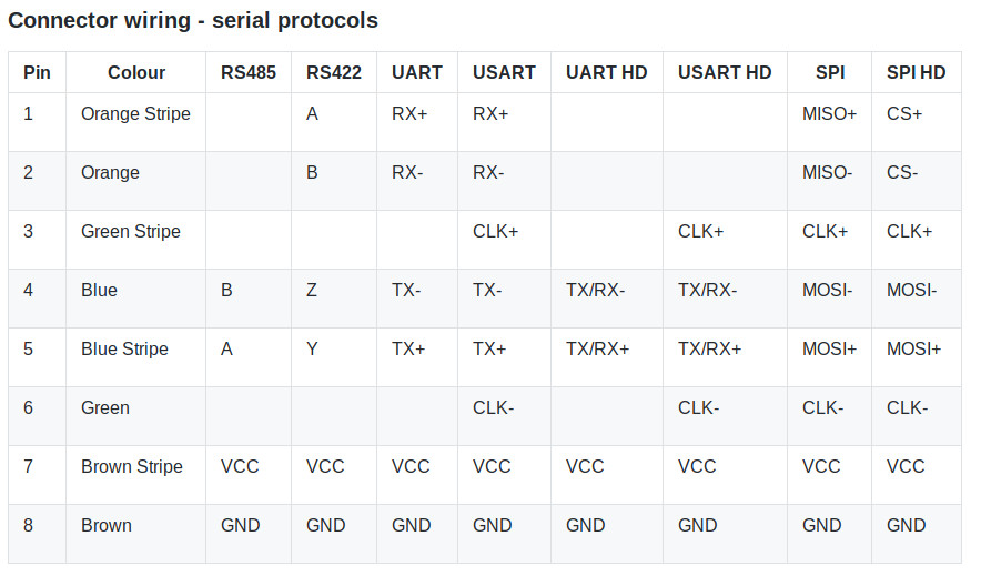

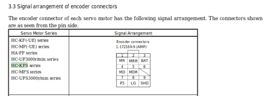

I found this on the stmbl GitHub Page:
Quote:
"Mitsubishi servos such HA-FF usually have OBA17-051 or OBA17-052 encoders.
stmbl has support the "mit 02-4" and "mit 02-2" protocols"
EndQuote
Together with your information it seems quite possible that I could be able to control this robot with LinuxCNC. So I guess it might be worth while to hang on to this thing a bit longer and try a stmbl drive.

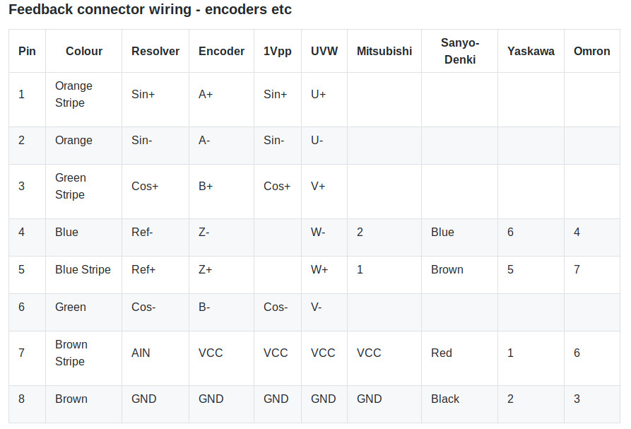

So this is something else I found on the stmbl page:
For Mitsubishi encoders it lists connections 1, 2, VCC, GND.
I wonder how this translates to my encoders.
Then again it might actually use one of the serial interfaces:
Does anybody know how these Mitsubishi serial encoders interface with the stmbl servo drive?
- dm17ry
- Posts: 212
- Thank you received: 91
02 Jan 2020 10:13 #153781
by dm17ry
Replied by dm17ry on topic Mitsubishi RV-6SDL Robot arm Servo/Encoder usability
pin 4 - MRR
pin 5 - MR
pin 7 - P5
pin 8 - LG
pin 5 - MR
pin 7 - P5
pin 8 - LG
